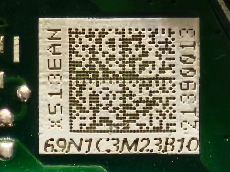

          Re: x513ea r5.3
          laptop turns on, but no picture on the screen. Bios dump and motherboard QR code attached. Help please
          Filip
          • hardware1
            • Sep 2021
            • 2949
            • N/A
            Re: x513ea r5.3
            Filip
            Here's your New BIOS, try it and give me the results.

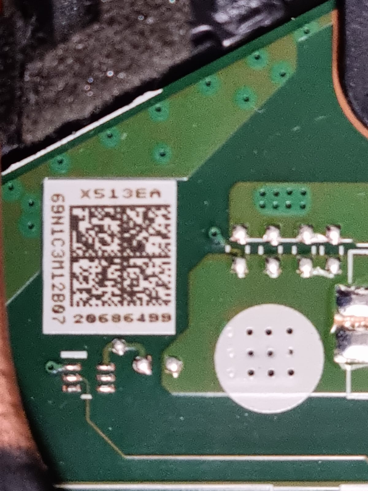

                Re: x513ea r5.3
                Hi, can anyone check my bios or clean it
                motherboard x513ea r 5.4, at the begining laptop starts without picture on the screen, Ive tried with hdmi cable and laptop work, but since I went to bios it suddenly went off and now its taking power but doesnt work at all My old bios in attachment.
                SN: N2N0CV125291083
                  • 22230
                  Re: x513ea r5.3
                  SN: N2N0CV125291083
                  If you read the whole thread you`ll see that there is a QR code on the motherboard with a model number written on it. @cacla has posted a number of different Asus service F1 bios versions, try one of those if they are the same model as yours
                  • pcrepai
                    • Jul 2021
                    • 46
                    • Nederland
                    #29
                    Re: x513ea r5.3
                    Hi, I did read the whole post, but I couldnt localise qr code, Ive found it now, so Ill try to test those bios posted by@cacla, I have only one question, can I program those dump if my version of board is R5.4 and I see here 5.3 or it doesnt matter.. to be honest I want to know it for the future.
                    Sorry for my mistakes !!
                      • 22230
                      #30
                      Re: x513ea r5.3
                      The X513EAN Asus F1 service bios is at post #20
                      Older asus boards have a white or green barcode sticker -> https://www.badcaps.net/forum/showthread.php?t=96604 The bios version that the board should be flashed with is on the sticker, regardless of the board revision.
                      Newer Asus boards will have either a QR code,with or without a model number,or no QR code at all.If the model is on the QR code,thats the bios version that should be flashed.For boards with no QR get the bios update from the support site by the laptop model number.

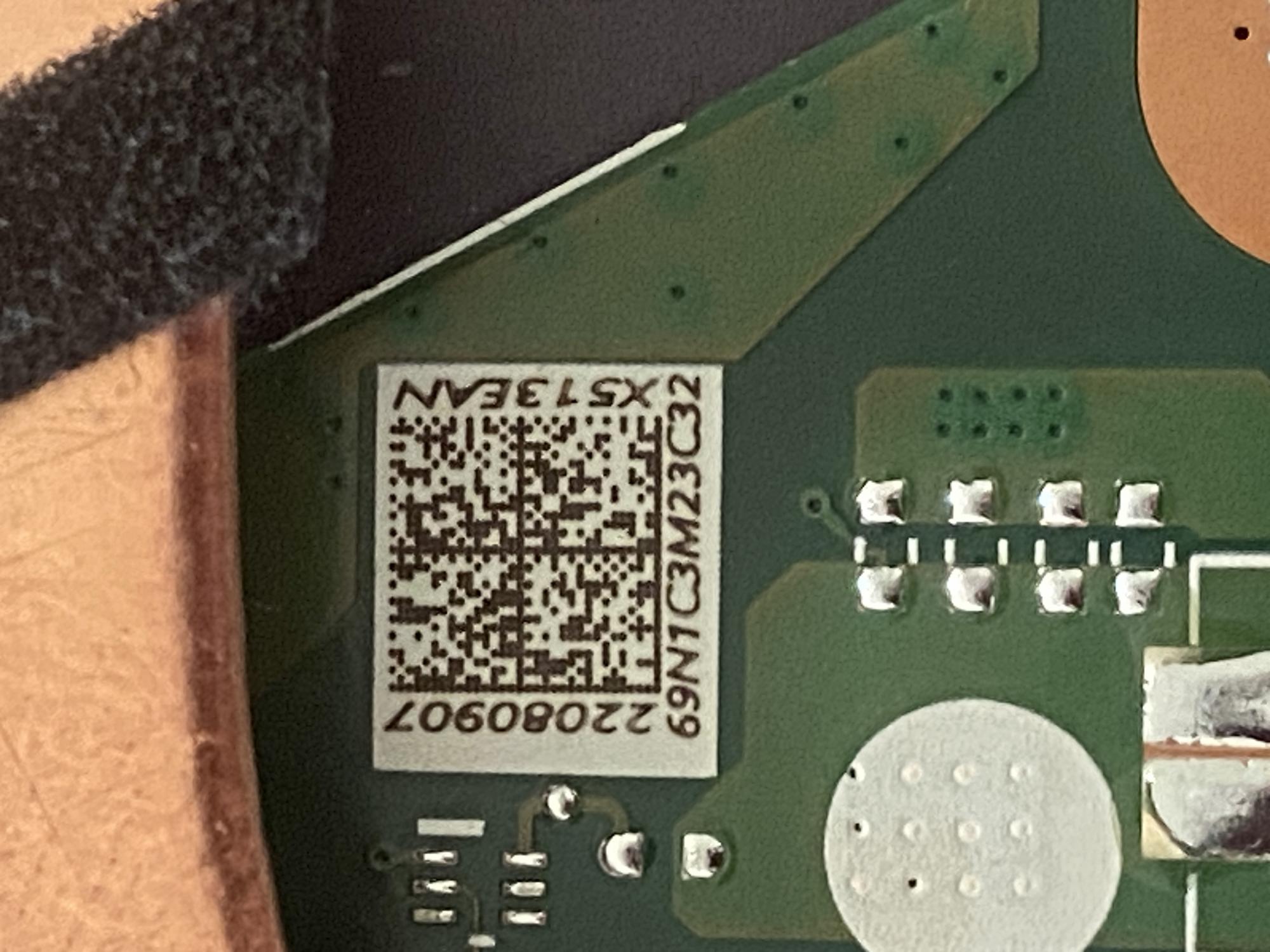

                          Re: x513ea r5.3
                          Hello.
                          Could you please help fix? No video
                          • hardware1
                            • Sep 2021
                            • 2949
                            • N/A
                            #33
                            Re: x513ea r5.3
                            Originally posted by javieromex
                            Hello.
                            Here's your New BIOS, try it and let me know.
                            Serial Number: M1N0CV21J84804B.
                            all donations are welcome,

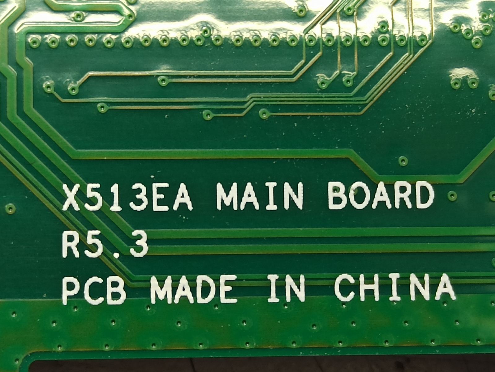

                                  #36
                                  Re: x513ea r5.3
                                  Hello!
                                  Can you help me? Asus X513ea r5.3
                                  No image on the internal screen, only on the external via hdmi.
                                  It's my old bios and QR code.
                                  • Vesko356
                                    VIP Moderator
                                    • Aug 2018
                                    • 4386
                                    • Bulgaria 🇧🇬
                                    #37
                                    Re: x513ea r5.3
                                    Originally posted by klokol
                                    Hello!
                                    The bios is not the cause of the problem since you have an image on an external monitor.
