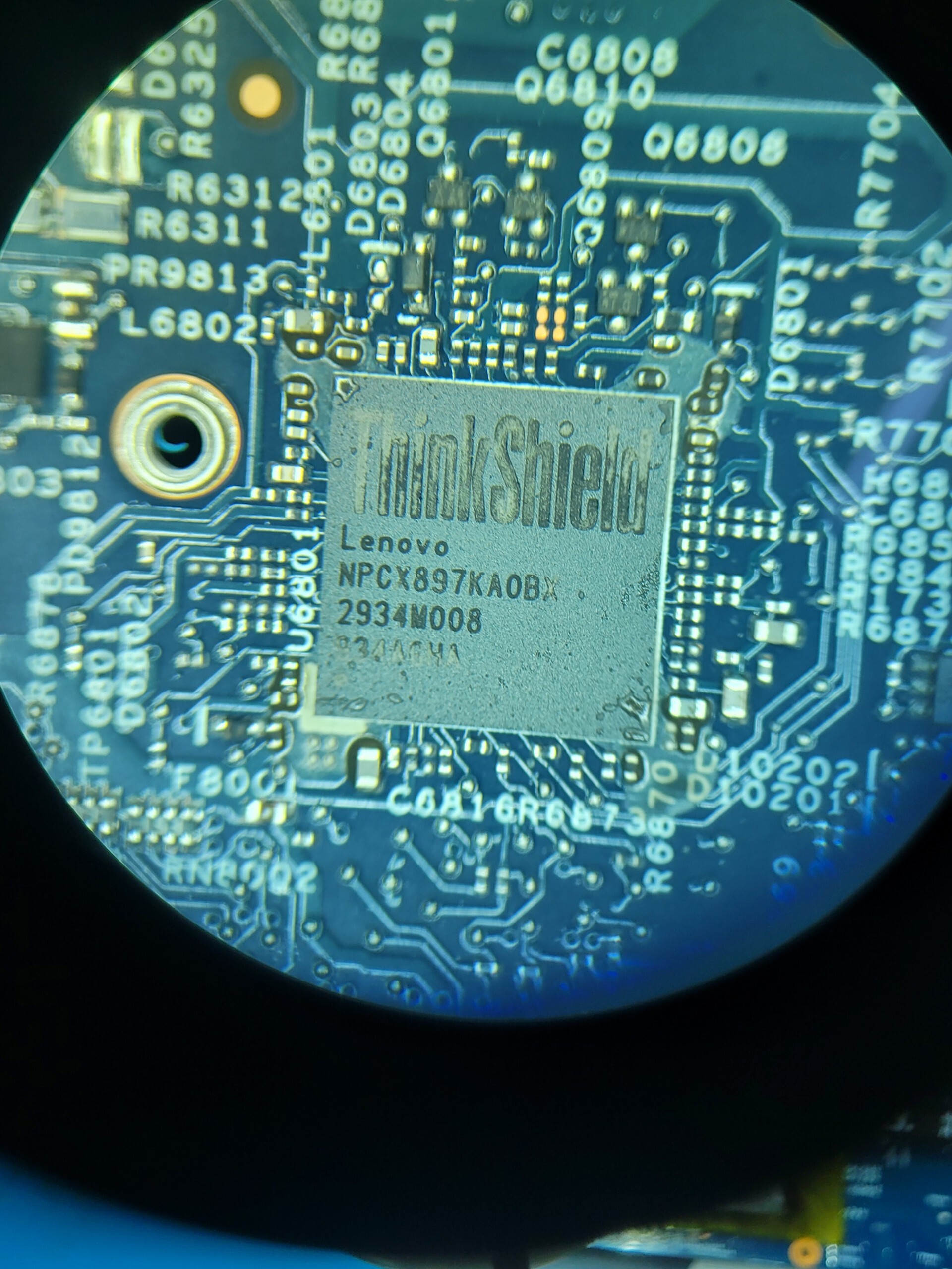

          • 21648
          I think it can only be unlocked through the JTAG1 port.Do you have an EC programmer. Is the EC chip part number NPCX897KA0BX
            1. I have XGecu T48. Does it can read the chip?
            2. It is correct. EC chip is NPCX897KA0BX
            3. What will i do next?
            Thank you very much.

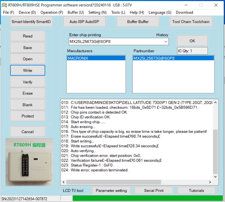

              I used Xgecu T48 to read this bios dump. Sadly I lost the T48 programer. I bought RT809H to write into bios but the software reported an error.
              Can someone guide me to reload this bios dump file?

                  • vuquanghoanh
                    • Feb 2023
                    • 45
                    • US
                    Originally posted by minhdigital
                    what error ??
                    Here you are. Do you know how to get bios dump from bios update?

                      • vuquanghoanh
                        • Feb 2023
                        • 45
                        • US
                        Send to you
                        I loaded the file into the bios but it gave me the error "Write error, operation terminated".
                        Can you check again?
                        Thanks,​
                        • minhdigital
                          • Nov 2022
                          • 764
                          • Vietnam
                          Thanks,​
                          Chip error, try replace new chip and write again
                          • vuquanghoanh
                            • Feb 2023
                            • 45
                            • US
                            Yes, I will buy new one.
