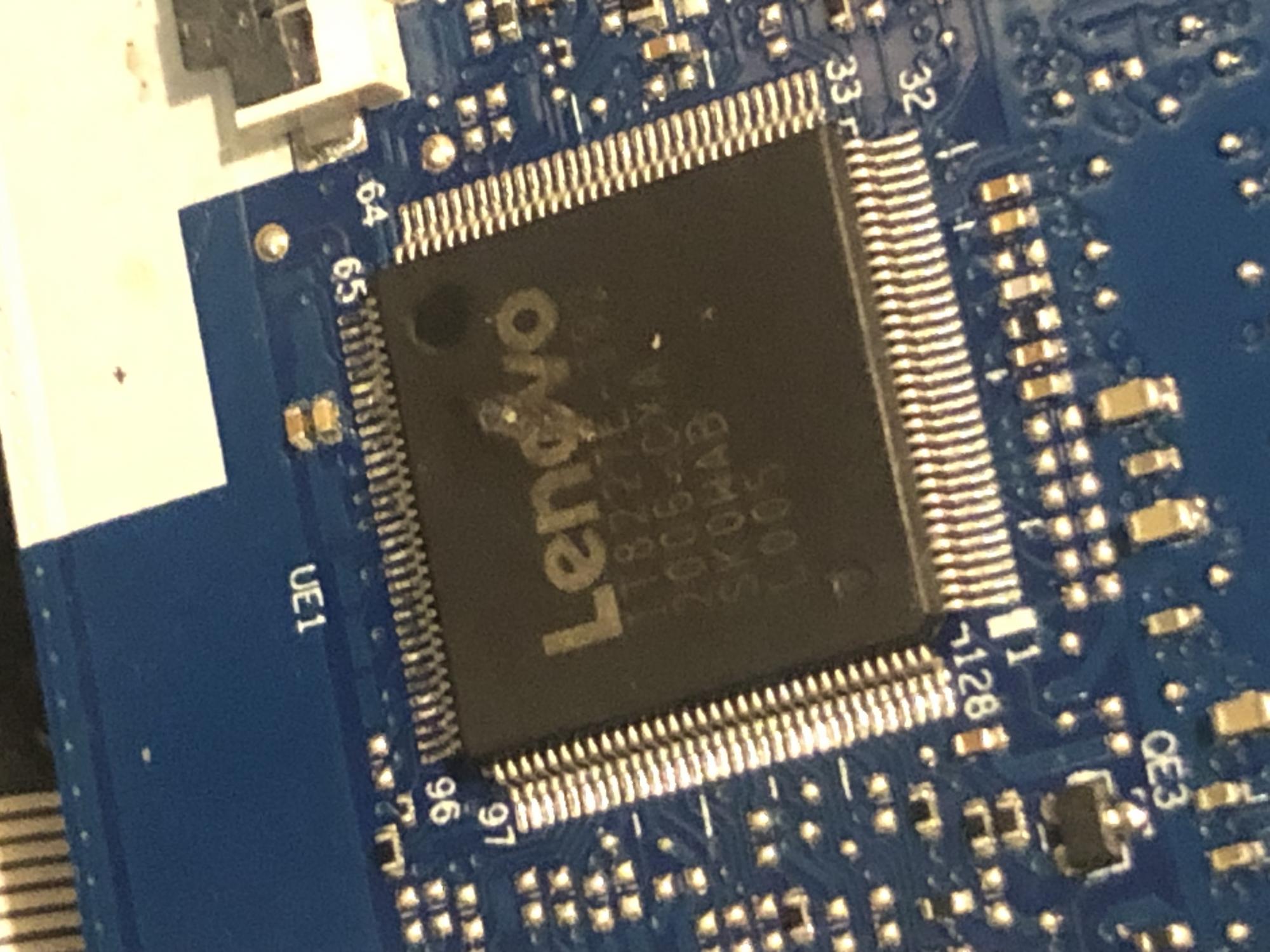

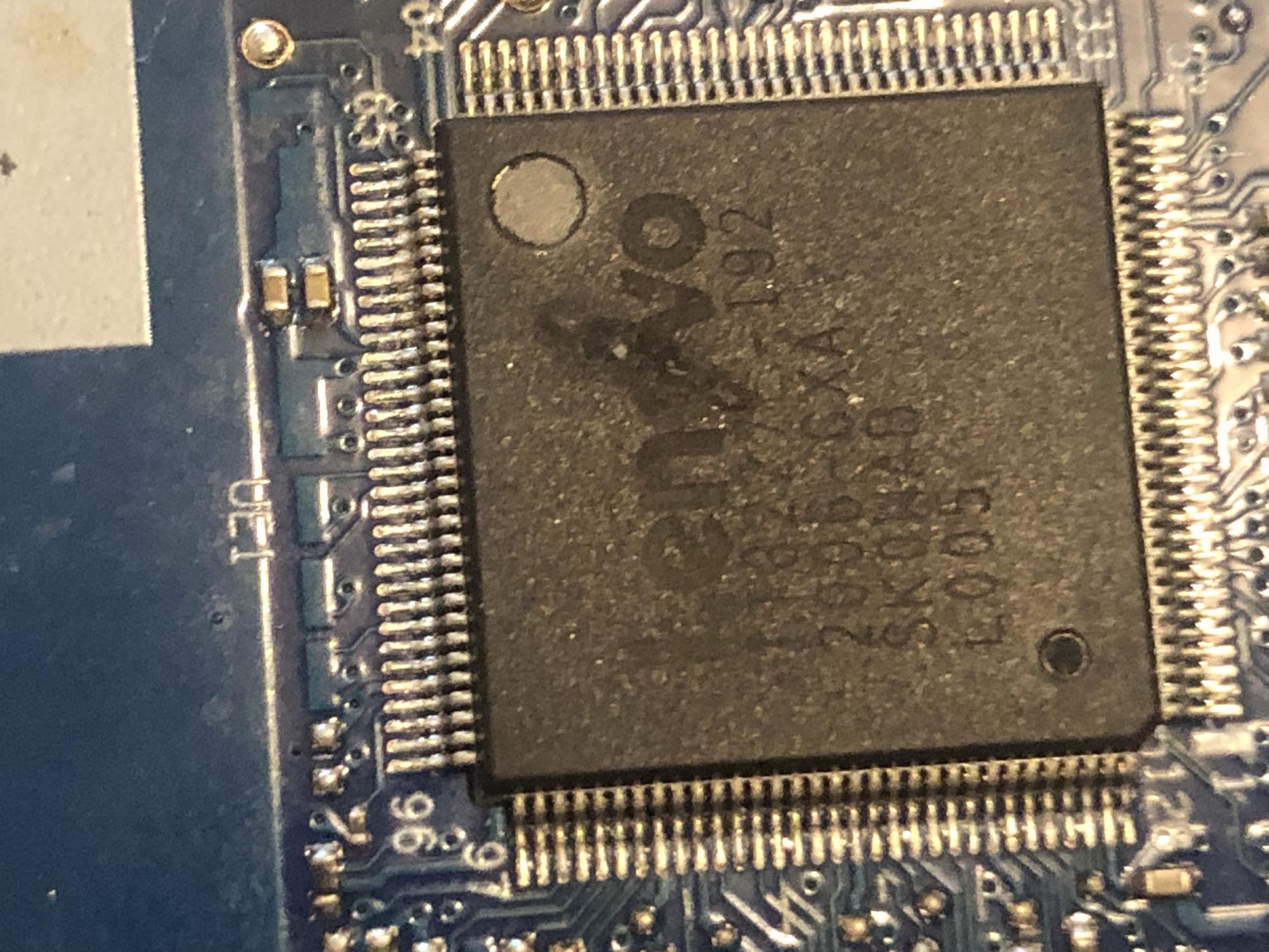

                        Hi!
                        I have the same question. Did it work out?
                        mine is:
                        IT8227E-192
                        2006 CXA
                        SK0WAB
                        L005
                        The closest I could find is
                        IT8227E-192
                        2007 CXA
                        SK0Y8B
                        L005
                        Will it be work??
                        Some solder fell in the casing and it fried the chip before I could do anything
                        • peste
                          • Dec 2016
                          • 13653
                          • ROMANIA
                          Re: Lenovo y540-17IRH IT8226e-192
                          Originally posted by ahmaweed
                          Hi!
                          mine is:
                          IT8227E-192
                          2006 CXA
                          SK0WAB
                          L005
                          IT8227E-192
                          2007 CXA
                          SK0Y8B
                          L005
                          Will it be work??
                          i think it's ok...try it..
