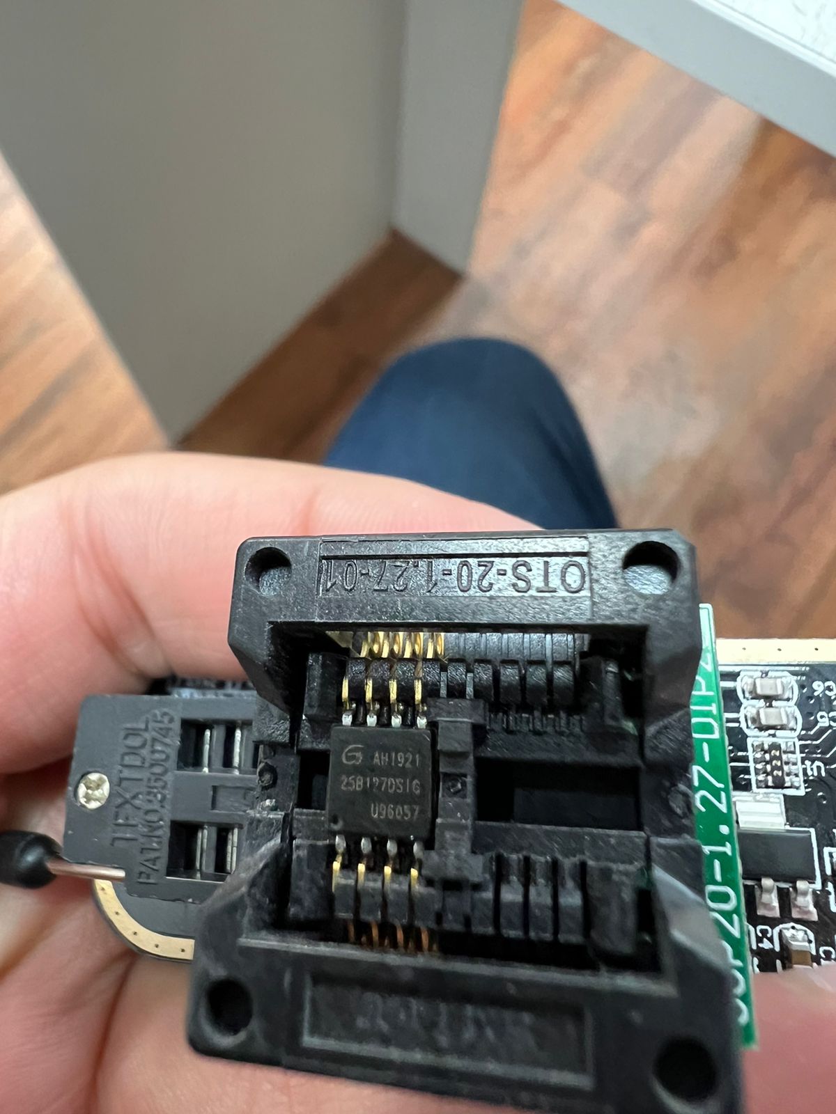

            Hi! can you please help me to unlock my precision 3541? attached is the file
            • bollas27
              • Sep 2022
              • 9
              • Ecuador
              Re: Precision 3541 bios password
              Idk if i read the file the right way, can someone point me in the right direction please? i attached a picture of the BIOS Chip. I use CH341A programmer but can't find the exact same chip
