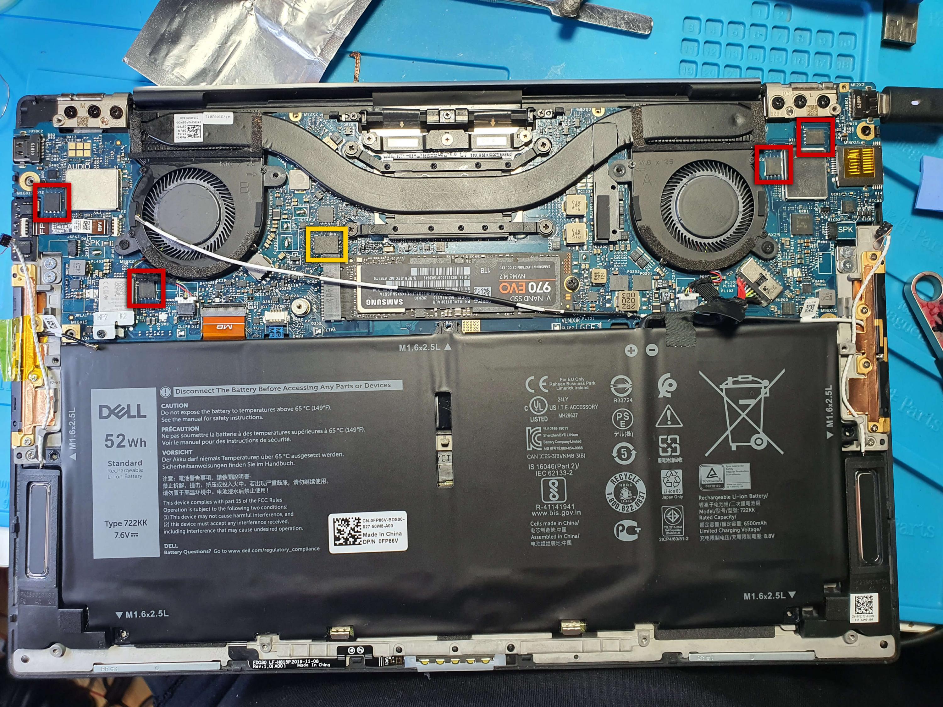

                      Re: dell xps 13 9300 fdq30 la-h811p rev:1.0 bios
                      I can't find the schematics or boardview for this model, can anyone point me in the direction which chip is the bios chip on here because I see 4 winbond chips in total
                        Ok managed to find the bios chip, and removed it, this is the dump, can anyone check it and clean it if needs it?
                            theres 4 winbond marked red and 1 PCH SPI Flash ROM 32M marked yellow. Do I have to desolder all 4, read them and save and upload dumps?
                            Here's a copy of the boardview and schematic if anyone needs them https://www.badcaps.net/forum/showthread.php?t=106344

                              • 21503
                              Try this bios.
