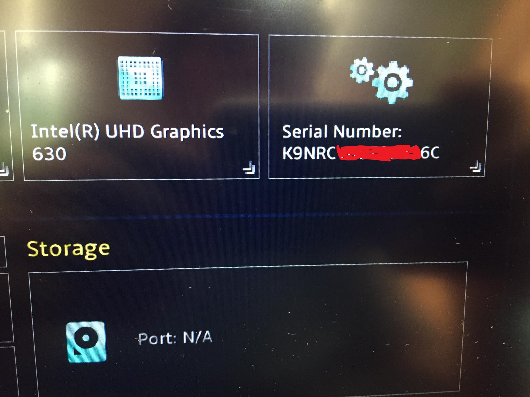

    board info:
    FX505GT MB REV 2.0A
    no display problem on this one. i also attached the bios backup..
    thanks...

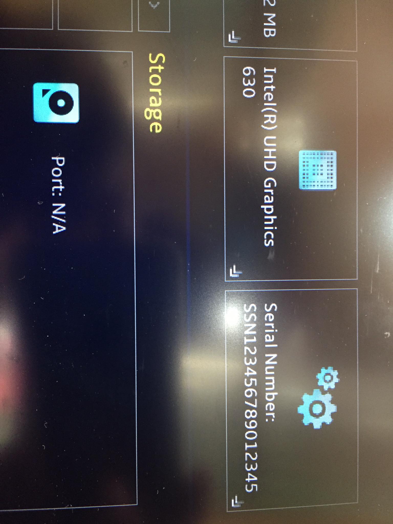

      Re: Asus TUF FX505G bios file needed
      Originally posted by martha februarini
      Could You try this ?
      thanks. I tried your file and it's working. but it had an invalid SN. i also finished editing the original bios file and by luck it works also with the right SN...
      your file - DATE MODIFIED 10/07/2021 10:00PM
      my file - DATE MODIFIED 10/07/2021 10:22PM
      thank you very much for sharing... i also attached my file

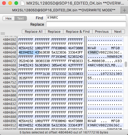

        which software use to editing serial number for asus fx505?
        • volinakis
          • Jan 2021
          • 2875
          • N/A
          try with HxD or any hex editor

            thanks bro i did it

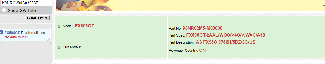

                  Originally posted by Jdpaz
                  had the same issue but the bios file here doesn't work.
                  attached is my back up bios and SN: KCNRCVRR02L49G thanks in advanced
                  SN WRONG
                  • hoaca388
                    Badcaps
                    • Jan 2022
                    • 12394
                    Originally posted by noname2024
                    SN WRONG
                    Serial number K9NRCV00A03536B belong to FX95GT .
