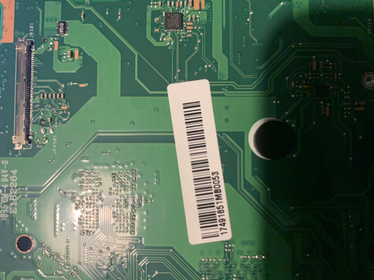

    Post a picture of the white barcode sticker on the motherboard

      Downloaded 2 files from fixbios for money, but no sucess.
      Picture is attached

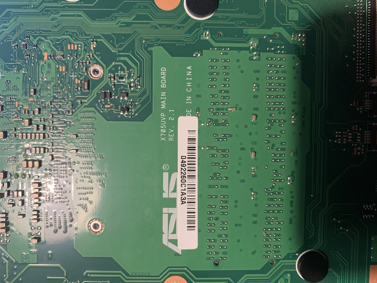

        Those aren`t the stickers i would hope you would post. The stickers are like the ones in this thread - https://www.badcaps.net/forum/showthread.php?t=96604 .Sometimes there`s QR codes instead ,or no stickers at all.
        So the laptop model is F705UA ,the motherboard silkscreened part number is X705UVP Rev. 2.1 ,and we don`t know if there should be another sticker or not (with a model number and bios version), so its hard to find which bios you need .
        Your bios update was to X705UVP and that doesn`t seem to be working.The F705UA support page has X705UAR - https://www.asus.com/FR/supportonly/...HelpDesk_BIOS/ ,we`ll try that one

          I think the correct model is
          X705UAP, because I can also find this string in my bios file using ctrl + f
          https://www.asus.com/supportonly/X705UA/HelpDesk_BIOS/
          /Edit: No sucess. Could you build a dump of X705UAP, please?

              But sadly, no change.
              I can see that one rail in CPU area is not coming on, but since there is no schematic I guess the chance to repair it is very low.
              Could it be that the KBC has a bad flash?
