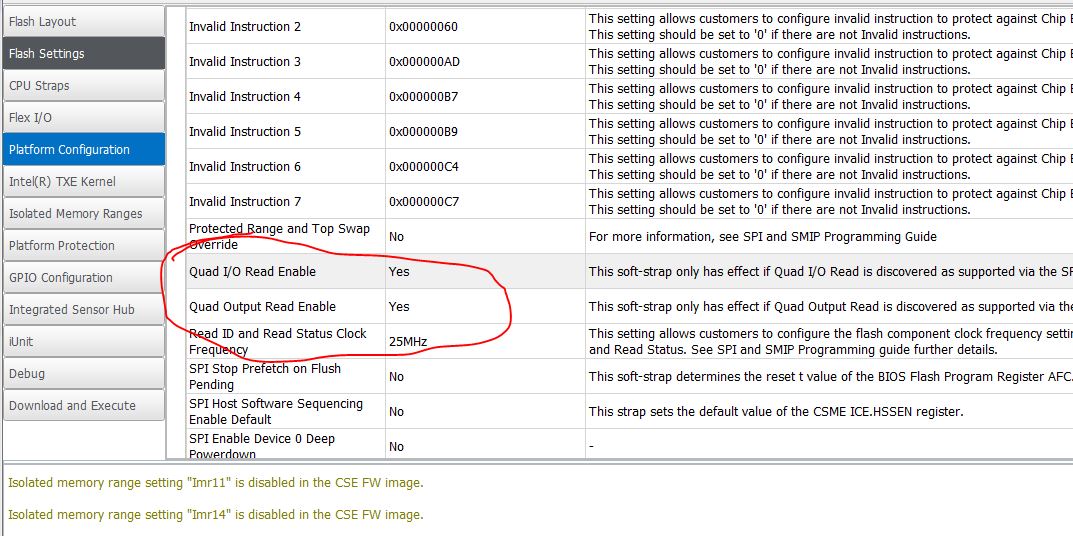

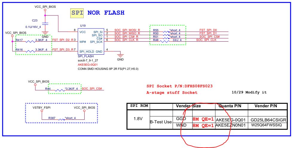

                        look smdflea, i have a deault bios ic(8mb) of gd25lb64c, using this chip will have display on the laptop but until windows logo only and it goes blank after logo of windows, i try to use winbond w25q64fw with same bios u gave but no display, so this board is preventing me to use winbond?
                          • 22286
                          Re: bios for es1-332
                          If your programmer has a QE bit setting then set it to 1 . This is the quad enable
                          • juntmeako
                            NOOB
                            • Jul 2020
                            • 67
                            • na
                            hmm that qe is new to me, i just use normal flashing on chips, im using ch341a, with either neoprogrammer or asprogrammer, how to find that qe in setting?
                            • juntmeako
                              NOOB
                              • Jul 2020
                              • 67
                              • na
                              update, i just flashed with winbond now, i used the w25q64fwsiq which is compatible to gd25lb64csig , they are both qe enabled, anyway, the same problem exists... screem goes blank when after windows logo, but heres what i observe, it accidentally booted to safemode and its working, if its in safemode everythi g works fine, but when in normal its diaplay goes blank after windows logo loading, what maybe the cause? is it the igpu? this laptop used celeron n3450,
