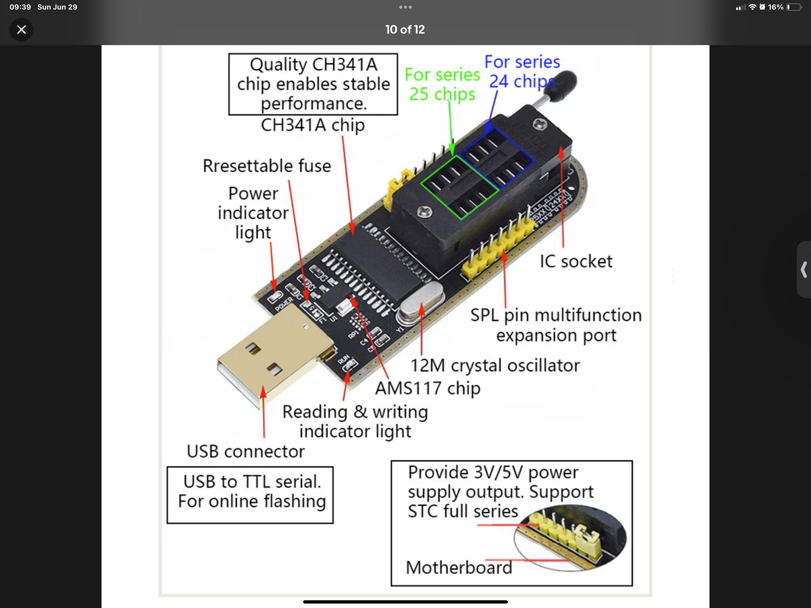

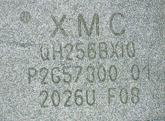

                                #275
                                Is there a reader y'all recommend? I have a QH256BXIQ (XM25QH256BXIQ) and I am using the Ch341 to read it, but none of the readers I have looked at have that specific chip by XMC.​
                                • peste
                                  • Dec 2016
                                  • 12413
                                  • ROMANIA
                                  #276
                                  manually select an equivalent chip..
