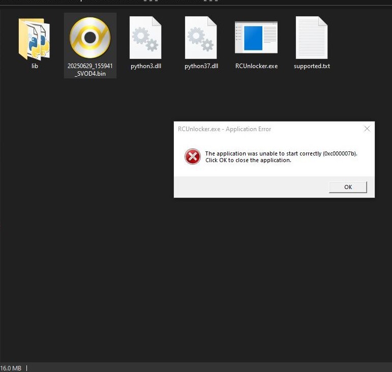

          #1264
          The RCUnlocker is not working and gives this message. Please help.

            #1265
            post S/N, full name and model, motherboard model, product number,etc.
            post the original contents of the bios chip..
