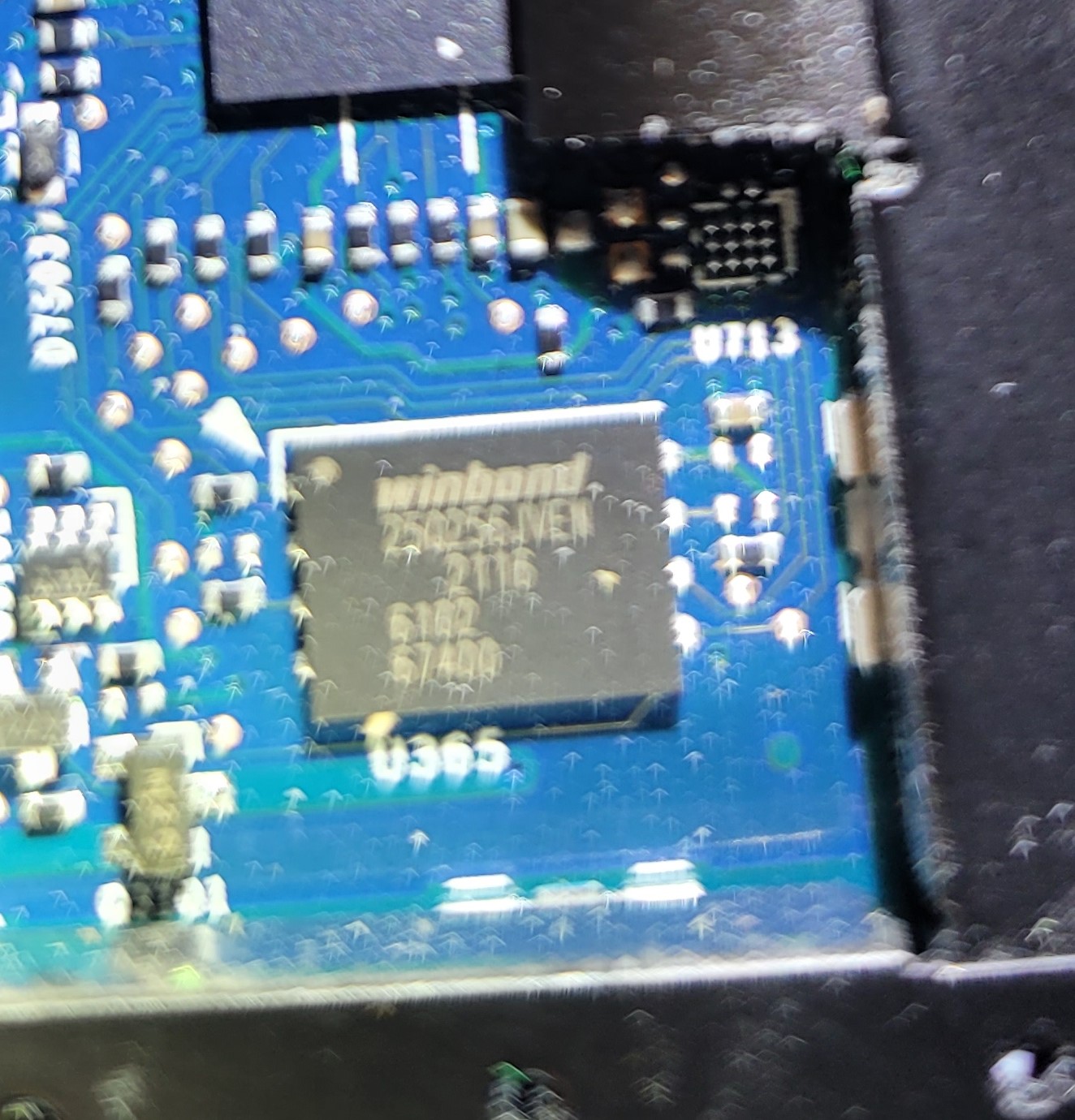

            Hi guys, I have a Hp Probook x360 435 G7. I found a 32mb MXIC chip, and an Unknown size windbond 25W256JVEN chip when removing the cover. Do I have a 16mb chip on the under side of the motherboard? I am not going to be de soldering. I will be using the clip on programmer, so just asking if I need to remove the MB? Neither one of the chips Ive mentioned show up in the search in the software.
            • hoaca388
              Badcaps
              • Jan 2022
              • 11885
              #406
              Re: RCUnlocker
              If so your bios and ec are both 32MB type, no 16MB chip.

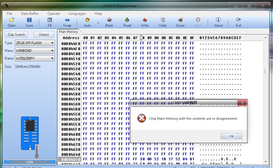

                      Here are my two files. Couldnt verify, as my chips arent in the list.

                            Both are bad - ch341a?

                              #414
                              Re: RCUnlocker
                              yes, and yes. on pass 8 trying to verify windbond

                                #415
                                Re: RCUnlocker
                                Will not verify. Every pass verification goes to 25%.

                                  Re: RCUnlocker
                                  Its because the software is shit,and also i think its because the bios chips are WSON8, the clip will not fit onto them.If they are WSON8 then you will have to desolder or solder wires from the adapter board to the gold pads connected to each chip pin
                                  Use these software alternatives,you`ll find them all posted on the forum
                                  NeoProgrammer, Colibri, AsProgrammer

                                    I was wondering if the software is crap. Here is a pic of the chip. The clips seem to make good contact.
                                      • 21164
                                      #418
                                      Re: RCUnlocker
                                      Yes thats a WSON8 chip, don`t use the clip on that,you risk damaging the chip,shorting the surrounding components and cutting through traces.
                                      Your options are to desolder it,use a WSON8 pogo pin adapter,or try to solder some thin wires to the protruding solder or traces caps and resistors
