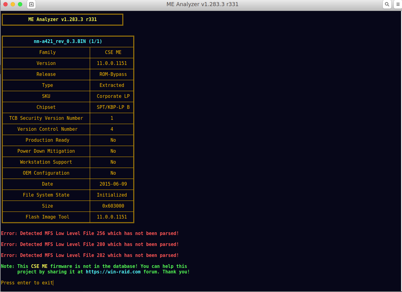

                Hello, could you help me clean the ME region?
                My laptop does NOT have the common motherboard which is REV 3.0 or 4.0.
                This is REV 0.3 and in the ME Analyzer in the Chipset section it shows me SPT/KBP-LP B
                TYPE: 20F9-Z17DUS
                S/N: PC-04F278
                Thank you

                    #29
                    Re: ThinkPad t460s Patched Bios Request
                    Originally posted by newdes
                    Help me pls
                    Your problem is that no CSE Me was found in the database.
                    Version 11.0.0.1151 Corporate LP dose not exist.

                      #30
                      There's no need to be exactly this version, use any available 11.0.X.XXXX Corporate LP version. Only major and minor version must be the same, hotfix and build number can be different - it's not a problem.
                      Example: AA.B.C.DDDD
                      AA - major version
                      B - minor version
                      C - hotfix
                      DDDD - build number
                      Edit:
                      Intel CSME (Converged Security Management Engine) Repository download link.

                        #31
                        Help me pls
                        Yes, if you mean Vesko356 it's not a problem, I was just surprised that I
                        couldn't find the version.
                        He can try if he wants.
                        Maybe it will help him.
