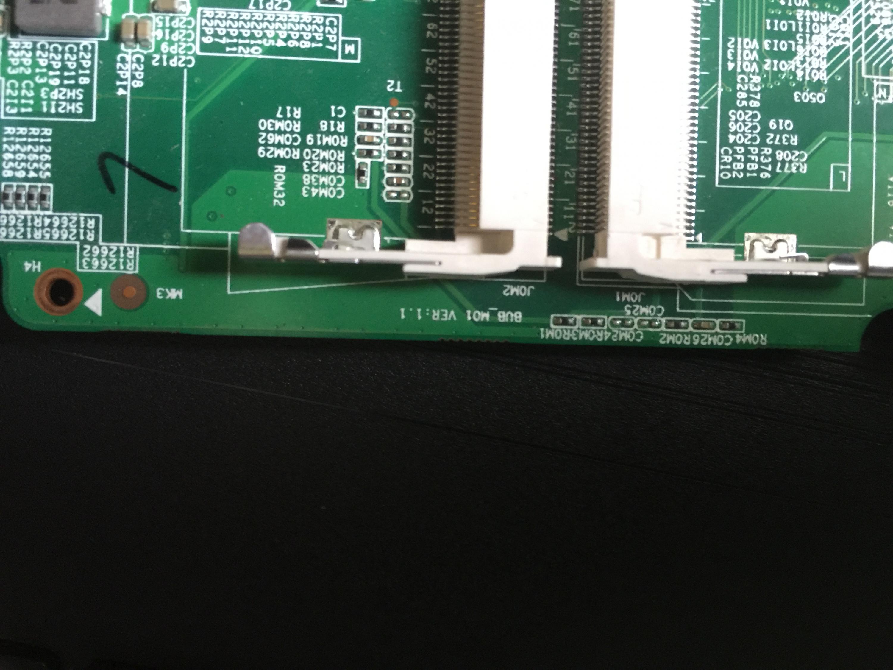

    Hi guys. i have a laptop bin that needs to be repaired. After a bios update the machine didn't power on just blinks caps once. Again the laptop has no name on it completely. But online it is a B15 i5 5257u and the board number is BUB_M01 VER:1.1 Attached is the Original BIN. Kindly someone fix it for me i will be glad.

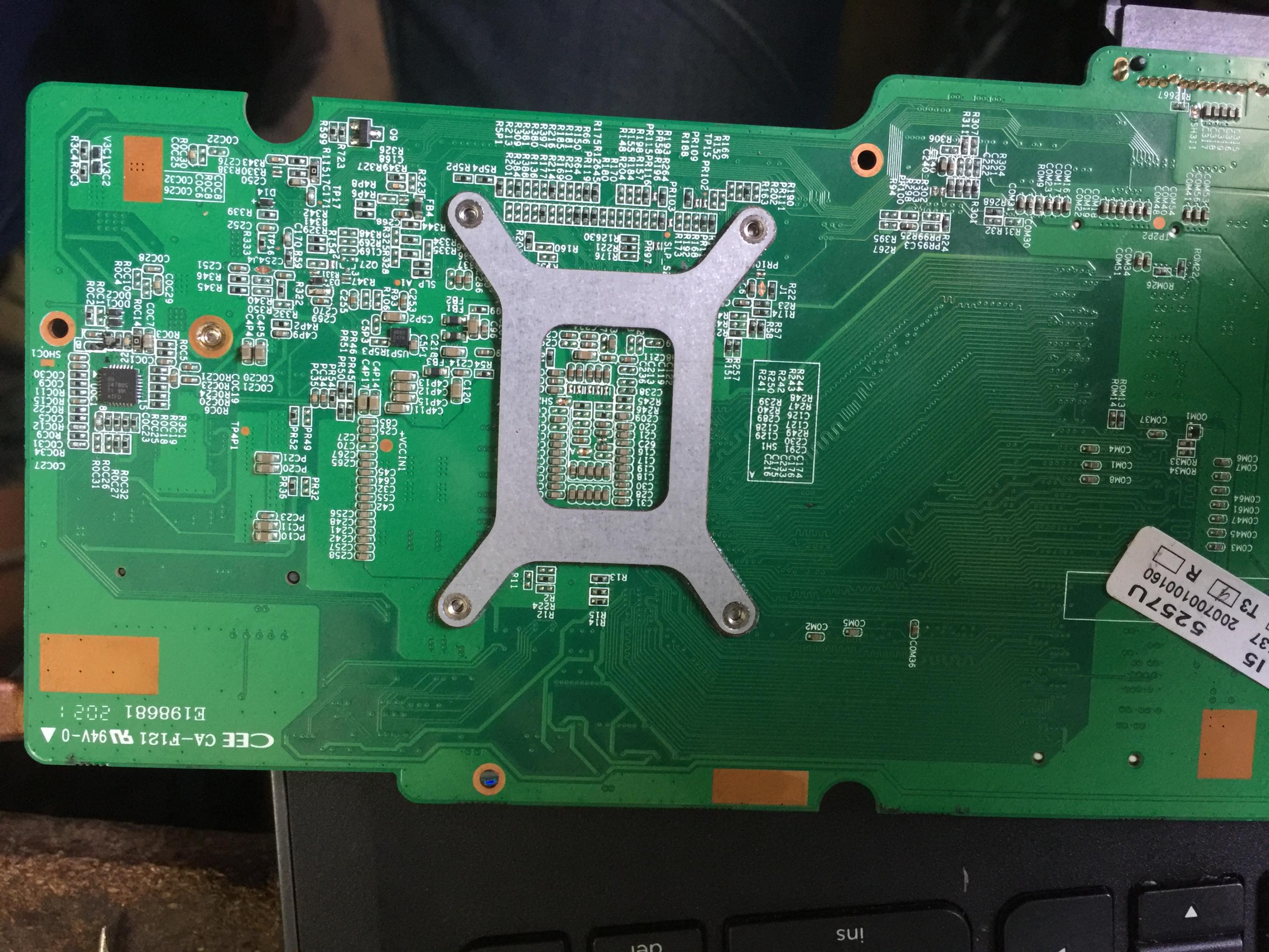

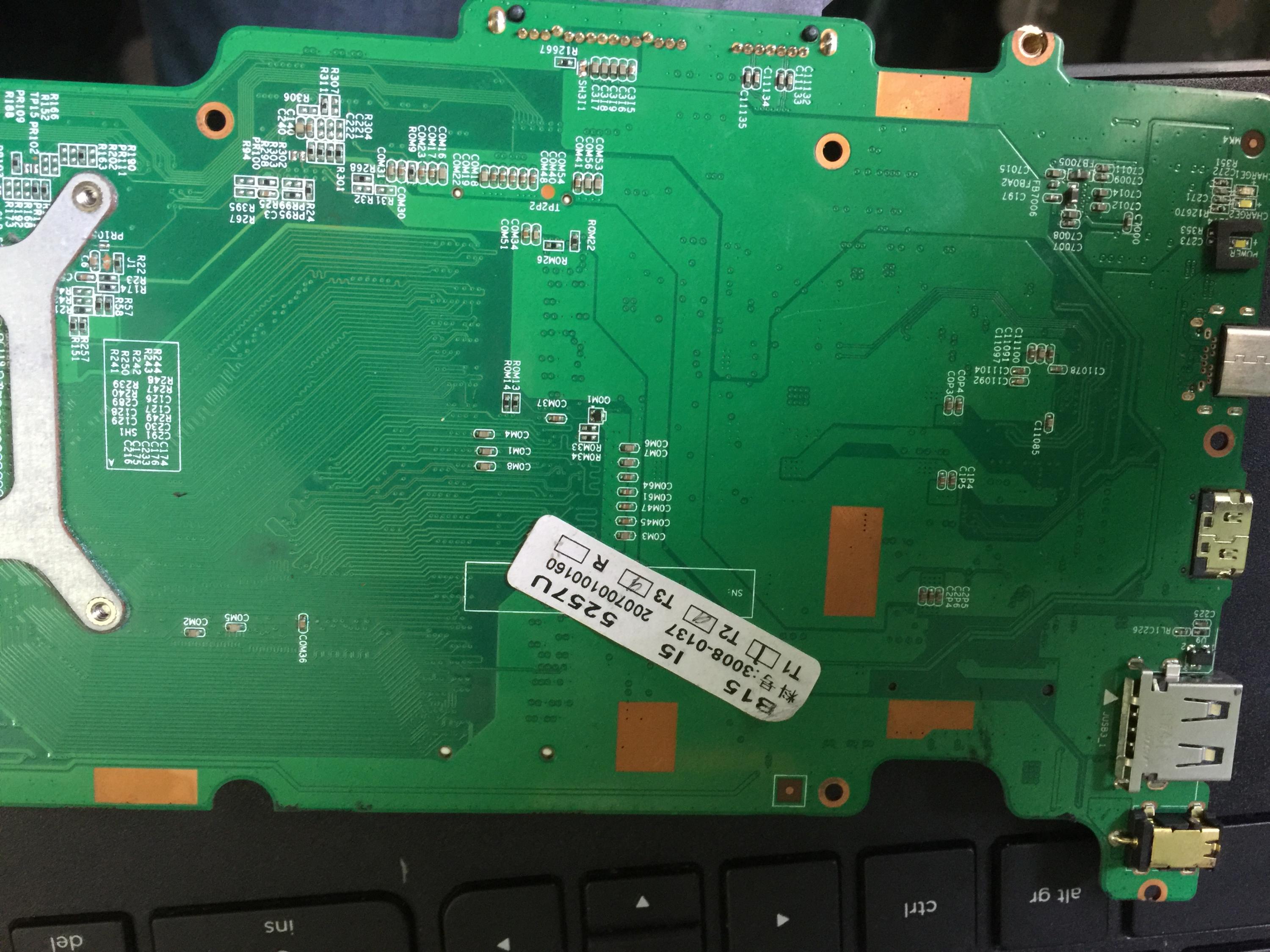

        Re: B15 LAPTOP CORE i5 5257u BIOS NEEDED
        Attached are the board images
              i tried that bin still not working. 3v 5v present bios chip no voltage. switch has 3vlts. i still believe its bios. wen pressing power button caps lock flashes once and thats it
                • 21457
                On some boards the bios voltage comes up after pressing the power button.
                The bios has some info about the model , AIERXUAN XIAOXUAN Pro .

                  I still havent managed reviving that machine. I dont know what i wl do about he bios issue. The bios chip voltage is 3v. Thats when programming. I just need one last bin file to try if it works well if it doesnt i throw it away
                    • 21457
                    What is the bios voltage when pressing the start button. If you contact aierxuan they might send you a bios if you`re very lucky http://www.aierxuan.com/portal.php?mod=view&aid=71 ,or wait until someone with the same laptop posts a dump.
