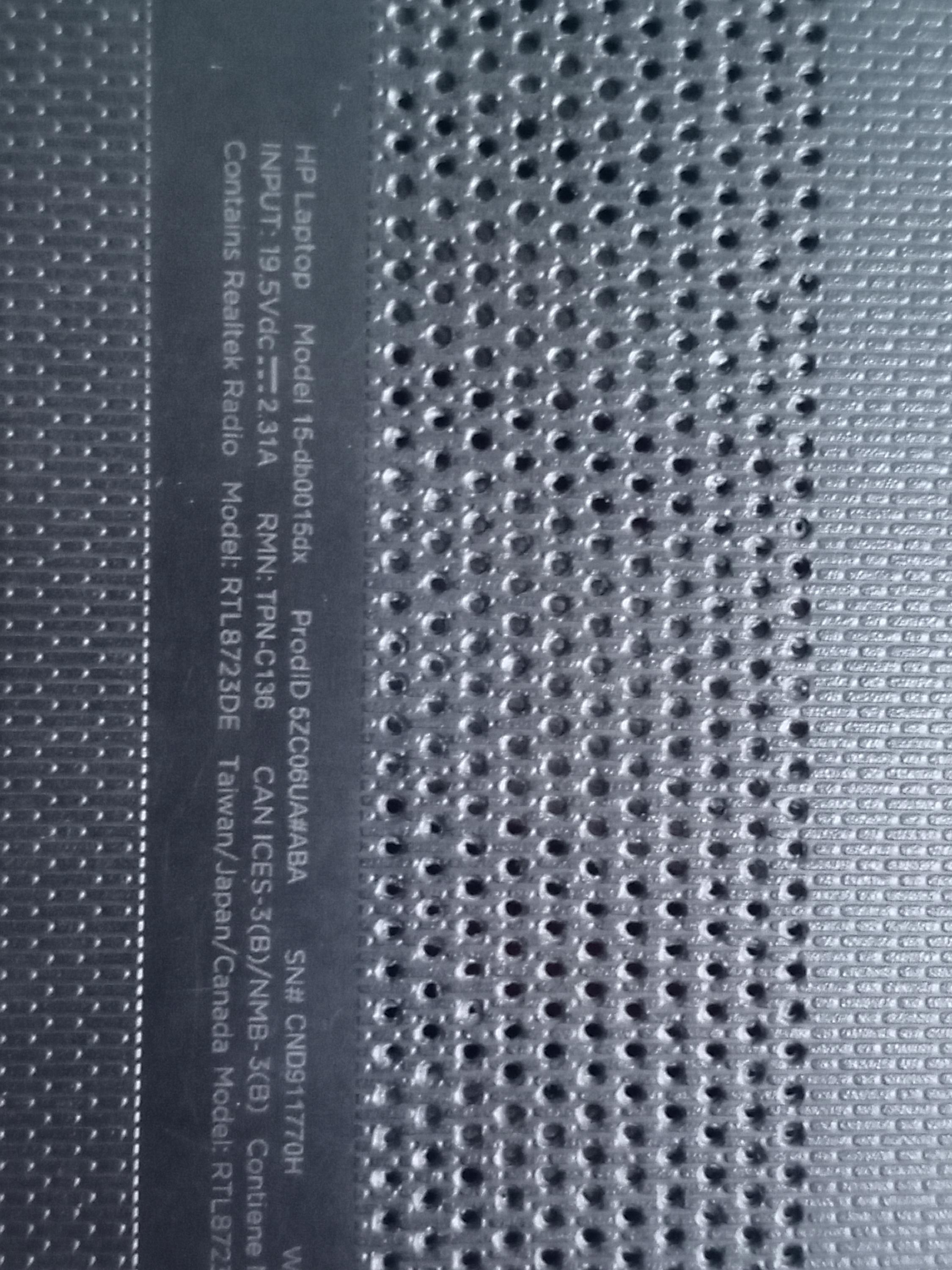

Need Bios EPV51-LA-G078P

    The bios file was downloaded from hp website by model number

      Re: Need Bios EPV51-LA-G078P
      according to the laptop model, there are four bios variants... do you still have the original bios?? post it... see post #2...
        This bios was downloaded from Hp website by searching model number
          according to the laptop model, the support page gives you FOUR bios options, according to the S/N you posted, no bios option... I don't even know what you downloaded... check again...
            This is the SN
