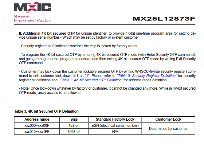

    Hi guys,
    I am having problem with flashing (writing) BIOS Chip MX25L12873F on HP 830 G6.
    With the flashrom software in Linux i got the error:
    Erasing and writing flash chip... FAILED at 0x00011000! Expected=0xff, Found=0x00, failed byte count from 0x00011000-0x00011fff: 0x18
    ERASE FAILED!
    Looking for another erase function.
    FAILED at 0x00018000! Expected=0xff, Found=0x00, failed byte count from 0x00018000-0x0001ffff: 0x12
    Then i used Asprogrammer in Windows it showed me:
    Possible protection is enabled. Press "Unprotect" and check datasheet
    I have pressed "Unprotect" but no success
    The Reading was good without any problem. Both in Linux and Windows. All the read files have same SHA256 Checksum.
    I think there's something block writing on the Chip.
    Maybe you can help.
    Thank you

            I have tried. Sadly no Success
            Current programmer: CH341a
            12:07:56
            Erasing memory...
            WARNING, probable erasure failure, check protection bits in status registers.
            Execution time: 00:00:00.061
            Old protection Register: 01000000(0x40),
            New protection Register: 01000000(0x40),
            I have read the Datasheet. There is 4K-bit secured OTP (see attached Picture)
