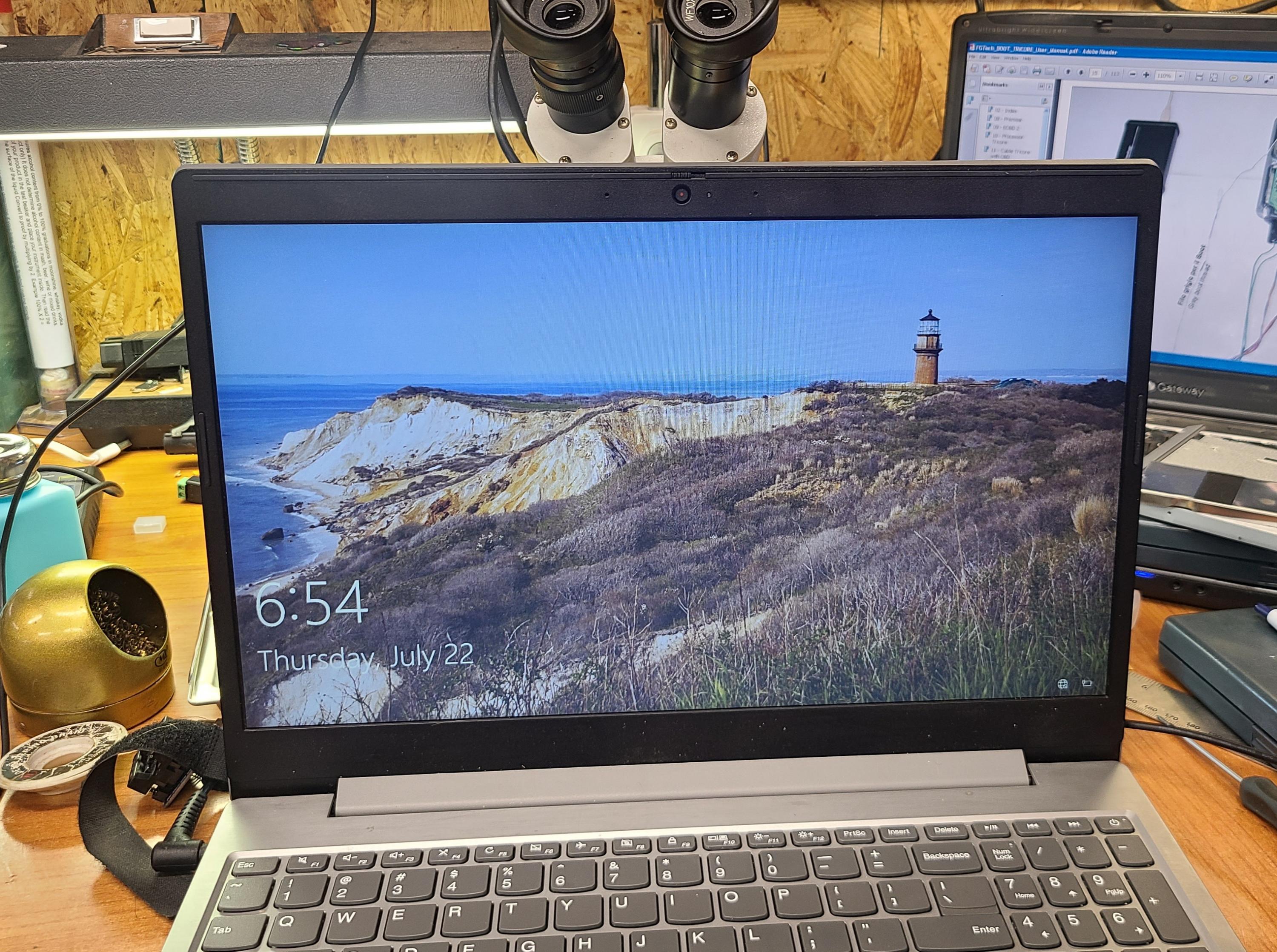

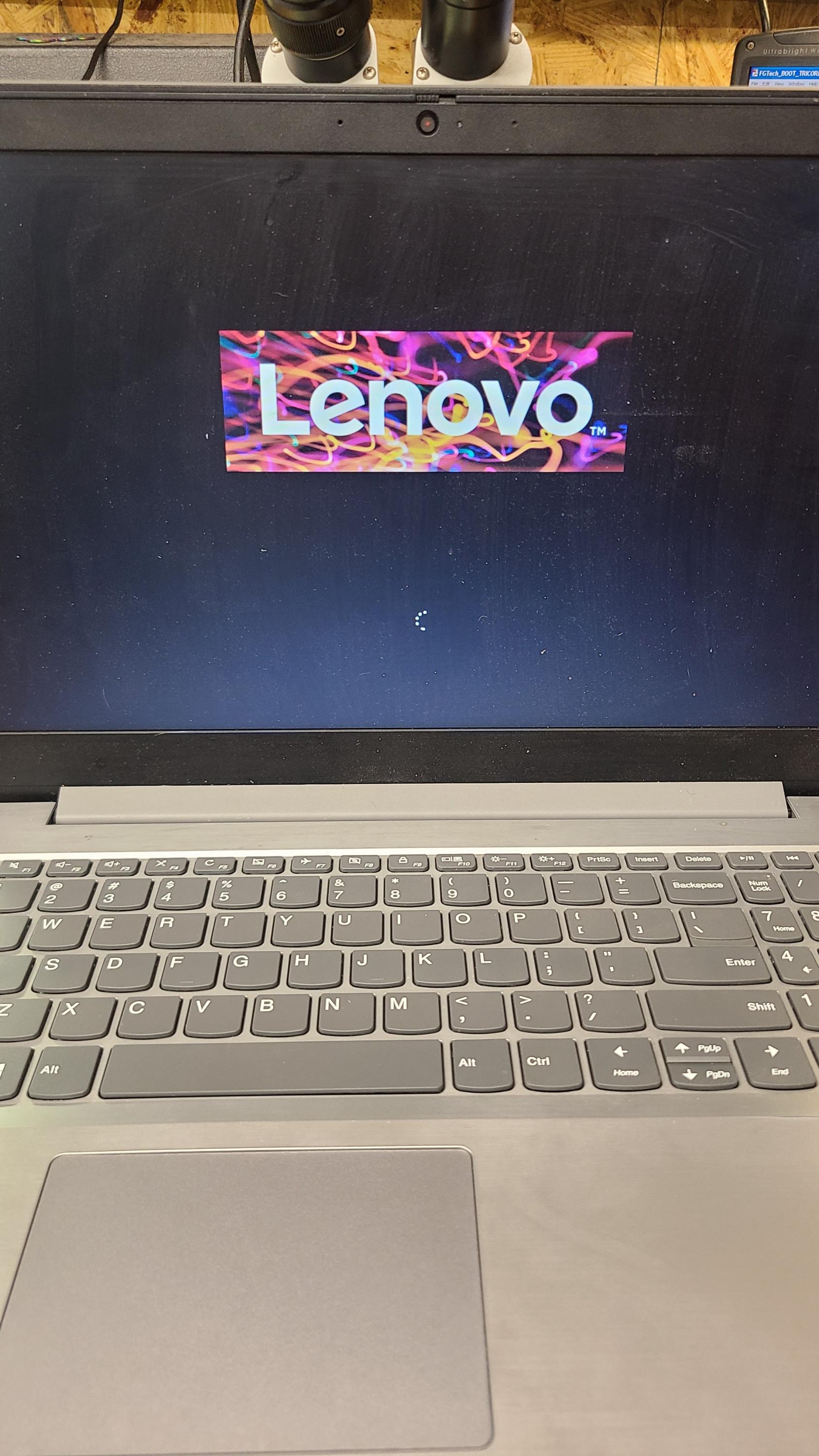

    Lenovo L340-15API BIOS Dump needed
    I am looking for a BIOS dump for a Lenovo L340-15API. NM-C101 Rev:1.0.
    The laptop was shut off during a BIOS update and doesn't boot. The power light flashes and has a slow fan spin. If anyone has one they are willing to share, I would greatly appreciate it

      Re: Lenovo L340-15API BIOS Dump needed
      Here is the BIOS dump that I suspect is corrupt
        Try
          Originally posted by Vesko356
          Try
          Thank You!!!
          That BIOS dump worked
