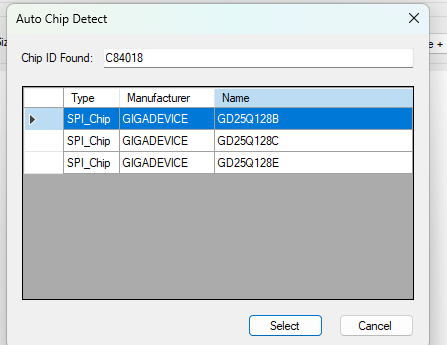

              I am using a clip on top with a ch341 programmer it is a 25b127, I have had to set as GD25Q127c in the one program or GD25G128 in a different program, this is what I have just read from it

                #48
                This is what the programs autodetect it as
