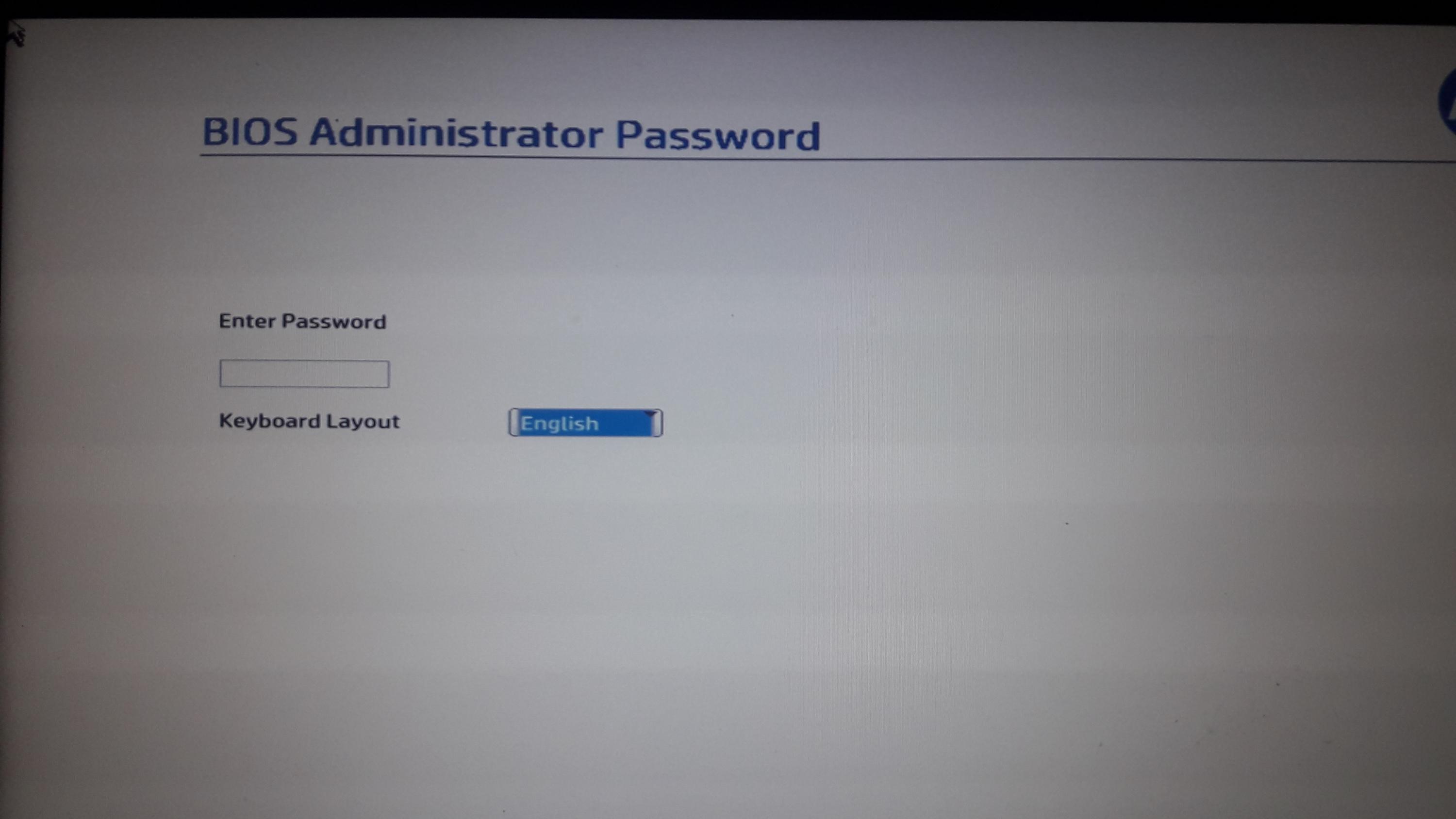

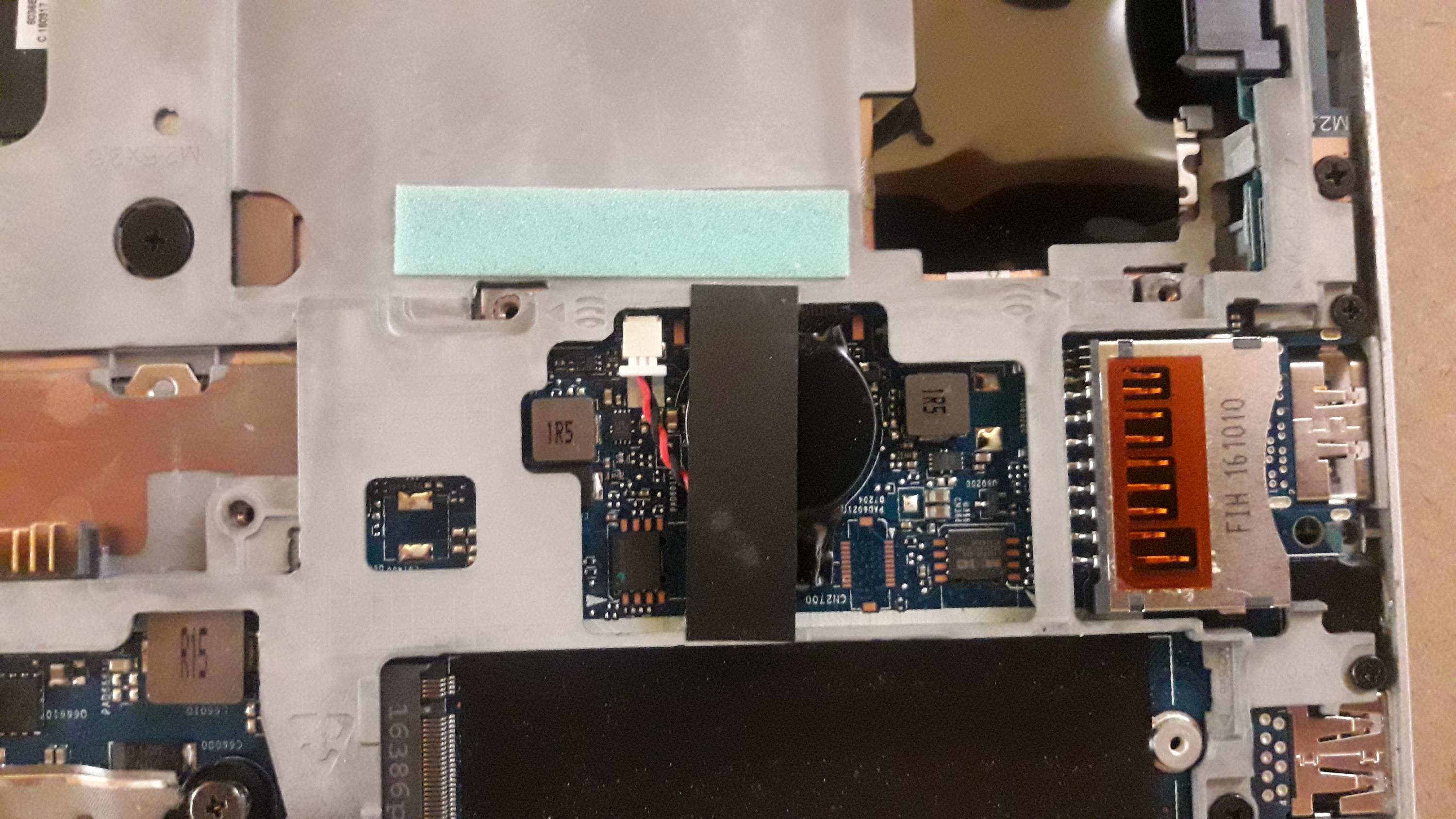

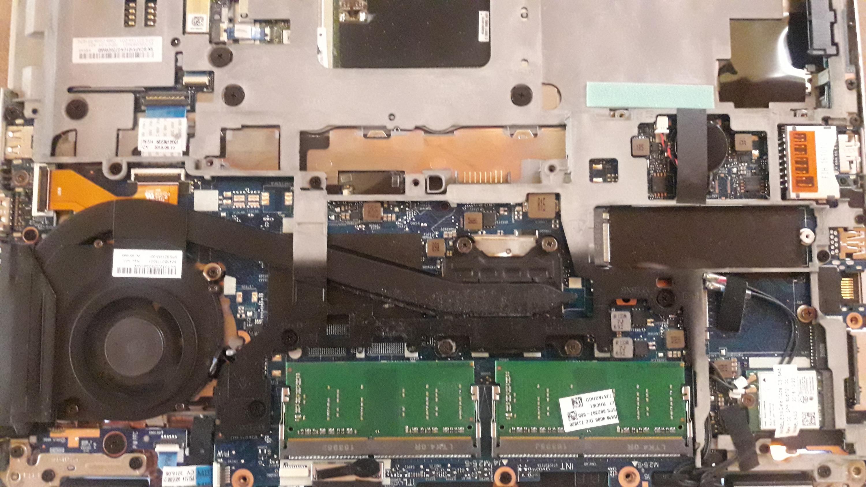

    Guys I have an HP Elitebook G3 840 which is BIOS locked... and I need to identify the BIOS on the board. I'm kind of sure which one it is but since I don't have the schematics, I rather ask and be 100% sure. (pics attached)
    Also, what is the proper way to get the BIOS file unlocked? And finally, do I need to unlock BIOS in order to install OS and proceed with booting of the OS. The laptop doesn't have a hdd. That's why I ask
    thanks

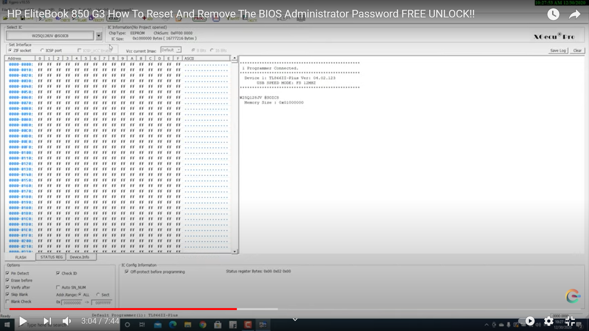

    That two tiny WSON-8 on the second picture. You have to desolder it and using HP BIOS UNLOCK TOOL to unlock it. After that you can solder even SOIC8 if you want.

      it is the one on the left.. right?

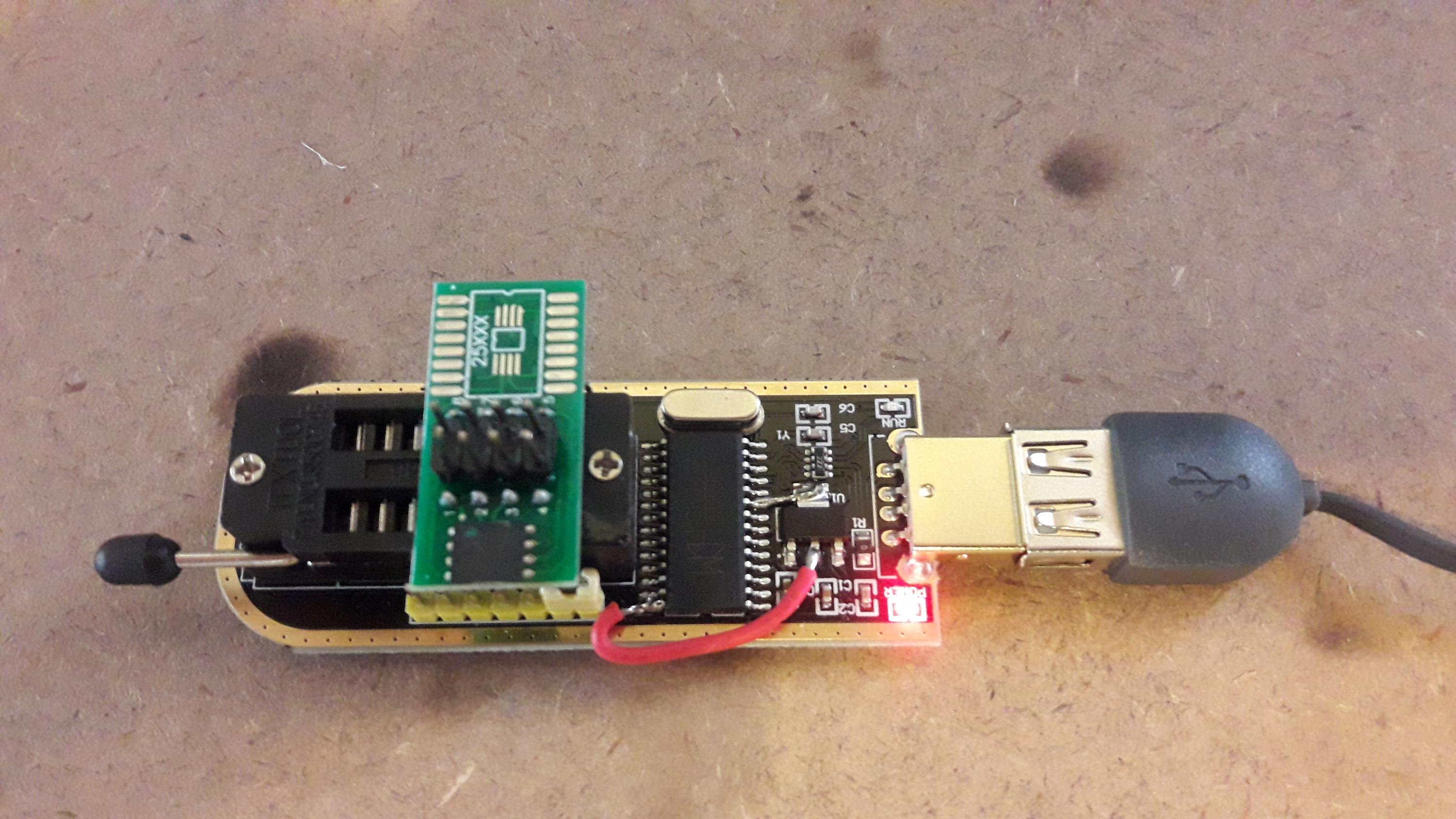

        I've tried downloading the bios file using ch341a and NeoProgrammer, and also with AsProgrammer, in both cases it failed to communicate with the ic. I got error reading ic (NeoProgrammer will not detected) It is not the board, as I have another bios and it will read it just fine. I looked for bios number on both programmers and I can't find the exact model. 25Q128FVPQ
        I've seen people using this programmer which I don't know the name (see picture attached).
        has anyone has dump the bios file using ch341a and either neoprogrammer or asprogrammer?
        thanks

          The programmer on the left is a TL866II
            • 21002
            Re: Where's the BIOS on HP EliteBook G3 840
            Do you have pin 1 of the chip lining up with pin 1 on the adapter. The green paint might not be where pin 1 is, can`t see the dot on your picture .

              I checked continuity with the meter from pin 1 to pin 1 on the connector, 2 with 2 and so on... it seems ok...
              but neither neoprogrammer or asprogrammer recognized the chip..
                that one do not work with CH341a?... needs to be another hardware?? correct
                  Yes different hardware,you`ll find the official site for the XGecu TL866II at http://autoelectric.cn/EN/TL866_main.html

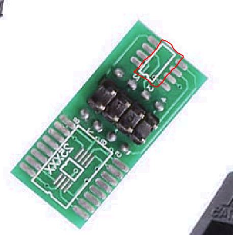

                    If theres a centre/center ground pad under the chip it might be in contact with pins.If it is use a piece of kapton tape across the middle so it doesn`t touch.

                      yes, there was contact between the pad, which I think is ground, and pin 5, I removed it with a solder... I don't know what tape you refer to... you mean a tape to eliminate solder pins? are you serious?
                      anyway after eliminating the contacts... still not recognized by neither software programmers

                        Yes i am serious.The adapter you`re using isn`t ideal for wson8 chips.You can cut a small piece of kaptop tape and put it cross the middle to stop the gnd pad on the chip touching the pads,see the picture with the red square where to put the tape.Or, buy a proper wson8 adapter,they cost around $2 with free shipping .
                        Anyway,if you`re sure nothing is bridging,and you`ve checked each pin with a multimeter and both programmers won`t read it (if both programmers have the chip in the support list ? ) then the chip is dead.
