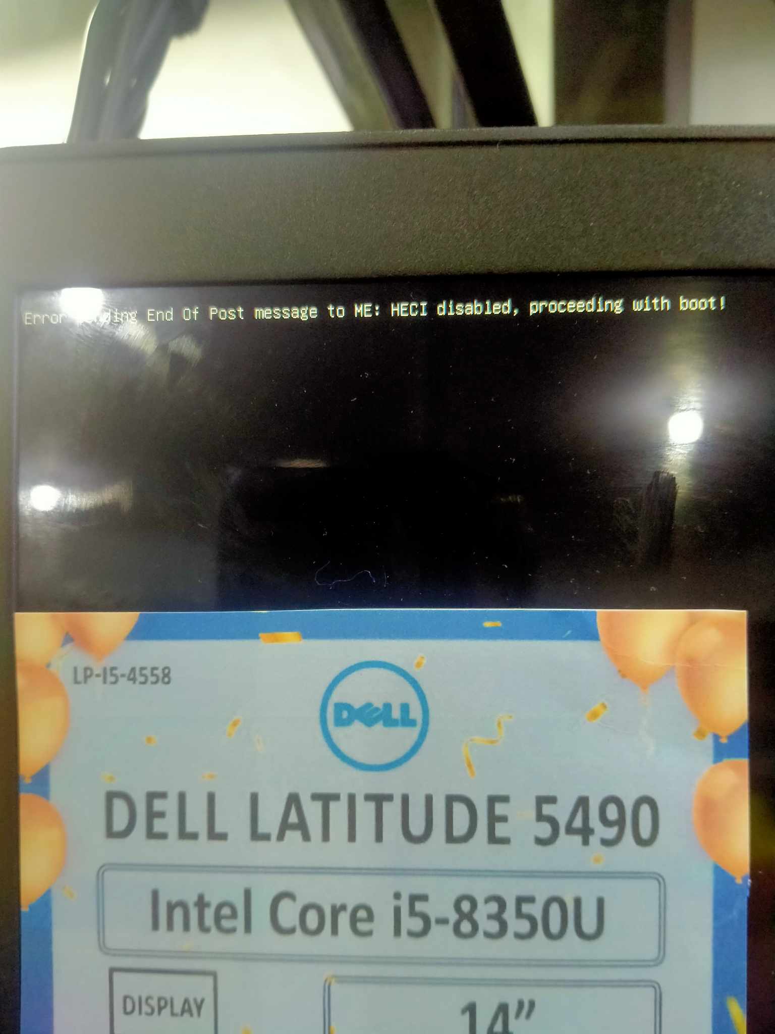

      Re: dell latitude 5490 bios
      Will reflash the bios now
      • BeachNL
        • Jan 2022
        • 5
        • Netherlands
        #43
        You are the best! It is fixed, updates to latest dell bios went fine! Thank you so much, you're kind!
          Originally posted by rbvndonh
          i found that in past someone must already change bios. I use "never tagged". It found proper mac addres, but it start 30seconds and i could not find place to write windows cd-key.
          Please help
          ​https://www.badcaps.net/donate
          • rbvndonh
            • Mar 2021
            • 162
            • B
            #45
            Originally posted by hoaca388
            Unfortunatelly on this one it make continous reboots, without screen.
            Reflashin back my one works with delay.
            There is i3-7130U
            I wonder if someone changed already BIOS, as on Corporate LP it work fast, but was injected Consumer LP and on it there is 30s lag..
            Now i see you have Consumer H instead LP. Maybe this make fault.
            Edit:
            I use "never tagged" bios, then
            I inject mysefl this ME and it work great.
            Anyway thank you for try and help

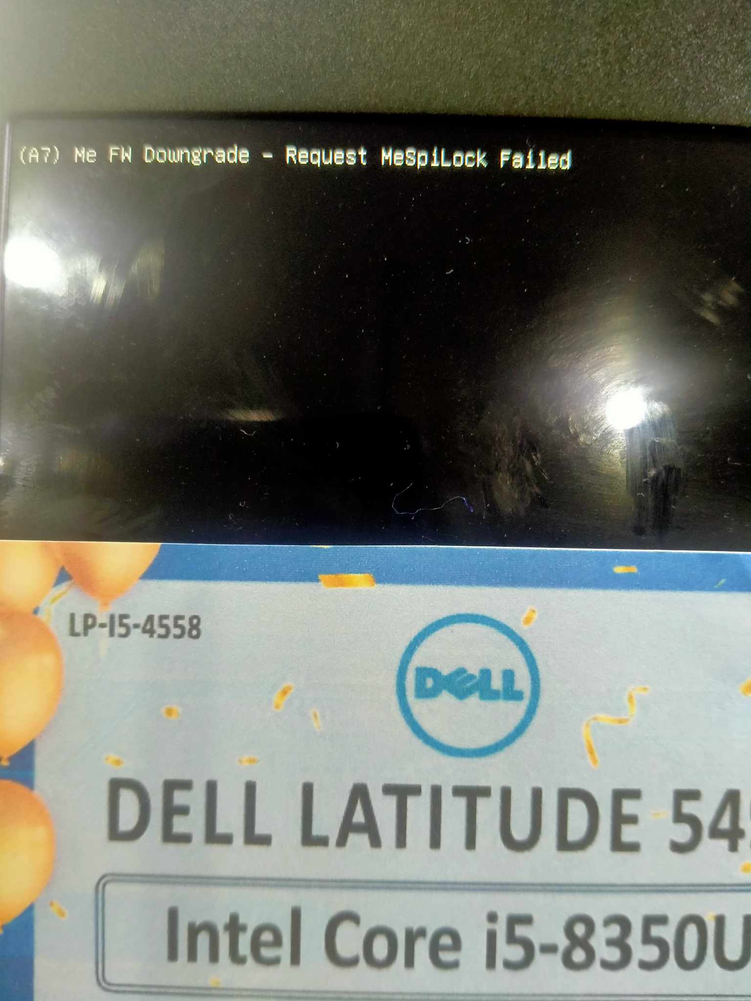

                                          #60
                                          Dell Latitude 5490 MESpiLock Failed
                                          Hello, i have this Dell Latitude 5490 Post to long and have this error () and the BIOS Bin file.
                                          can someone give me dump file
                                          board: LA-F401P Rev 2.0 (A01)
