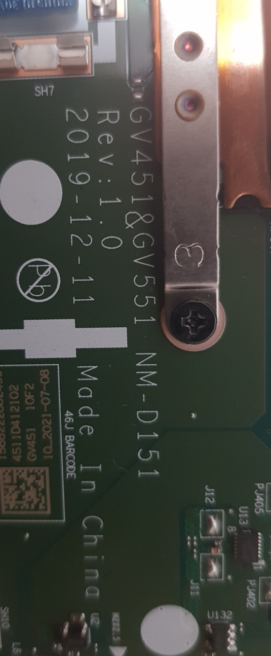

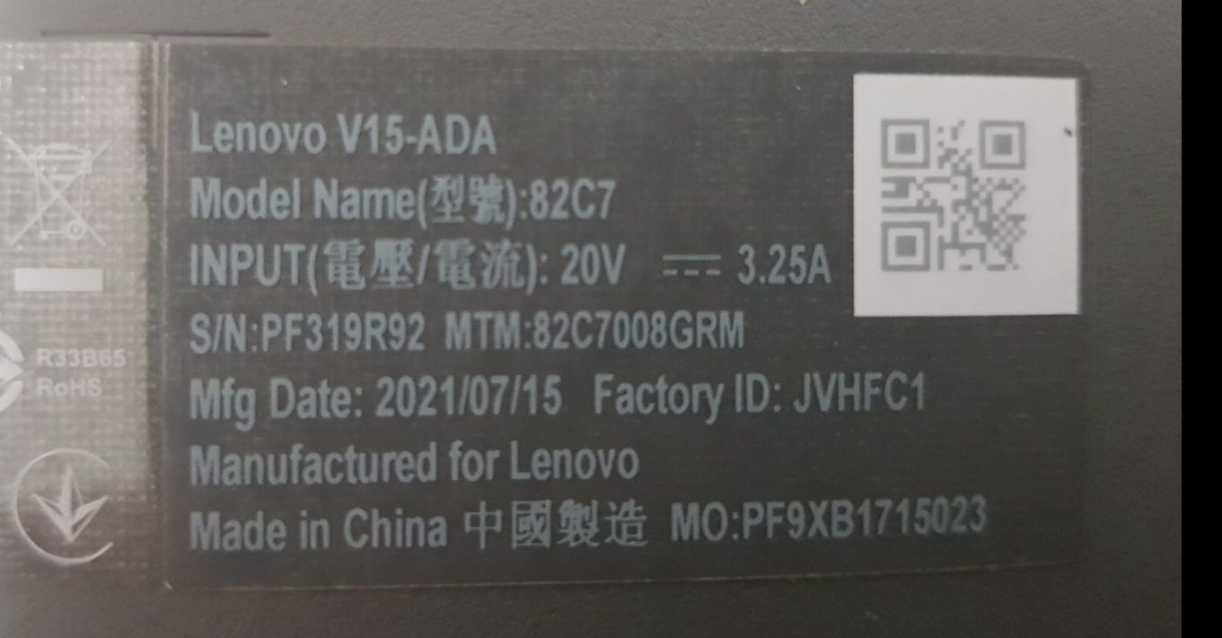

IdeaPad 3 14ADA05/15ADA05/17ADA05 Lenovo V14-ADA/V15-ADA Bios
  • pblenov541
    replied
    OK so I've studied the procedure in particular with this video but I don't have a backup of my previous bios healthy, it's corrupt because it was badly flashed precisely.
    https://youtube.com/watch?v=NyjflvtmAYA
    So how can I start from scratch with an old blank bios and transfer my information to it to generate a special bios with custom dmi? Thanks
    Leave a comment:
  • antiogu
    replied
    Originally posted by Bios Cracker
    IdeaPad 3 V15-ADA Laptop (Lenovo) - Type 82C7ADA
    Tank you
    Leave a comment:
  • Bios Cracker
    replied
    Originally posted by antiogu
    Hi everyone
    i have a lenovo V15-ADA
    Model 82C7
    Serial PF2CZ1AN
    MTM 82C7S00B00
    after updating the bios the LEDs light up, the fan spins but nothing else happens, i saved my bios can you help me?​
    IdeaPad 3 V15-ADA Laptop (Lenovo) - Type 82C7ADA
    Leave a comment:
  • peste
    replied
    Originally posted by antiogu
    Hi everyone
    i have a lenovo V15-ADA
    Model 82C7
    Serial PF2CZ1AN
    MTM 82C7S00B00
    after updating the bios the LEDs light up, the fan spins but nothing else happens, i saved my bios can you help me?
    you have everything you need at post #341...
    Leave a comment:
  • hoaca388
    replied
    Originally posted by antiogu
    Hi everyone
    i have a lenovo V15-ADA
    Model 82C7
    Serial PF2CZ1AN
    MTM 82C7S00B00
    after updating the bios the LEDs light up, the fan spins but nothing else happens, i saved my bios can you help me?​
    Here
    Leave a comment:
  • antiogu
    replied
    Hi everyone
    i have a lenovo V15-ADA
    Model 82C7
    Serial PF2CZ1AN
    MTM 82C7S00B00
    after updating the bios the LEDs light up, the fan spins but nothing else happens, i saved my bios can you help me?​
    Leave a comment:
  • pblenov541
    replied
    Originally posted by peste
    you have everything you need at post #1,and12...
    Leave a comment:
  • peste
    replied
    Originally posted by pblenov541
    I flashed the bios of my lenovo 15ADA05 with the latest bios available on lenovo. Unfortunately, after the installation procedure with continuous sounds, I had a black screen and tried to restart. Then the computer remained with a black screen on reboot and the fan running normally. Impossible to launch the bios. So I dismantled the computer and tried flashing with cha341. I was able to read the current bios and saved it. I tried to rewrite on it with a bios found on bios archive but it doesn't work.
    Here is the information to help me get a dmi and a blank bios to remake a bios with a custom dmi:
    Ideapad 3 15ADA05
    MODEL name: 81w1
    SN: PF3NTMCG
    MTM: 81W1002GFR
    you have everything you need at post #1,and12...
    Leave a comment:
  • pblenov541
    replied
    I flashed the bios of my lenovo 15ADA05 with the latest bios available on lenovo. Unfortunately, after the installation procedure with continuous sounds, I had a black screen and tried to restart. Then the computer remained with a black screen on reboot and the fan running normally. Impossible to launch the bios. So I dismantled the computer and tried flashing with cha341. I was able to read the current bios and saved it. I tried to rewrite on it with a bios found on bios archive but it doesn't work.
    Here is the information to help me get a dmi and a blank bios to remake a bios with a custom dmi:
    Ideapad 3 15ADA05
    MODEL name: 81w1
    SN: PF3NTMCG
    MTM: 81W1002GFR
    Leave a comment:
  • Sayidah
    replied
    thank you
    Leave a comment:
  • DanielDacko
    replied
    Originally posted by alphaVII
    Hi All
    I have an IdeaPad 3-17ADA05 -
    Serial PF206XN8
    Model 81W2 -
    MTM 81W20056FR
    that presented errors that seeme d to indicate onboard RAM issue.
    I tried to disable the onboard ram following the instructions here [ solder-desolder resistors] but had no boot
    I copied the DMI info to a downloaded Bios Bin as per this link
    https://www.badcaps.net/forum/troubl...pt#post1214739
    and got a boot ,but the system crashes with ACPI error after 5 minutes every time.
    Attached is the original Bios Dump and the one that sort of worked
    Thanks in advance
    Here is latest bios with your DMI information, but the problem isn't in the bios, it's in the CPU soldering. Reflow the CPU. This is known issue on those thin Lenovo boards.
    Leave a comment:
  • peste
    replied
    Originally posted by alphaVII
    Hi Peste,
    Thanks a lot for you answer, I will check right away
    Does anything needs to be changed in the bios if i disable the onboard ram via the resistors ? I could not be sure of it.
    try the bios first. see what happens..you can use post #29 without DMI changes...
    Leave a comment:
  • alphaVII
    replied
    Hi Peste,
    Originally posted by peste
    you have everything you need at post #29..
    https://www.badcaps.net/forum/troubl...-15ada05/page3
    for DMI information..
    the bios from post # 29 is virgin, use the HxD program (it's free on the internet), enter both bios into the program (your laptop and the virgin one),
    select that interval mentioned in both bios, copy the interval in your bios and pass it to the virgin bios (copy - paste)....and that's it...
    Thanks a lot for you answer, I will check right away
    Does anything needs to be changed in the bios if i disable the onboard ram via the resistors ? I could not be sure of it.
    Leave a comment:
  • peste
    replied
    Originally posted by alphaVII
    Hi All
    I have an IdeaPad 3-17ADA05 -
    Serial PF206XN8
    Model 81W2 -
    MTM 81W20056FR
    that presented errors that seeme d to indicate onboard RAM issue.
    I tried to disable the onboard ram following the instructions here [ solder-desolder resistors] but had no boot
    I copied the DMI info to a downloaded Bios Bin as per this link
    https://www.badcaps.net/forum/troubl...pt#post1214739
    and got a boot ,but the system crashes with ACPI error after 5 minutes every time.
    Attached is the original Bios Dump and the one that sort of worked
    Thanks in advance
    you have everything you need at post #29..
    https://www.badcaps.net/forum/troubl...-15ada05/page3
    for DMI information..
    the bios from post # 29 is virgin, use the HxD program (it's free on the internet), enter both bios into the program (your laptop and the virgin one),
    select that interval mentioned in both bios, copy the interval in your bios and pass it to the virgin bios (copy - paste)....and that's it...
    Leave a comment:
  • alphaVII
    replied
    Hi All
    I have an IdeaPad 3-17ADA05 -
    Serial PF206XN8
    Model 81W2 -
    MTM 81W20056FR
    that presented errors that seeme d to indicate onboard RAM issue.
    I tried to disable the onboard ram following the instructions here [ solder-desolder resistors] but had no boot
    I copied the DMI info to a downloaded Bios Bin as per this link
    https://www.badcaps.net/forum/troubl...pt#post1214739
    and got a boot ,but the system crashes with ACPI error after 5 minutes every time.
    Attached is the original Bios Dump and the one that sort of worked
    Thanks in advance
    Leave a comment:
  • lapfix
    replied
    Originally posted by malico
    Hi everyone,
    Lenovo V15-ADA Laptop
    Model name: 82C7
    SN: PF2BW4BC
    MTM: 82C70041LM
    BIOS FROM LENOVO WEB PAGE: laptops and netbooks :: lenovo v series laptops :: v15 adacontentdetail - Lenovo Support US
    I was updating my laptop's BIOS. In the middle of the process, the screen went black, and unfortunately I restarted the computer. After that, it won't turn on anymore. I've read that it can be recovered if I reflash it. I've tried several methods but haven't been able to get the correct BIOS file. This community (GUIDE-How-to-extract-BIOS-from-Lenovo-BIOS-Update-Package-such-as-ATCN37WW-exe - English Community - LENOVO COMMUNITY) explains how to extract the correct BIOS from the original file on the Lenovo website, but it didn't work for me. Hex files and assembly code aren't my thing.
    Finally, I understand that if I get the basic BIOS file and run it from a USB drive, I have the possibility of recovering my laptop, just as mentioned in this guide (I-need-to-recovery-corrupted-BIOS-for-LENOVO-YOGA-500-15IHV - English Community - LENOVO COMMUNITY). One last question: The BIOS file must have an fd, bin, or some special extension to run correctly. Please help me.
    AS mention in the guide : .bin
    if you can't have .bin...than post your old dump and the serial and someone will help you
    Leave a comment:
  • malico
    replied
    Hi everyone,
    Lenovo V15-ADA Laptop
    Model name: 82C7
    SN: PF2BW4BC
    MTM: 82C70041LM
    BIOS FROM LENOVO WEB PAGE: laptops and netbooks :: lenovo v series laptops :: v15 adacontentdetail - Lenovo Support US
    I was updating my laptop's BIOS. In the middle of the process, the screen went black, and unfortunately I restarted the computer. After that, it won't turn on anymore. I've read that it can be recovered if I reflash it. I've tried several methods but haven't been able to get the correct BIOS file. This community (GUIDE-How-to-extract-BIOS-from-Lenovo-BIOS-Update-Package-such-as-ATCN37WW-exe - English Community - LENOVO COMMUNITY) explains how to extract the correct BIOS from the original file on the Lenovo website, but it didn't work for me. Hex files and assembly code aren't my thing.
    Finally, I understand that if I get the basic BIOS file and run it from a USB drive, I have the possibility of recovering my laptop, just as mentioned in this guide (I-need-to-recovery-corrupted-BIOS-for-LENOVO-YOGA-500-15IHV - English Community - LENOVO COMMUNITY). One last question: The BIOS file must have an fd, bin, or some special extension to run correctly. Please help me.
    Leave a comment:
  • hoaca388
    replied
    Originally posted by infoner
    Greetings to all,
    i have my originall bios which is not working, Black Screen and No Fan only white Power Led ON
    BIOS Dump : Lenovo V14-ADA
    SN: PF2J0G92
    MTM: 82C6006CSP
    Model Name: 82C6
    Can please someone help me?
    Thanks in advance
    V14-ADA Laptop (Lenovo) - Type 82C6
    Leave a comment:
  • infoner
    replied
    Greetings to all,
    i have my originall bios which is not working, Black Screen and No Fan only white Power Led ON
    BIOS Dump : Lenovo V14-ADA
    SN: PF2J0G92
    MTM: 82C6006CSP
    Model Name: 82C6
    Can please someone help me?
    Thanks in advance​
    Leave a comment:
  • Dantepg
    replied
    Originally posted by hoaca388
    V15-ADA Laptop (Lenovo) - Type 82C7
    Thank You but I have same problem. The monitor gives a backlight for a second and than everything goes black.
    Thank you for your efort. Obviosly, there is a problem somewhere else.
    Leave a comment:
    Lenovo IdeaPad 3 15ADA05 Notebook 3 Specification for Upgrade or Repair
    This specification for the Lenovo IdeaPad 3 15ADA05 Notebook can be useful for upgrading or repairing a laptop that is not working. As a community we are working through our specifications to add valuable data like the 3 15ADA05 boardview and 3 15ADA05 schematic. Our users have donated over 1 million documents which are being added to the site. This page will be updated soon with additional information. Alternatively you can request additional help from our users directly on the relevant badcaps forum. Please note that we offer no warranties that any specification, datasheet, or download for Lenovo...
    09-07-2024, 05:00 AM
  • Patriarxis
    Lenovo IdeaPad 3 14ADA05 dosen't turn on
    by Patriarxis
    Hello.
    I have a Lenovo IdeaPad 3 14ADA05 that it dosen't turn on.
    It takes 0.027A and the power button flashing.
    All the voltages on the board are ok. 3.3, 5 etc.
    Also is charging the buttery .
    What else i can check?​
    05-26-2025, 01:03 AM
  • hotcrossedbuns999
    IdeaPad 1-14ADA05 Laptop - (Type 82GW) bios
    by hotcrossedbuns999
    First off, I saw the other thread, but that seems to be a different version (same model though), because I tried all of the linked bioses and none work. They actually cause the laptop to do nothing. At least when I use the bad bios, lights come on. (charging light, power button light, and caps lock light), but no screen.
    Another thing is that the bios has a different name (Old thread has "e8cn36ww" and mine is "fqcn31ww") and the BIN in this thread (below) are 8mb, and the CAP file that I get is 16mb (after using innextract 1.9). I don't know how to get the BIN...
    05-21-2025, 05:59 PM
  • pcwhiz24
    Bricked Lenovo IdeaPad 3 14ADA05 Need BIOS file for FN+R Crisis recovery
    by pcwhiz24
    Model: Lenovo IdeaPad 3 14ADA05 81W0
    S/N: PF2BZS7D
    I was having issues with this particular laptop where the NVME SSD would disappear and would not detect unless I took it out and reconnected it, then it would detect for only for a minute then disappear from BIOS. I figured updating the BIOS was worth a try so I booted into my HBCD USB and downloaded the latest BIOS file for that exact model. I ran the executable and everything went smooth, it beeped and then when it restarted, now it won't post, just black screen with fan spinning.
    I already have a CH341A programmer...
    04-07-2025, 07:10 PM
  • Visual_vt
    Lenovo IdeaPad 3 15ADA05 Model: 81W1, how to disable onboard MICROTEC RAM?
    by Visual_vt
    Lenovo IdeaPad 3 15ADA05 Model: 81W1, how to disable onboard MICROTEC RAM?
    Laptop freezes, sometimes no picture. POST every time with 4GB additional memory but still freezes in the windows.
    SSD and BIOS seems to be OK.
    Thank you....
    12-30-2024, 09:14 AM
