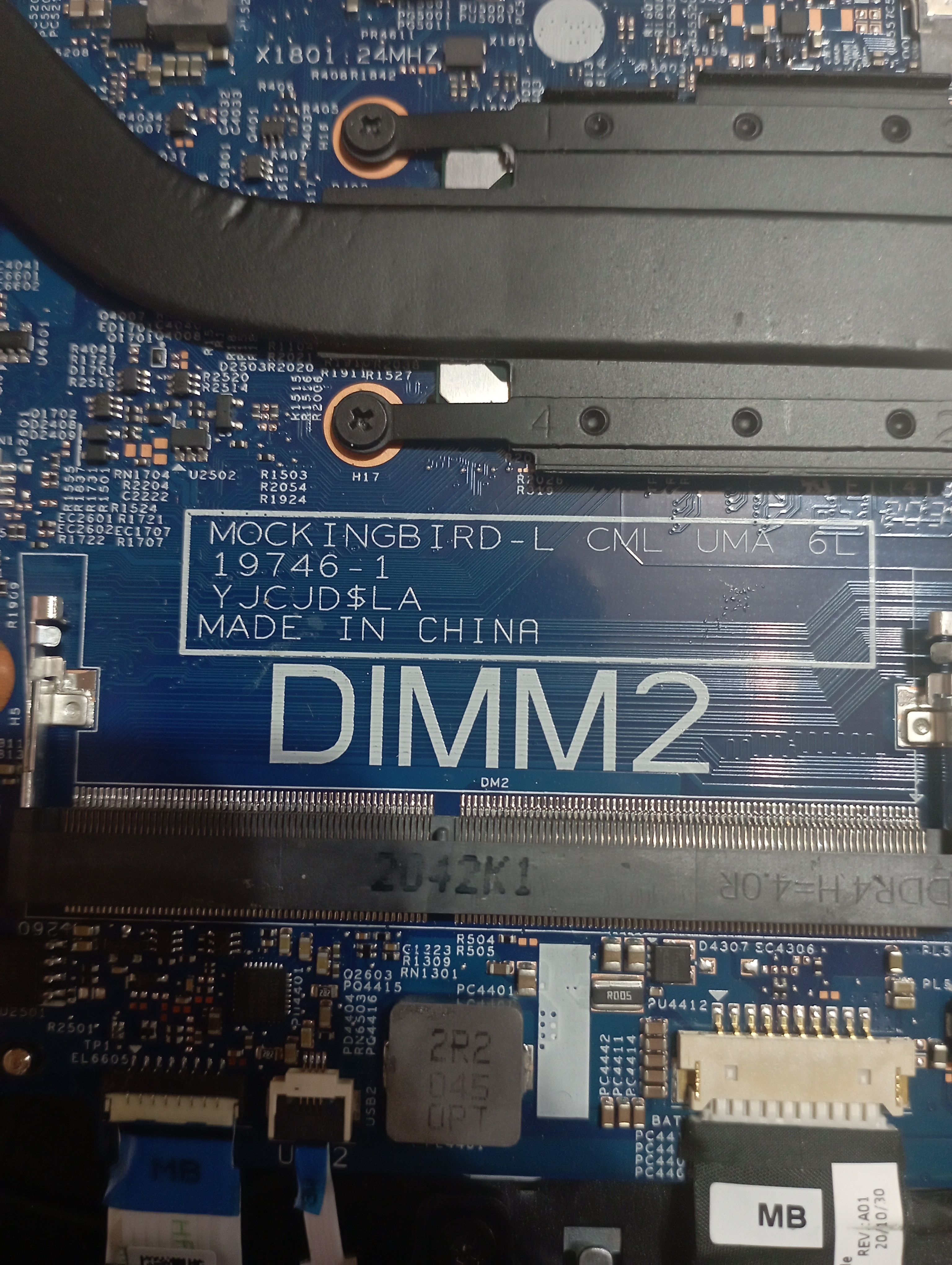

          what is the motherboard? is it MOCKINGBIRD-L CML UMA 6L 19746-1 ?
          • MariusC
            • Aug 2024
            • 6
            • Romania
            #185
            Exactly this one

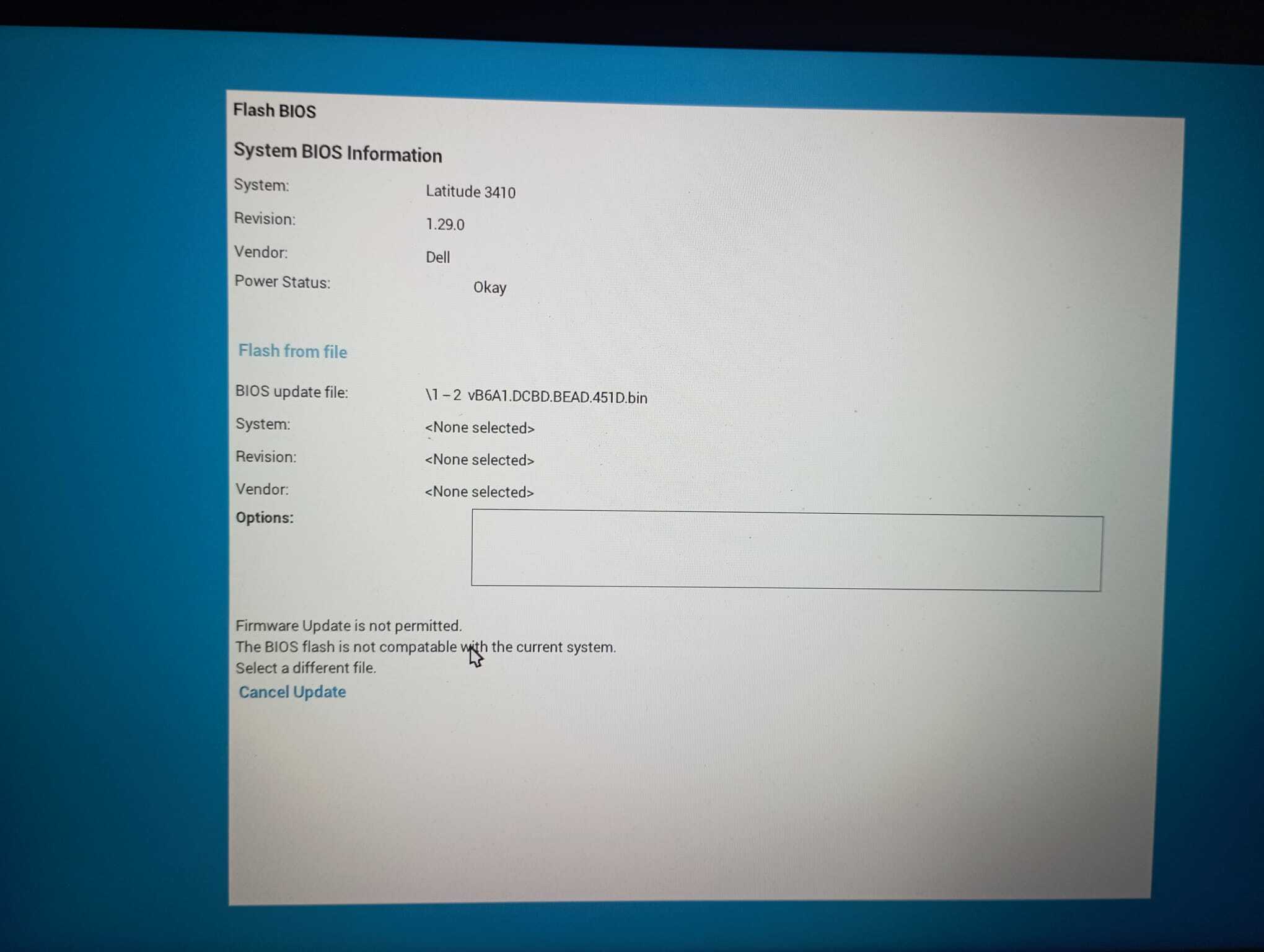

                thank you, which tool should I use to flash this bin files? I tried with a bootable stick and from the bios update device option and it doesn't work.
                • kalilinux25
                  • Mar 2018
                  • 2089
                  • ZAMBOANGA SIBUGAY
                  #188
                  Oh dont flash any bin I though you have take the board out and use a spi bios programmer,
