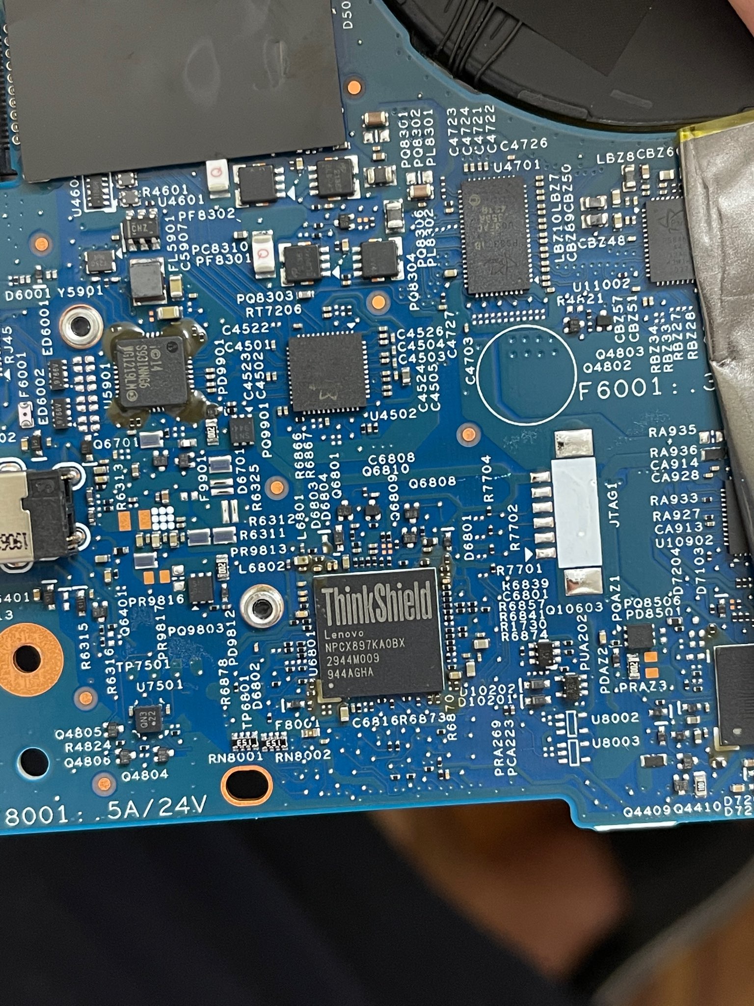

    I am new to this forum and I already apologize for my english! I spent some time trying to find a solution to unblock a lenovo thinkpad x390 Yoga, which probably has, according to a diagram I found online, a NPCE388 Embedded Controller. I don't know much about laptop hardware but whith your help I could maybe manage to do it! In an other thread AAAC wrote:
    "Or if you have an EC/KBC programmer you can READ, ERASE and PROGRAM EC/KBC, disconnect all source of energy for 1-2 minutes, then reconnect and use Lenovo Maintenance Utilities (UEFI version) to enter Model Number, Serial Number and other data.
    As far as I know ThinkPad X390 has NUVOTON embedded controller, so you may be able to program it using keyboard connector on motherboard." (https://www.badcaps.net/forum/showth...=87588&page=26)
    So here are the steps I think I should follow, tell me if that is correct.
    -disconnect the battery and the CMOS battery
    -connect the embeded controller to a programmer via the FPC keyboard connector
    -read and dump the EC, save it in case something goes wrong to come backe to the previous BIOS.
    -erase everything on the EC
    -write the EC with a new bios with the "bios update utility" (is it a .bin file?) from lenovo x390 Yoga (https://www.lenovodrivers.download/l...-yoga-drivers/)
    -boot with Lenovo Maintenance Utilities (UEFI version) to enter Model Number, Serial Number, etc. (where can I download this bootable image and where to find the serial number when the label is unreadable on the back of the laptop?)

                  for x390 yoga nuvoton how to read
                  nuvoton NPCE388PB0BX

                    Use Vertyanov (ideally Original not clones) software 8.2.x on forum not 7.x as this has limitation for 128kB files... 8.2 test version reads bigger dumps (256kB)...
                    Settings for Nuvoton
                    LBB-1 KB_pins=32 LEFT DOWN 05MM FLASH=256 JENK=13 TCK=7 TMS=18 TDI=22 TDO=4 (tested kinoxa)

                      use svod3 programmer . dont need to disassemble the laptop just use the keyboard connector to read the EC firmware . then program with new fresh firmware you find it in the bios update from lenovo website. the laptops with npce microcontroller ar very easy to unlock with svod

                                  Well, with my vertyanov 4.0 36 pin kb connector, i had to use
                                  LBB-X KB_pins=32 LEFT DOWN 05MM FLASH=256 JENK=20 TCK=26 TMS=15 TDI=11 TDO=29
