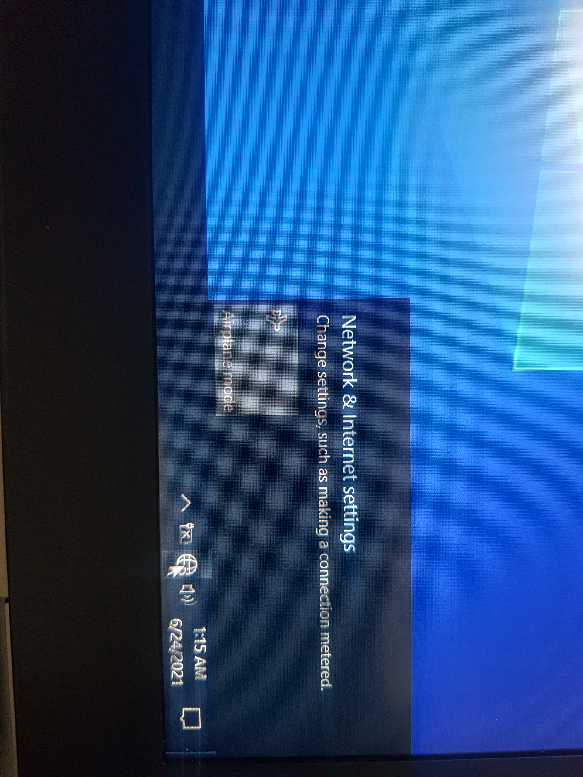

      • onlylove17
        • Jun 2021
        • 60
        • VN
        Re: Hp zbook 15 g6 (daxw2embae0 rev:e)
        Originally posted by peste
        try..
        wifi card no identified
        pleas help me

          • onlylove17
            • Jun 2021
            • 60
            • VN
            post backups to both 16MB and 32MB bios.
            file backup no sounds
            file up new no wifi

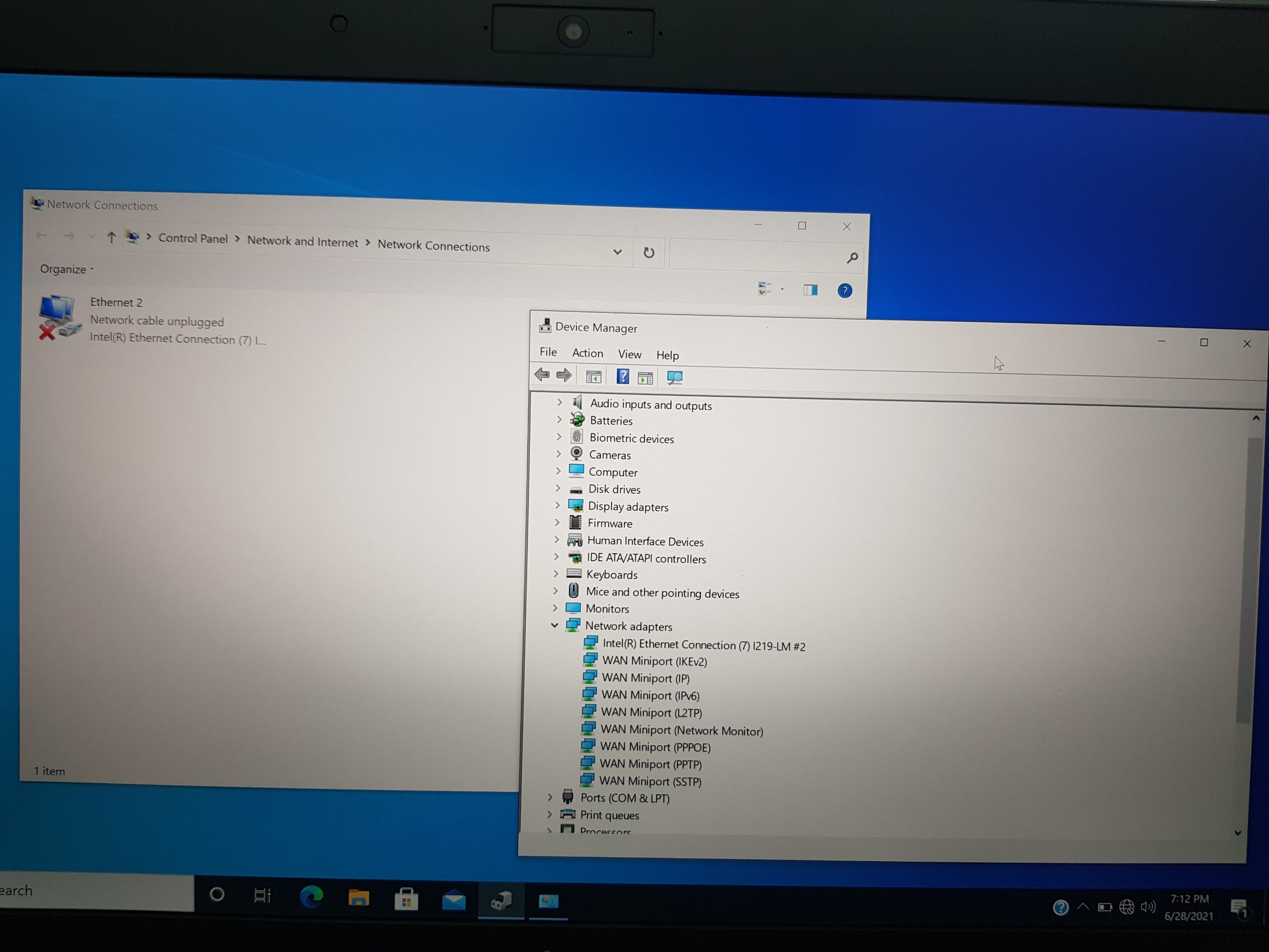

              • onlylove17
                • Jun 2021
                • 60
                • VN
                you still have a 16MB bios chip on the board, look for it on both sides of the board, and post the content here.
                this is my all file original and errors

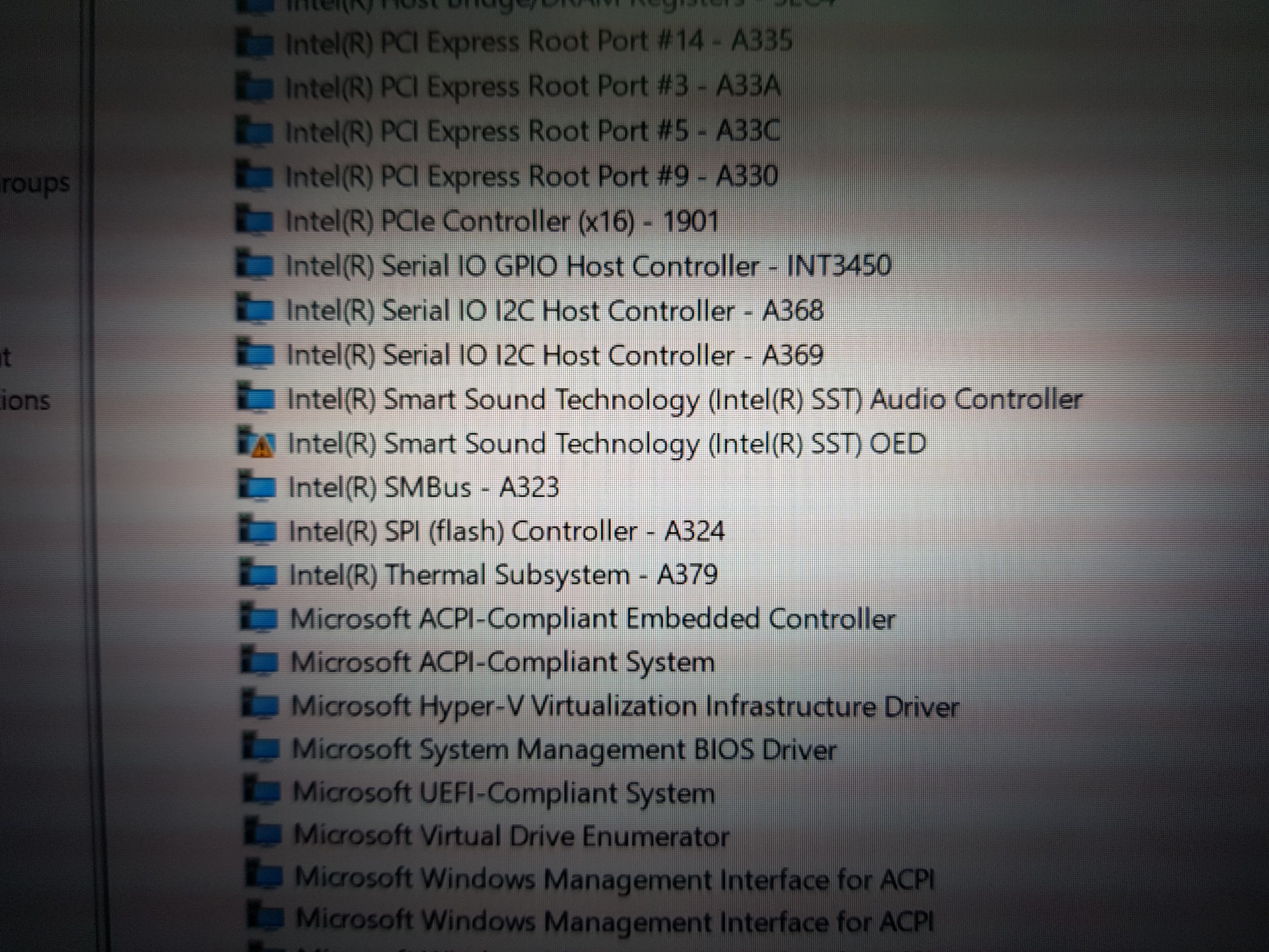

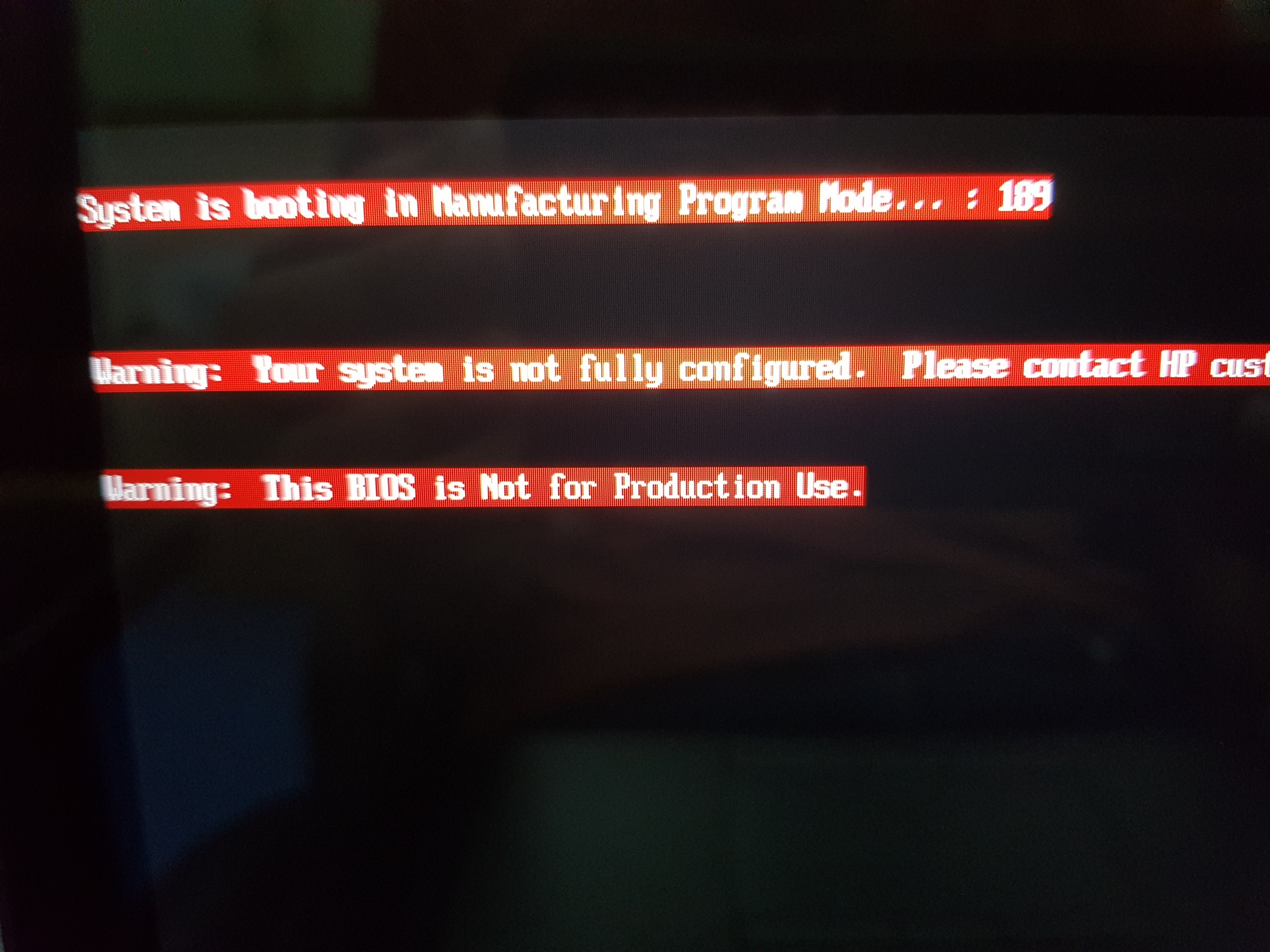

                • peste
                  • Dec 2016
                  • 13183
                  • ROMANIA
                  try..
                  if you have the same message as in picture no. 3 posted by you, enter the DMI information.
                  https://www.youtube.com/watch?v=9T57ktw8n3Y
                  • onlylove17
                    • Jun 2021
                    • 60
                    • VN
                    try..
                    i try again flash BIOS of you. all good, but wlan no active
                    • peste
                      • Dec 2016
                      • 13183
                      • ROMANIA
                      upgrade to lan drivers.

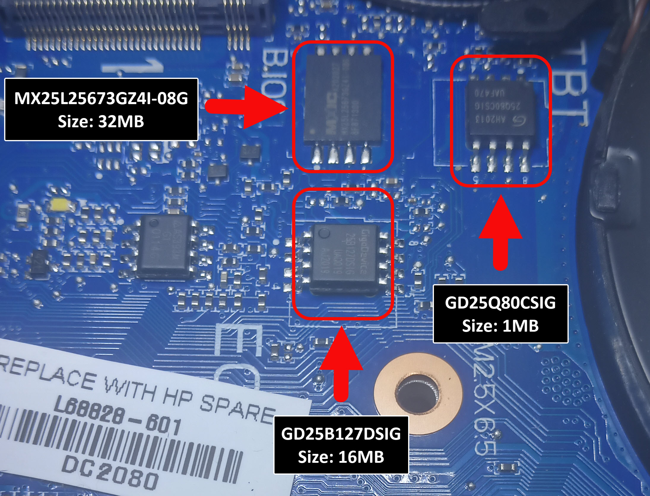

                          Size ICs:
                          BIOS "MX25L25673GZ4I-08G" -> size: 32MB
                          EC "GD25B127DSIG" -> size: 16MB
                          TBT "GD25Q80CSIG -> size: 1MB

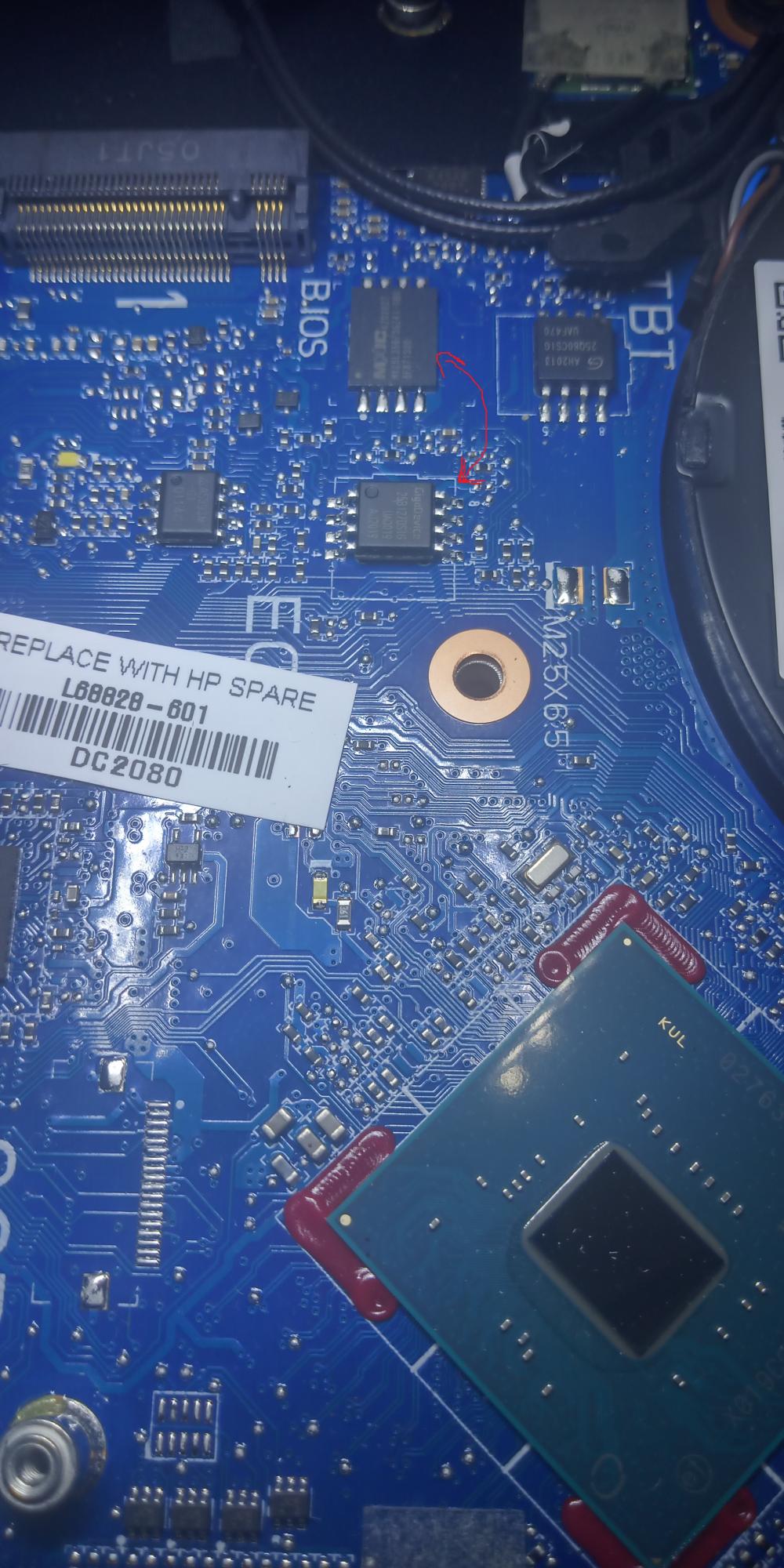

                                • jayjayuk
                                  • Nov 2013
                                  • 16
                                  • United Kingdom

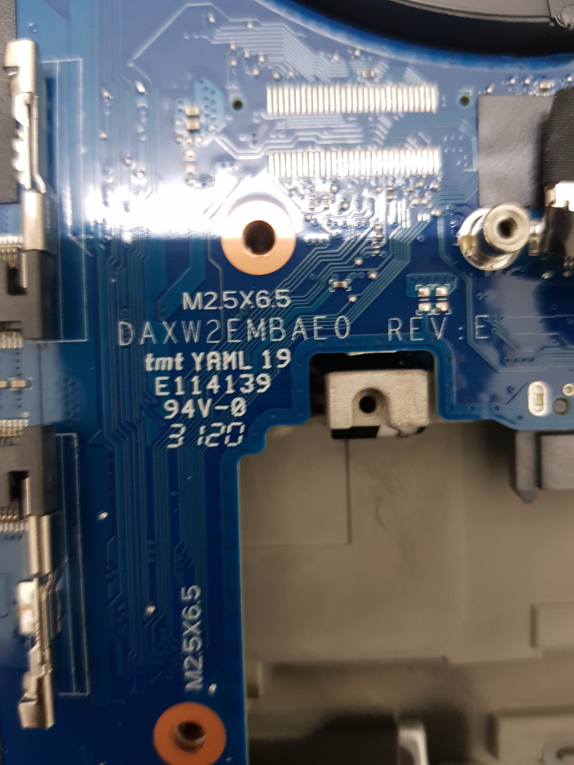

                                  Anyone have an image of this board with bios chip removed please? or a schematic?
                                  Managed to remove the pads on one side. doh

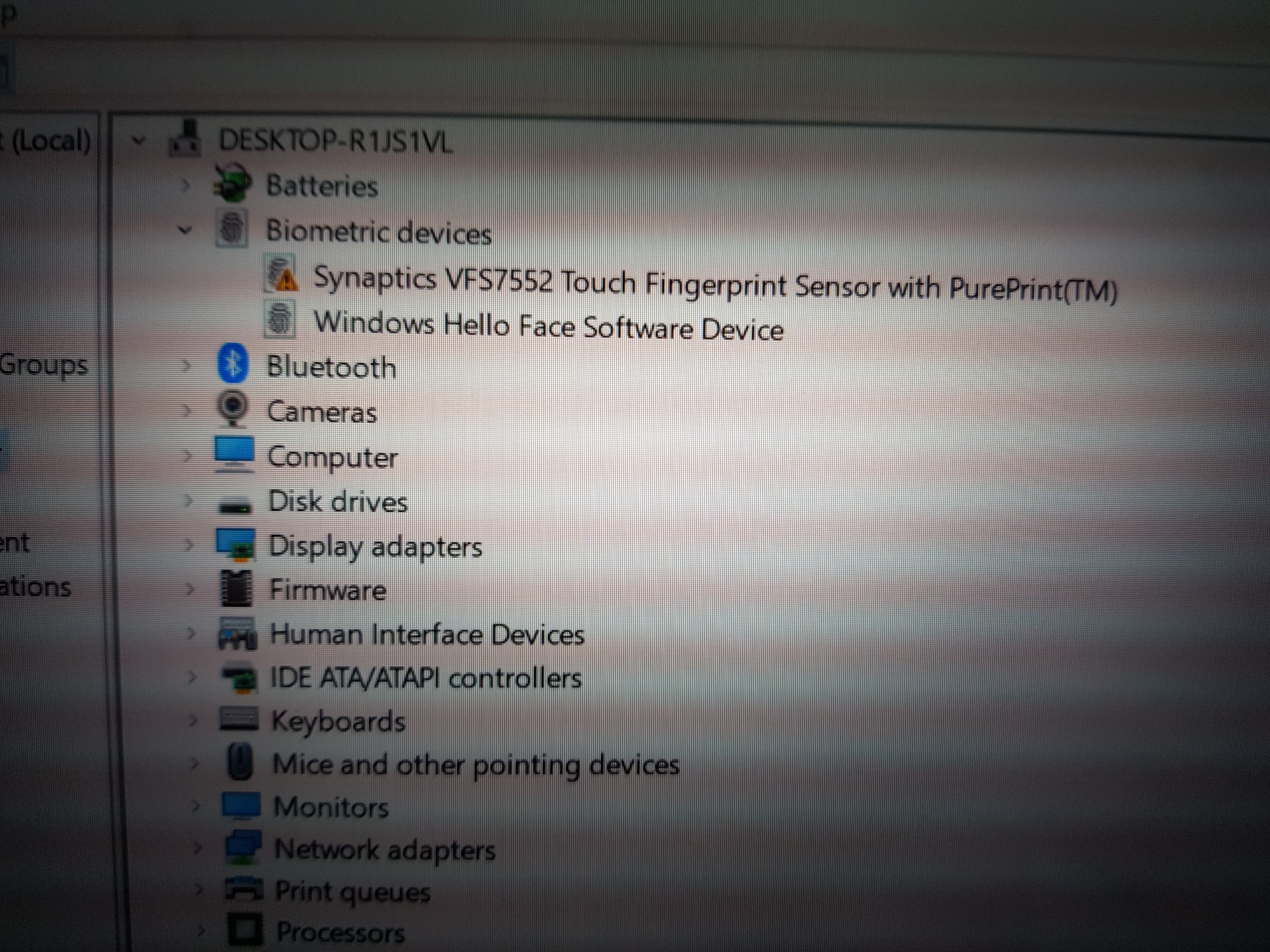

                                  • user212dan
                                    • Jul 2017
                                    • 23
                                    • Bulgaria
                                    Hi, i have :
                                    Hp Zbook 15 G6
                                    S/N: 5CD94876HF
                                    CPU: SRFCN
                                    SKU: 6CJ05AV
                                    GPU: NVIDIA N19P-Q1 -A1
                                    After removing the password ( I didn't save old files ), I have two problems :
                                    1 : I don't have Audio
                                    2: when using Intel FIT v14 I get error : "Unable to open file: ***** ZBOOK15g6.BIN. Reverting to default configuration. "
                                    so I can't build clean ME file
                                    can someone provide working v14 tool ?
