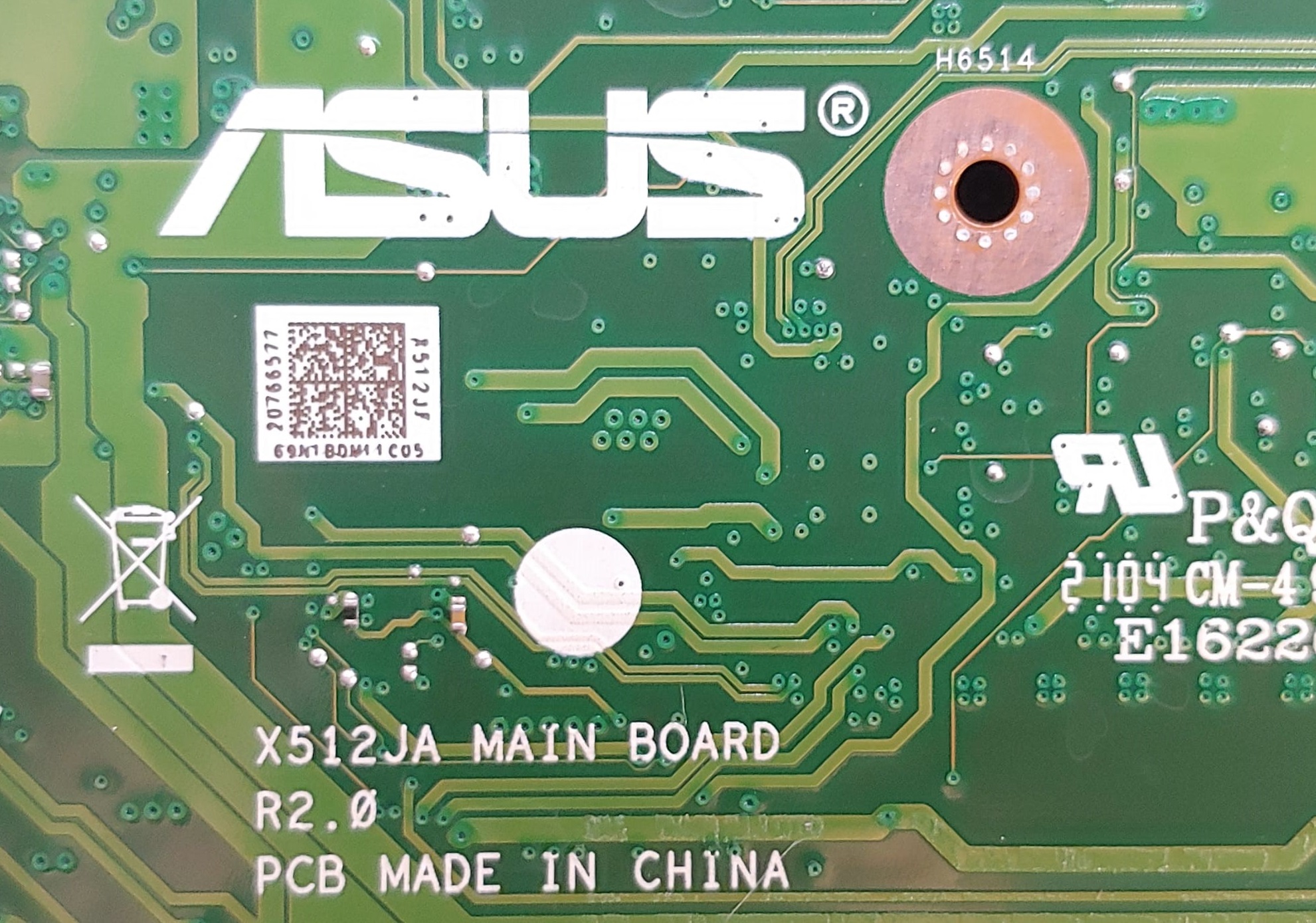

                  Post a good clear picture of the square white QR code ,its just above the "X512JA MAIN BOARD" silkscreen
                    thank you
                      • 20938
                      Re: x512ja r2.0 dump bios
                      Originally posted by rager007
                      thank you
                      On the motherboard ! like the one at post #1
                        ok
                          • 20938
                          ok
                          Try this one .I think the QR sticker says X512JF ,its a bit blurred the printing is a bit off.
                            Thank you yes qr code X512JF

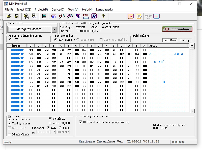

                            I wrote no image // 0.95 * 0.96 draws amps unfortunately it didn't happen

                              Try writing the bios with Quad enabled. QE=1 .Does your programmer support setting the QE bit
                                minipro 866cs

                                  The 2nd picture QE9 is enabled.If it doesnt work after that maybe the problem isn`t with the bios ?
