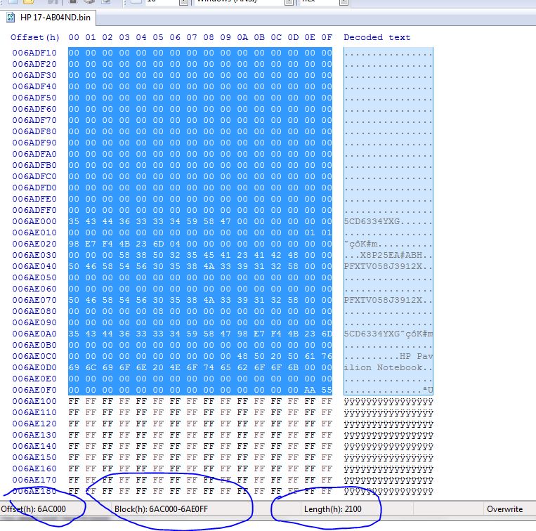

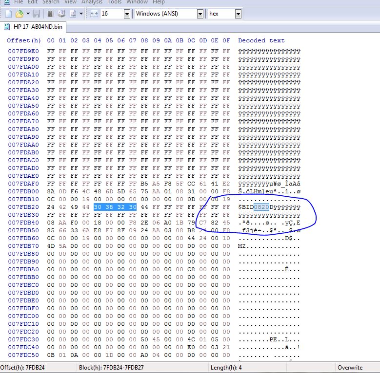

      Go to the support site,enter the serial number,then download the bios. https://support.hp.com/gb-en/drivers...62?sku=X8P25EA .Run the exe,it will give you the option to make a recovery key.If running the recovery key doesn`t work run the exe again and select the copy option (or copy the bios from the recovery key) .There are 3 different bios to choose from, so open your bios backup with a hex editor to find out which one you need.Use the hex editors text search, and use the keyword BID or each bios name.
      HxD hex editor: https://mh-nexus.de/en/hxd/
      Search for the serial number using the text search, 5CD6334YXG .Copy the DMI information from 6AC000 - 6AE0FF to the virgin bios, and copy the win key from 278000 - 27803F to the virgin bios.
