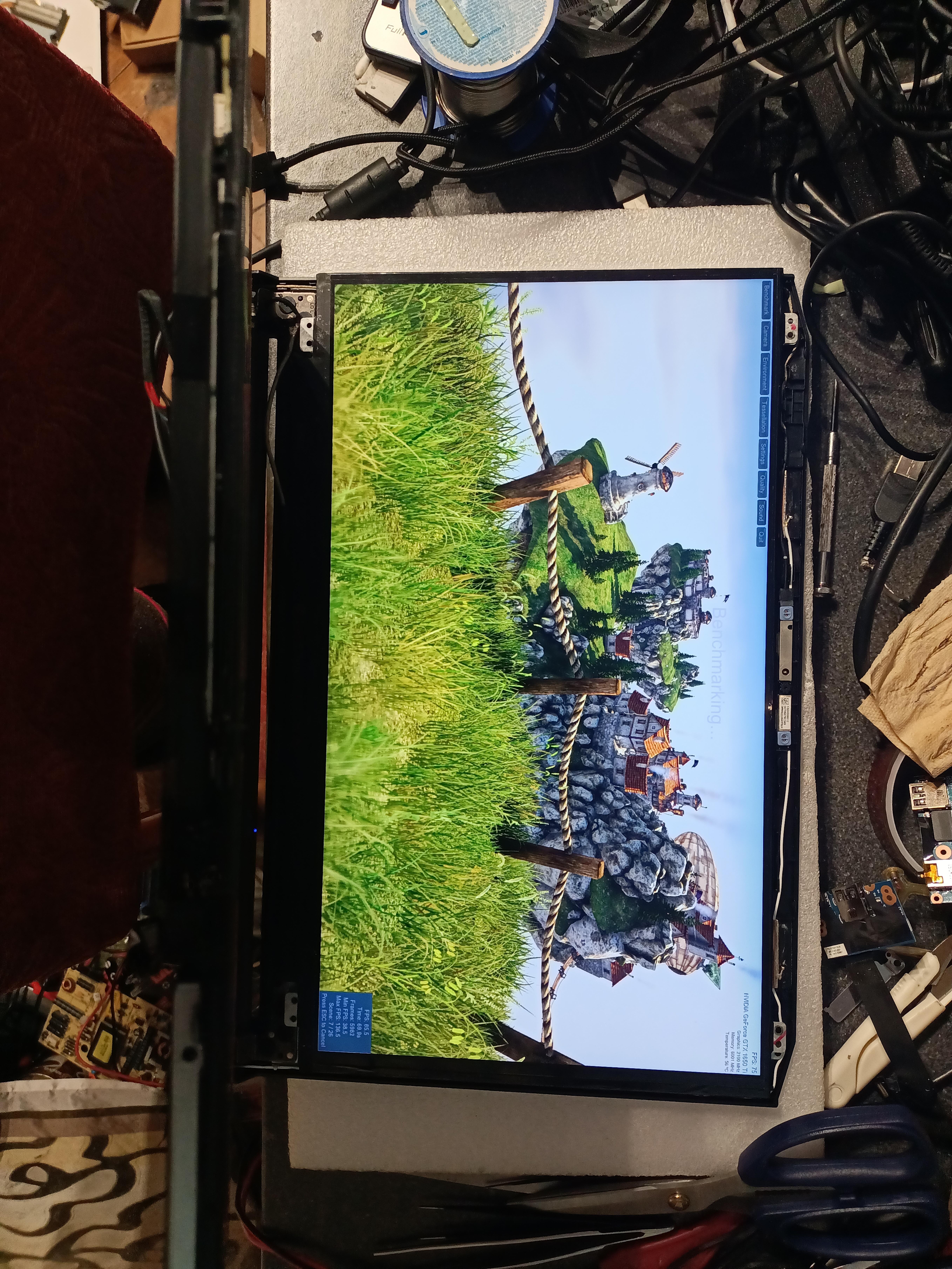

                          Hi,i need some help with bios.Fans full speed,no post,no caps,voltages ok,i think its not original bios,or its corrupted,can i ask for a new cleanme bios?Thanks.

                          • volinakis
                            • Jan 2021
                            • 2871
                            • N/A
                            Acer AN515-44-R0XU
                            SN: NHQ9HEX00S05201E5D3400
                            Model: N20C1
                            CPU AMD Ryzen GPU GTX
                            Motherboard: FH51S LA-K181P Rev.1.0
                            1st: AMD platform laptop does not have Intel ME_Region so it can't be "cleanme".
                            2nd: your bios backup has errors, look at compression 16,8MB to 1KB. Read bios chipset again, 3-4 times and compare results, when you have 2 identical it means you have a good backup.
                            • pityulix
                              • Nov 2021
                              • 30
                              • Targu-Mures
                              Thank you for respons,i fixed it,replaced the bios chip,now working fine.
                                Thank you for respons,i fixed it with other bios chip,i made some mistake when i saved that bin,now its working fine with new bios chip.Thank you anyway for your time.The bios chip works with 1.8V,succesfully burned it with 3.3v programmer,changed with other and programmed it with 1.8v,probably when i tried to save the bin got faulty,next time i will be more carefull(i'm learning) πŸ™‚
