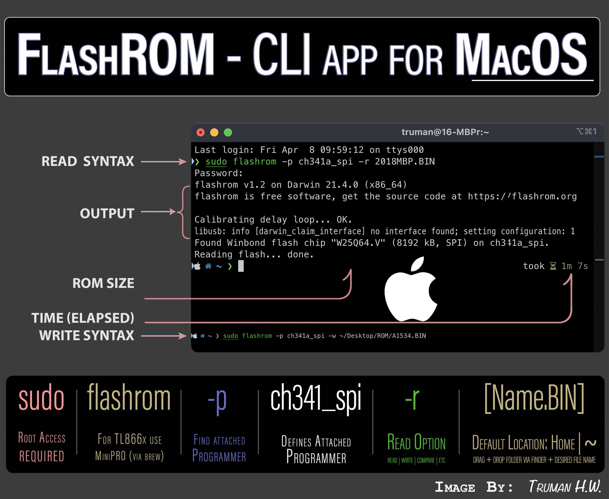

                          I'm not sure if it's old news or not, but I had looked for a USB driver for MacOS so I didn't have to use a damned PC to Read / Write ROM .bin files ...
                          I'm using an application? I think it's an app, anyway, a CLI app (via HomeBrew):
                          FlashROM (.org if you want to read about it) ...
                          Code:
                          SERIAL -to- USB - CH341 ROM (MacOS):
                          Install xcode:				xcode-select --install
                          Relocate xcode:				[SIZE="1"]sudo xcode-select --switch /Library/Developer/CommandLineTools[/SIZE]
                          Install HomeBrew:			[SIZE="1"]/bin/bash -c "$(curl -fsSL https://raw.githubusercontent.com/Homebrew/install/HEAD/install.sh)"[/SIZE]
                          Install cask:				brew install cask
                          Install Ruby:				brew install ruby
                          Install FlashRom:**			brew install flashrom
                          List Programmers:			sudo flashrom --help
                          Verify reader:				sudo flashrom -p ch341a_spi
                          ROM Read:				[SIZE="1"]sudo flashrom -p ch341a_spi -r  <name.bin> (defaults location ~ )[/SIZE]
                          ROM Write:				[SIZE="1"]sudo flashrom -p ch341a_spi -w  <name.bin> (defaults location ~ )[/SIZE]
                          IF you had a TL866* [eg: TL866II+, etc] instead of the listed USB Programmers in the attached image for CH341a (as I used, but, as also the T203 and T200 programmers are, which is why I think FlashROM is a wise installation irrespective which programmer you own if reading this thread)...
                          In ADDITION to FlashROM ... perhaps you'd also:
                          Code:
                          Install MiniPro				brew install minipro
                          Whereas the FlashROM application's supported programmers are manied and being added (you can look at the changelog on flashrom org to see their revision history) ... MiniPro does JUST the TL866x and appears to have no plans of adding anything to that "list."
                          Obviously if you already have HomeBrew, XCode Tools, Ruby, etc., installed, you'll just be reminded of that if you attempt to re-install them.
                          I can PM you a link to my Paste Bin of the commands if preferred.

                          Attached image shows the command used to Read via my CH341a
                          Pending which $PROGRAMMER you're using, just sub the above 'term' for the corresponding model you have.
                          Hope that's what you thought I meant; I feel stupid now, learning about two different USB to Serial Programmers which have CLI (Bash) applications that obviate the use of a fcuking MISERALBE ass Windows-PC for a Mac ... and worse..? The only damned application that controls the CH341 R&W on a PC has a HORRIBLE HEX / ASCII editor. I'm literally ELATED to have found a solution ... for 8 fcuking YEARS I had repeatedly tried the "DRIVER" that FTDI put out for the CH341 ... with every version of MacOS possible, none-of-which worked! But this !?? In 2-seconds ... and it's been VERY reliable.
