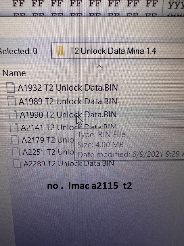

              • Djamalhan
                • Dec 2021
                • 79
                • Узбекистан
                #87
                Re: T2 Chip Programmer Tool
                Originally posted by Stephen
                https://www.badcaps.net/forum/showthread.php?t=101283
                From now on go here if you want help for unlocking
                Hey ! I am not kidding .
                What did I do .
                1.read rom 4 mb a2115
                2.changed sn
                3, write rom back.
                4.first Imac DFU mode
                5.run minaT2Activator.app
                6.After all SSH error.
                • curiositymaster
                  • Apr 2021
                  • 45
                  • Nigeria
                  #88
                  What did I do .
                  2.changed sn
                  3, write rom back.
                  If you getting SSH error, it means your BridgeOS is version 6.0, which means the mina software will not be able to bypass your device. You need to wait till a new Checkrain jailbreak software is released, which we're all expecting should be able to jailbreak this latest BridgeOS version.

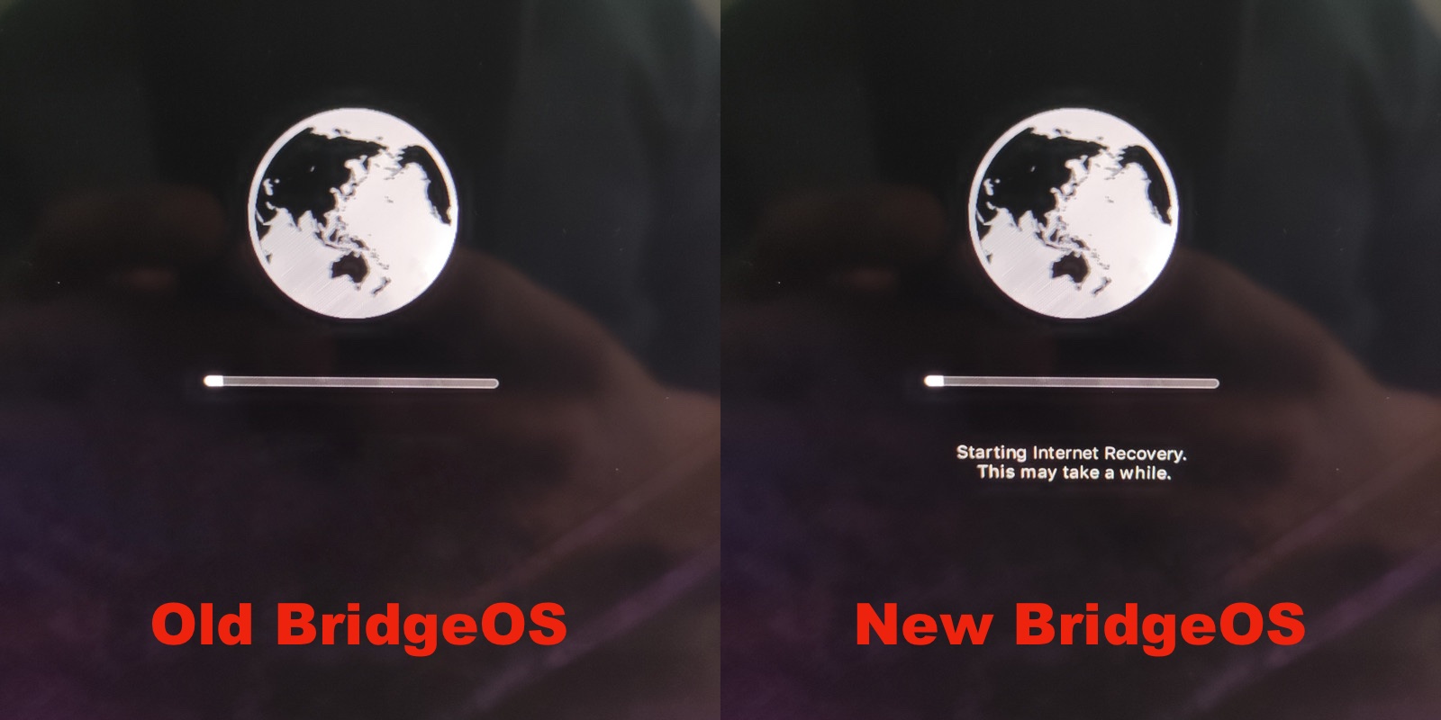

                                        #99
                                        Before changing anything you need to know if your T2 is jailbreakable or not, else you will just waste your time and efforts.
                                        You can only jailbreak upto BridgeOS 5.5 nothing above it for now, atleast publicly .
                                        The simple method to check for old or new BridgeOS is put device in internet recovery, connect WiFi and compare it with the following image.
