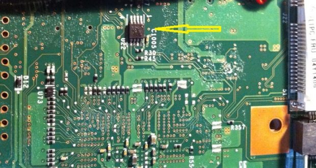

    Hello!
    Sometimes I see a Lenovo laptop with two BIOS chips like the T430. One is 8MB and the other is 4MB. The autopatcher for this BIOS cannot create a patched file with which I can unlock the BIOS. I also tried to merge the two files, but then it doesn't work either.
    T430 is just an example. , I come across several such laptops. How could these be unlocked?

    Re: Unlock Lenovo with "dual" chip.
    The password in chip 24RF08/P24s08.
      Patch method is supported from T440 so you are messing with the wrong problem.
        Flash this bin file and bios has unlocked? For other laptops, how can I make such a bin file?
        The T440 has 1 chip(16MB) if I remember correctly what the Lenovo autopatcher can patch. I'm still a beginner, I only know this method.
          flash with this file and your laptop is unlocked 😃
              Serial and other info is not lost? On another laptop, if I read this chip, how can I clear the password?
              Upload your backup for chip 24RF08/P24s08
                    this is my backup for chip 24RF08/P24s08 it is password locked
                    if i use the public bin that is available in laboneinside i will get access to bios but i will have the 0189 error RFID misconfiguration
                        Do the tweezers short method on the 24RF08, you can find it on YouTube. It's tricky but it is known working if you do it right, I've unlocked a few myself.
