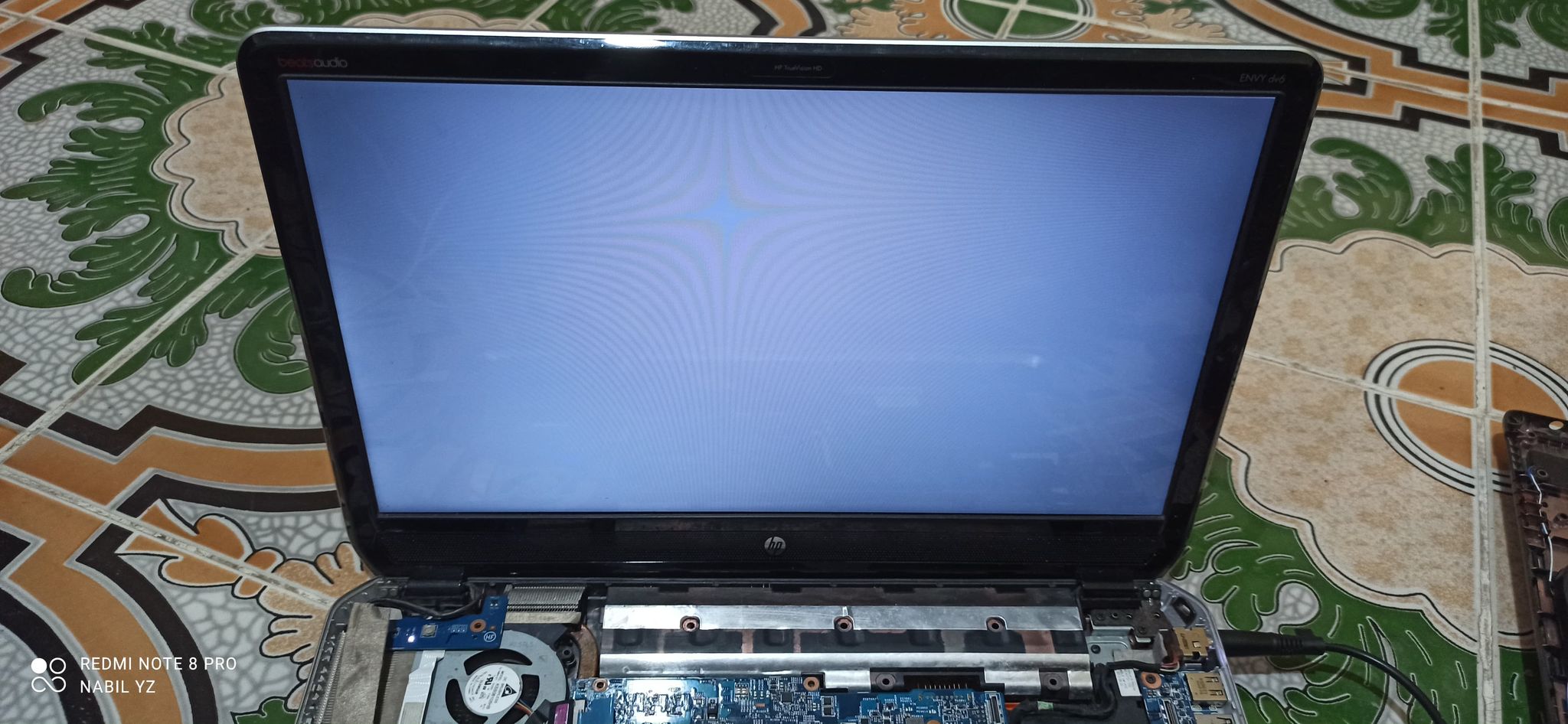

    need bios for hp envy dv7 7360sf
    need bios Goya/Balen 1.0 DDR311254-3
    idid all ready did try the bios that i found in this forum thx

    Re: need bios for hp envy dv7 7360sf
    Try..
      i did flash with it and when i strat the laptop he show flashing block and after he only back light and no data but caps boutton work
        post the backup of the bios
          i dont have it unfortunately
            i did take this backup from another laptop it start but he stuck at cmos battery press entre
              try..
                the bios work fine the probleme is when i enable legacy booot and disable secure boot the probleme start to happen again
