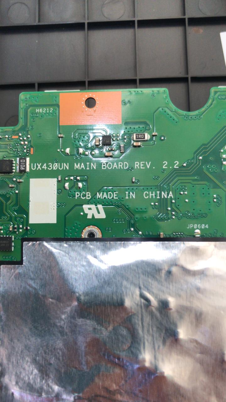

    Asus ux430u bios password please
    Hello friends I have an Asus ux430u, with bios password I tried pressing Alt + R it does not work it does not show any date, could someone help me?

    post the backup of the bios

      This is the friend file

        Re: Asus ux430u pcb p/n UX430UN REV. 2.2 Bin Ok.
        I upload the clean file, in another forum they cleaned it for me and it is 100% operational.

                    • 21164
                    Re: Asus ux430u bios password please
                    Originally posted by m3mo3y
                    i think it's not easy and i'm ruining it. If you can help me i appreciate it. Thanks
                    3793d3267fba0d4daae04d741307b99a062e8ec1e95444e89f7bfa0e55a2b0350bc9665cc1ef1c83 <- remove space between f and 7
                    5b93b62611ba6c4dc7e022747d07d89a332e8ec1e95444e89f7bfa0e55a2b0350bc9665cc1ef1c83 <- remove space between f and 7
                    HxD - Freeware Hex Editor https://mh-nexus.de/en/hxd/
                      Hi!!
                      I have tried and did not work so well, password can not be removed. if you have time you can fix it. thanks
                        Originally posted by Mobilmaster
                        Hi!!
                        Pess F3 to find next Amitsessetup block.
                          Hi!
                          The second block I didn't found and I checked all the options. The first is there and I wrote FF instead of the first block
                            Hi!
                            Write 00, not FF or post your bios here.
                                thank you for ur help
                                Password : lenamona5
                                  Hi
                                  I want to thank you so much.
