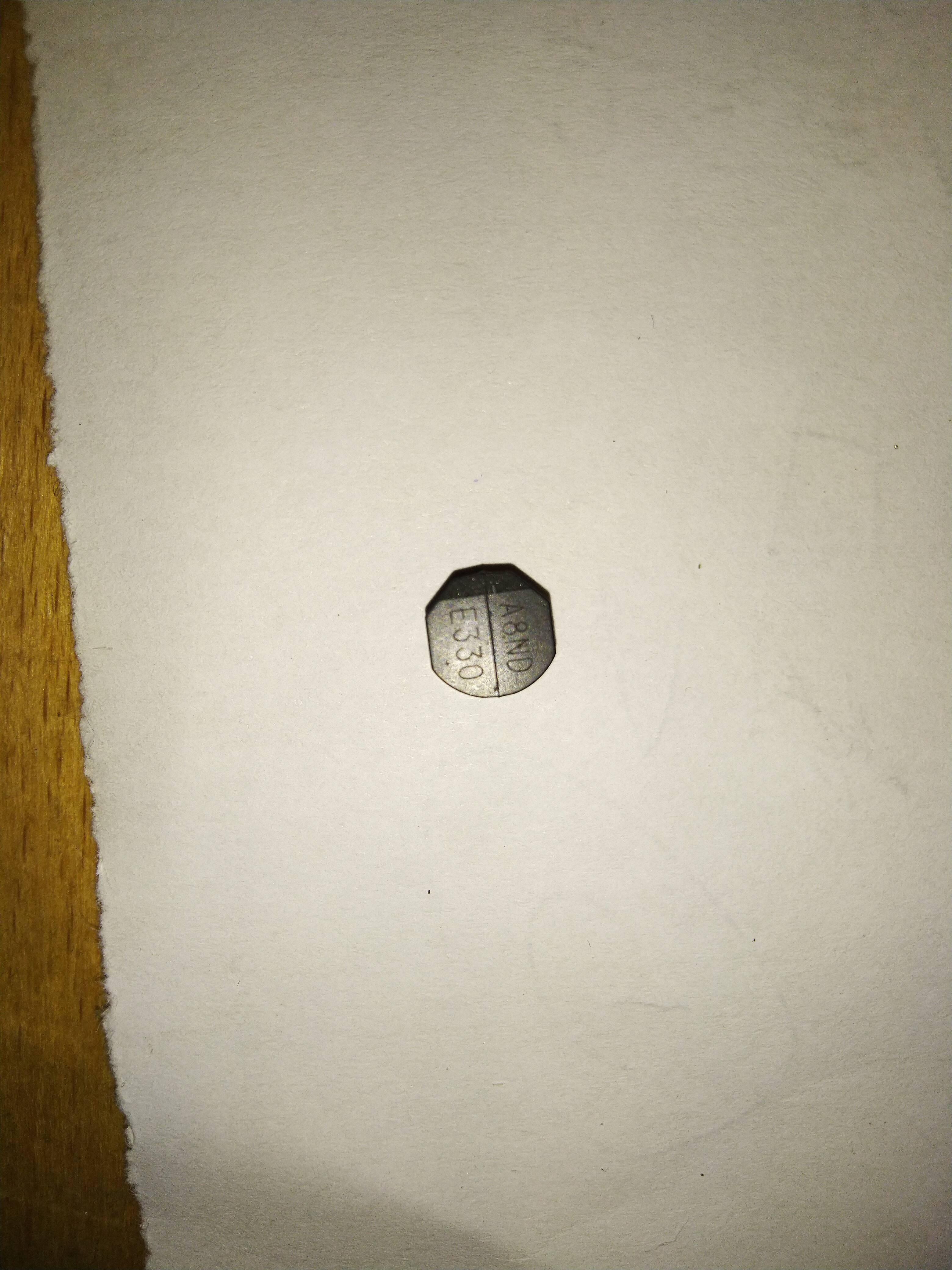

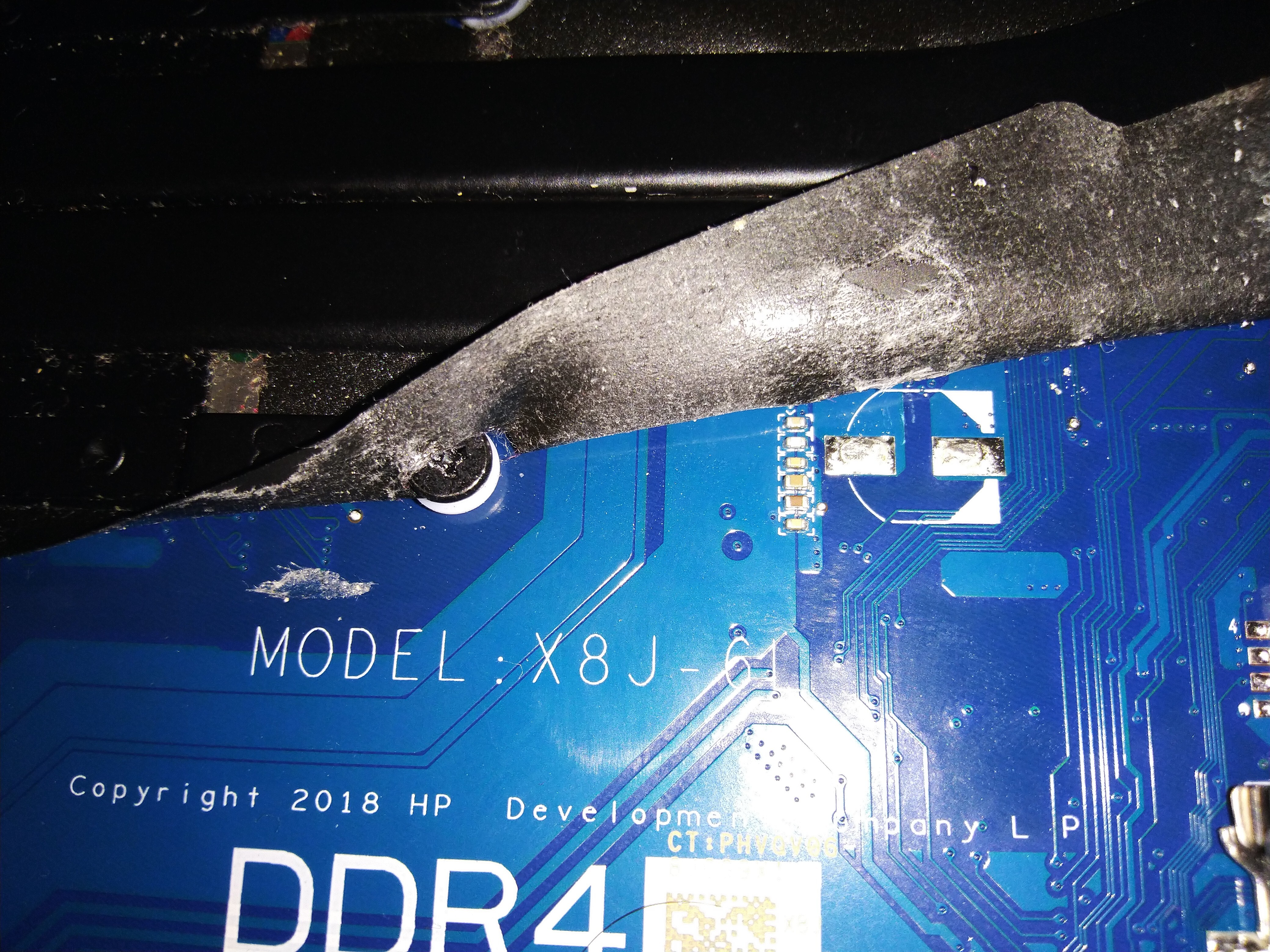

                                      Flashing ok , no error all success but when i return back to my laptop to power on it : just blinking orange led (led near power connector).
                                      BUT : i just discover that !!!!!
                                      and that ... :-((( : chip marked as A8ND/E330 ...
                                        use this flash diretly. make sure check that see in picture before flashing..
                                        then solder back that capacitor make sure the polarity is correct.
