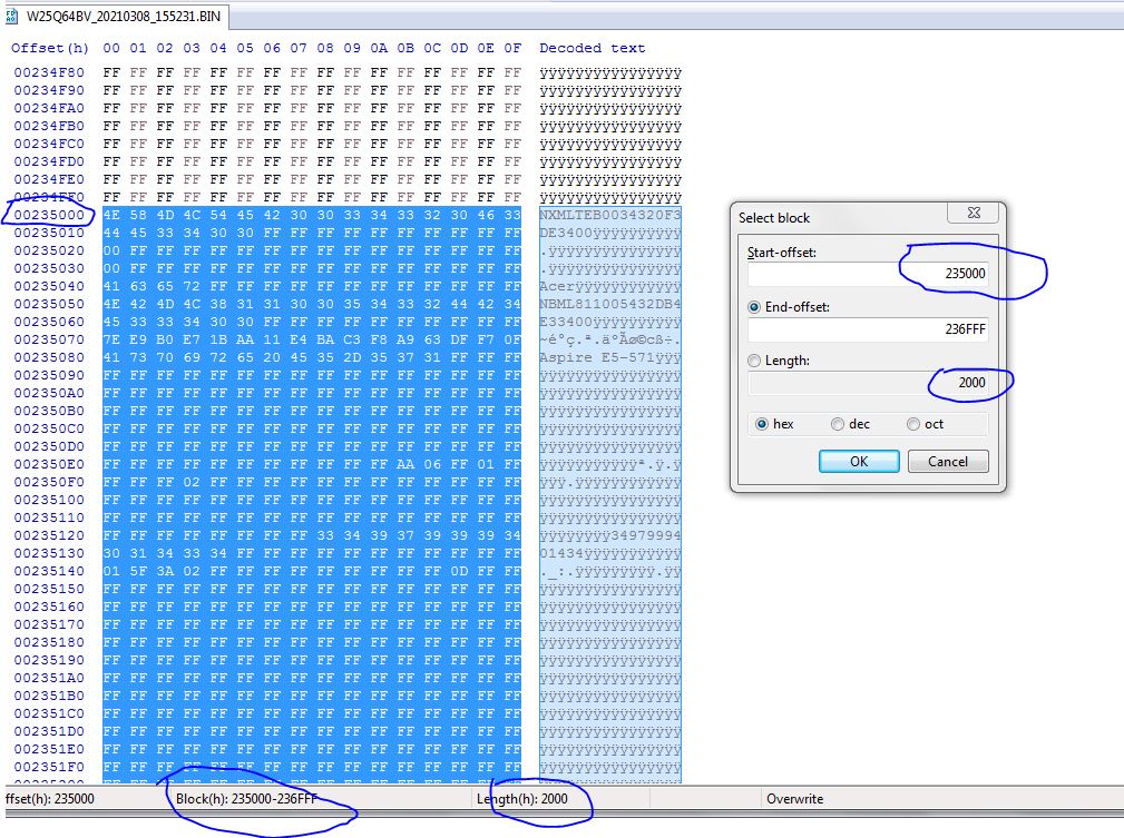

              Z5wah la-b161p rev:1.0 bios dump
              Hi please someone have a working bios for acer
              e5-571 74ys
              mainboard : Z5wah la-b161p rev:1.0
              snid 43206243034
              this is my backup
              i have tried some dumps from here but still the same
                • 22009
                Re: Z5wah la-b161p rev:1.0 bios dump
                Here post #5 by @peste. https://www.badcaps.net/forum/showth...ighlight=Z5WAH .If you want to use the DMI from your backup use a hex editor, @peste has given the areas in hex where it needs copying https://mh-nexus.de/en/hxd/
                • ismaelstepheno
                  • Jun 2020
                  • 231
                  • UE
                  Thank you very much smdflea and to peste too
