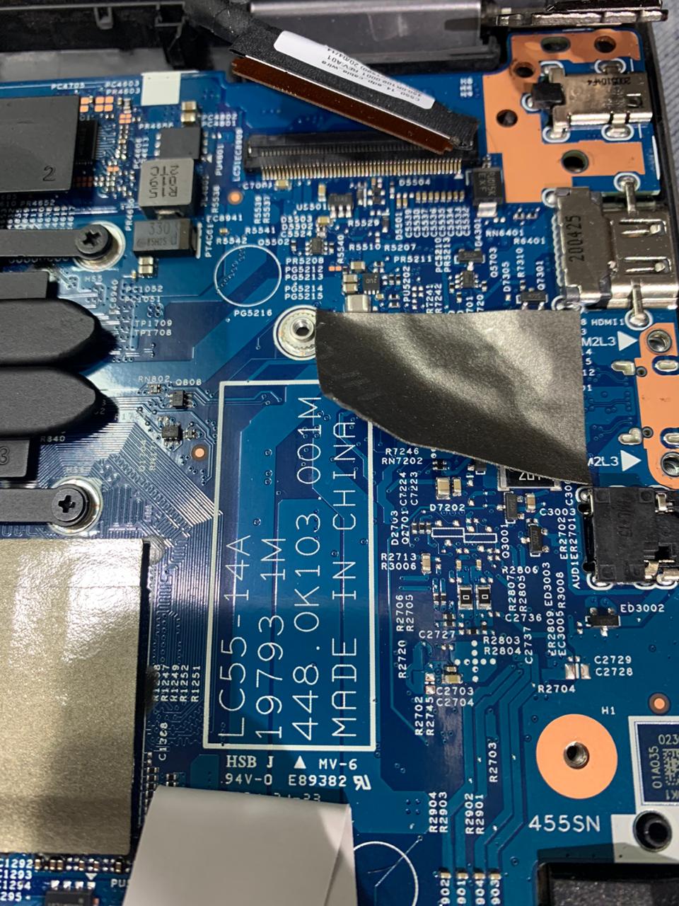

    hai all
    any one please help me
    i need bios for lenovo Flex 5-14ARE05 Laptop (ideapad) - Type 81X2
    board id: LC55-14A 19793 1M
    i have my no display backup but file is currepted
    thanks

    Re: lenovo Flex 5 bios need
    try newly build bios from lenovo support site
      Originally posted by uvaiz
      hai all
      thanks
      bios extracted from the Lenovo site update.
      DMI B21000 - B213FF
      KEYWIN B10080 - B100BF
        Than you gentleman.
        It's working fine but how to update serial no in bios.
                Hello someone can do a tutorial to fix it
                I used ch341a and AsProgrammer and my bios chip serial is GD25LB128DSIG and I worked with GDL12Q... 1.8v
                I erased my BIO, and program the new BIO and doesn't work
                I have a black screen 😣
                  do not use the clip because you may have errors, remove the bios chip from the motherboard before reading or writing, if you do not have an adapter, solder the chip to the programmer, if you have nothing to remove it, solder wires between the chip and programmer..
