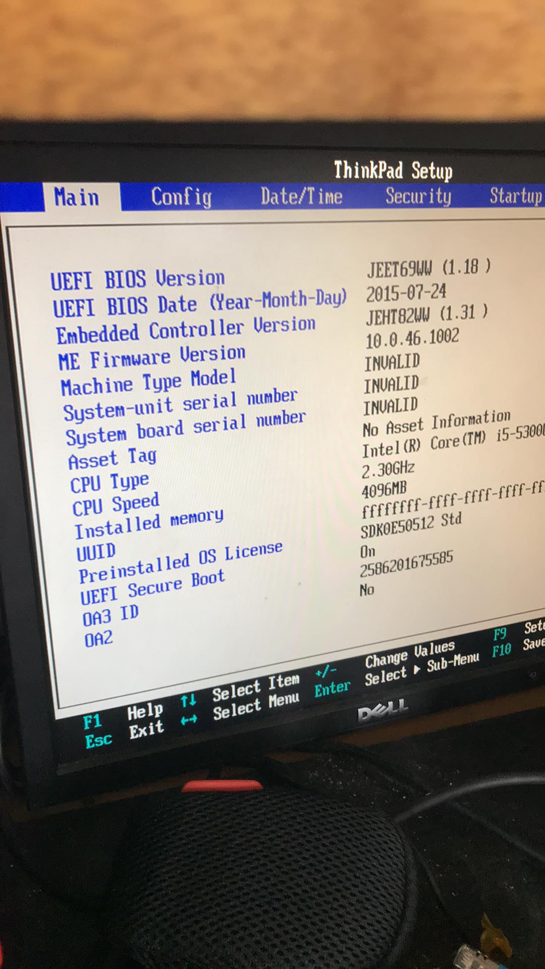

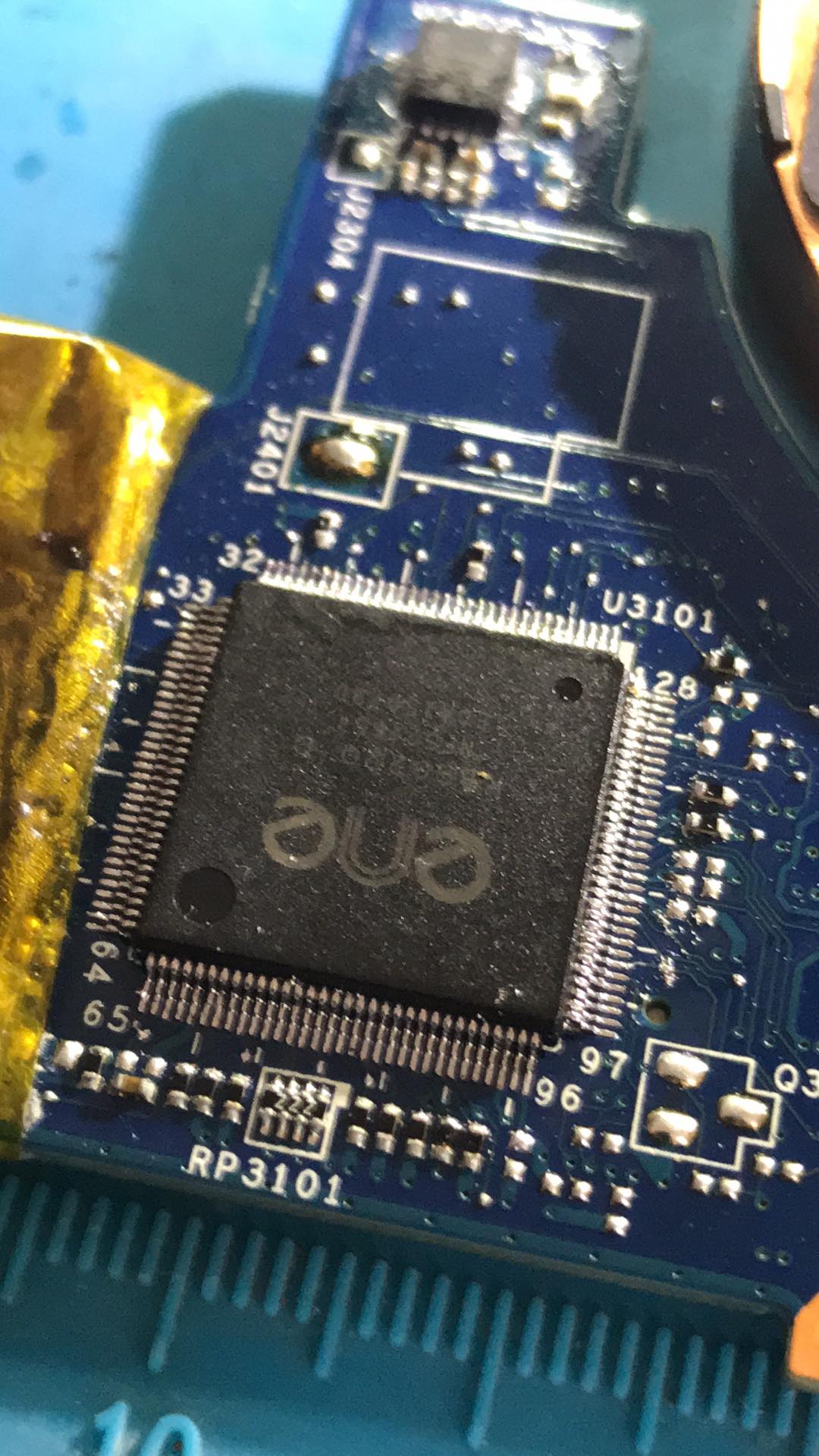

                                hi,
                                NEED CLEAN EC (Password )
                                Zips3 la-a342p rev : 1.0
                                SER#
                                B0 SB20F65736C1KS5AGG3Y4
                                C0 S20DKS0A900MP10CSPN
                                First time for me with that
                                read with RT809F with adapter Kb9012
                                I hope reading will be good.
                                Isn't it easier to do that?
                                Veritanov or via keyboard cable on rt809f or isp
                                I still have trouble with these tools.

                                  Re: please patch this ThinkPad S1 Yoga 12
                                  while looking, I found this
                                  It's OK now
                                  just need reprogram serial and others with LENOVO diskette
                                    I still have a problem, I can not put uuid and rfid.
                                    must modify the bios and put clear these bits to be able to rewrite ??
                                    • Maxpower3
                                      Bad Veteran
                                      • Feb 2018
                                      • 1248
                                      • France
                                      Edit: SOLUTION FIND
                                      DON'T USE FILE WITH PDF
                                      JUST REPLACE 0x200 to 022F on your original EC Dump
                                      no lost UUID ,serial and others numbers
