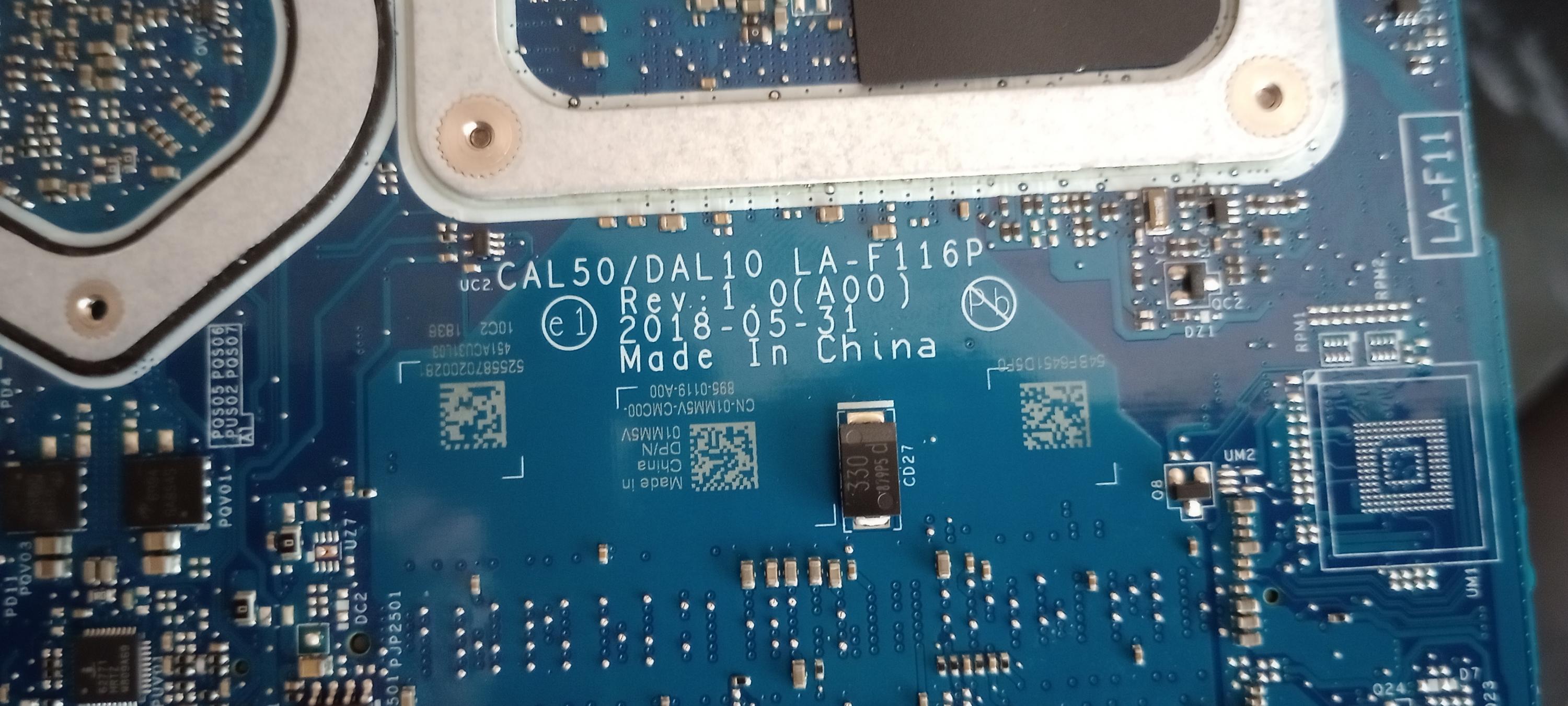

          I don't have original bios , CAL50 DAL10 LA-F116P REV 1.0(A00)
          Dell Inspiron 15 5570
          Black screen , fan going at full speed ,led blinking 2 amber and 4 white
          Charging working , keyboard light

            Does your motherboard have a bios chip?

              Yes , programmer CH341, chip GigaDevice GD25Q128B.

                Read that chip and post result file here.

                    Bios you posted is configured meaning it has never run and therefore not initialized. No DMI extracted, no winkeys. Try the latest from Dell Update.

                      Im flash that image , im try different ram , leds not blinking , screen is black and fan runing at full speed and stop for one secound then full speed and next .
                      Im you don't know where is problem ...

                          The bios that's extracted from dell will not be a full image, you should upload your old bios file.
                            Sorry , im dont have a original bios , im lost it ,im try all this bios uploads in this page for LA-F116P , afater fashing , black screen , fan run , stop , run ,stop ...
                            may be there is different problem , no bios

                                Tx , but same reslut, black screen , fan run ,stop .., no error led codes , charging working ...
