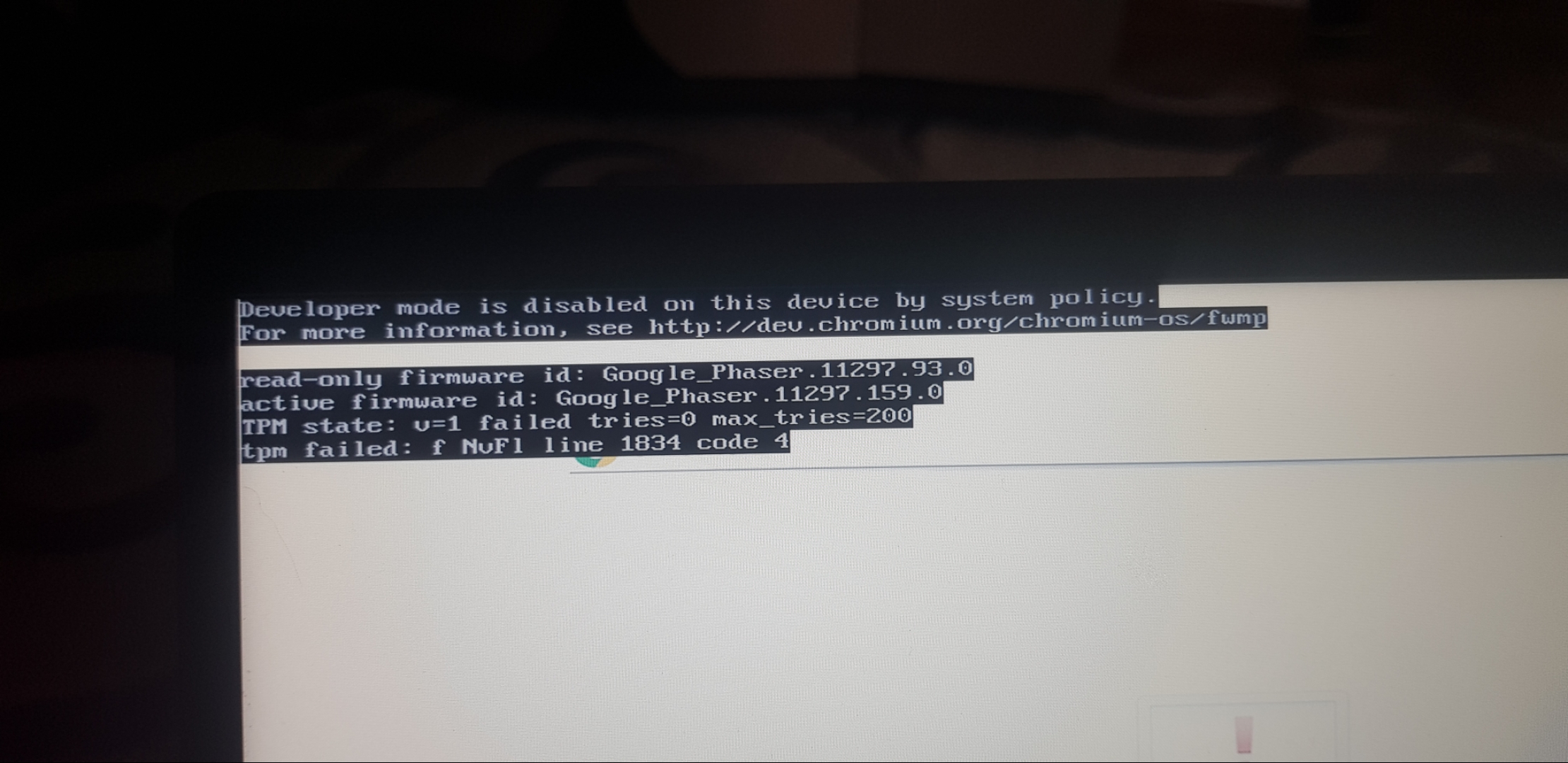

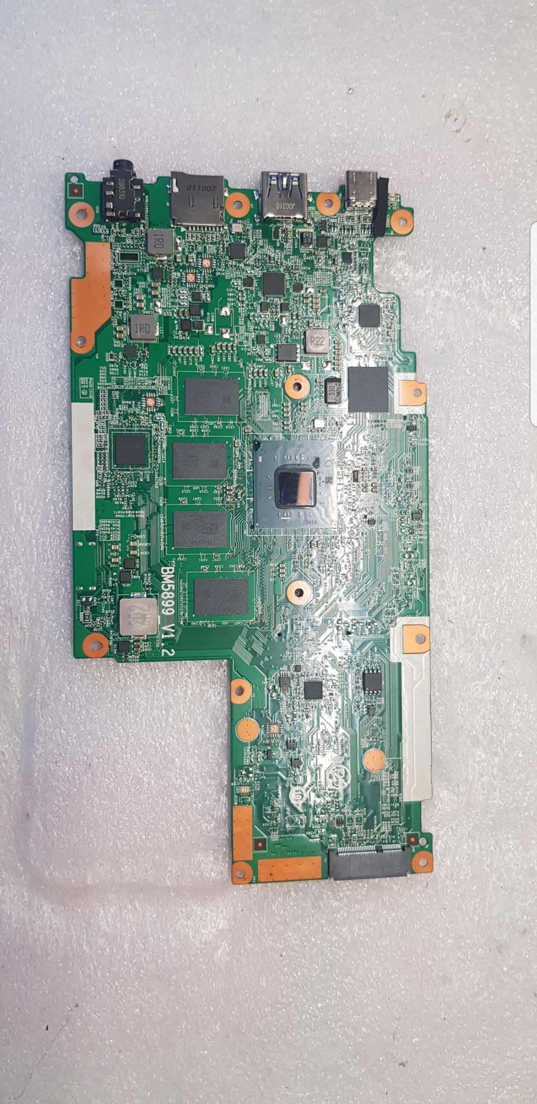

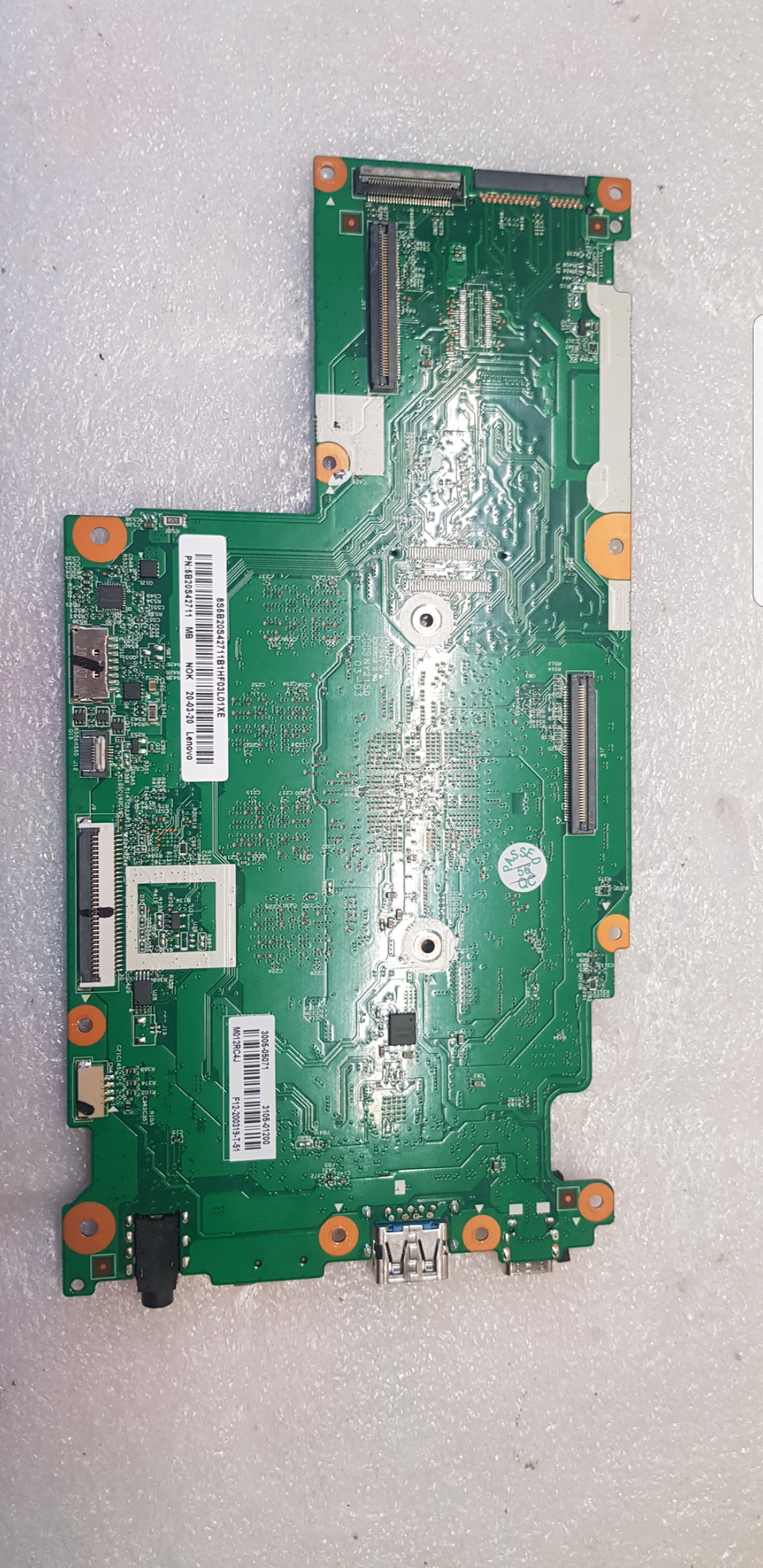

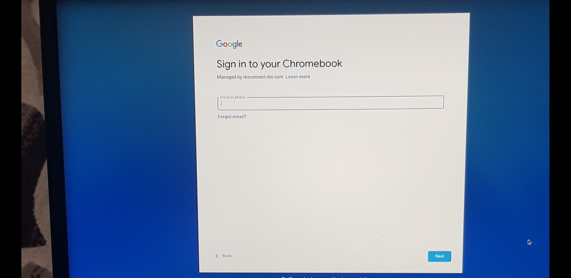

    hello.
    I have Lenobo Chromebook S340-14 model 81TB and is enrolment,managed by rbsconnect.
    i attache few pictures with my laptop and the original bios.
    http://ww*********mebook/
    please can somebody unlock my bios ?
    thank you in advance.
    kind regards
    Bogdan

        I can share you bios dump for this chromebook but i must read this first. My problem
        is that I want to flash bios from the mrchromebook.tech thread to install win 10. I'm search about screw wp on it but i couldn't find. Have you idea how to remove WP on this
        chromebook or where is this WP screw. On other hands, I'll try to read bios and will give you.

          write unlocked dump
          made a bootable usb with new chromeOS for this model
          pres ESC + REFRESH key and power button
          insert usb bootable with chrome os for your model
          after install complete, let it to power and load os
          now do power wash keys - crtl alt shift R
          AND PRESS ENTER

                  sir i already change devmode and enrollment mode to to 0 but not working
                  after programming i also update ctrl+shift+alt+r but still lock
                  • volinakis
                    • Jan 2021
                    • 2733
                    • N/A
                    Re: lenovo chorom book unlock
                    you have to REINSTALL using USB stick made for your model with Chromebook Recovery Utility after you write bios file provided by peste.
