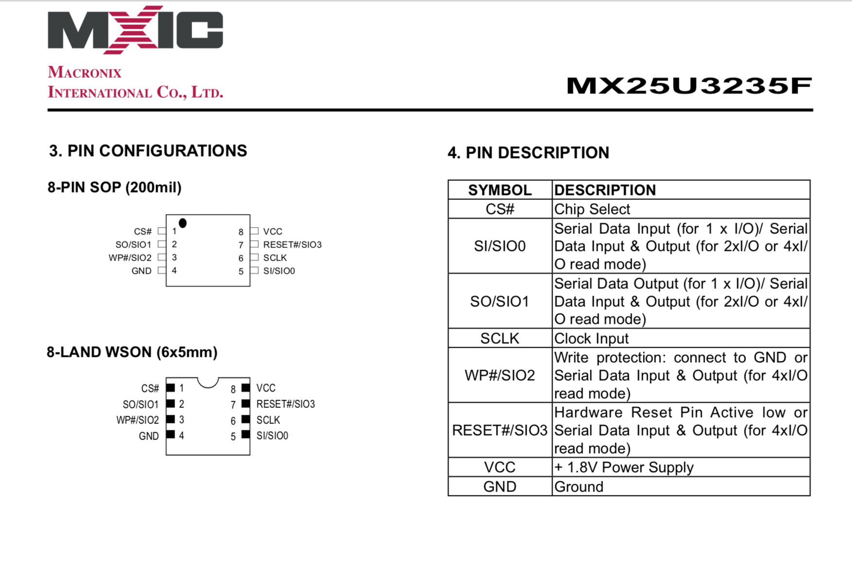

              Does anyone has the BIOS Dump for this Apple Macbook Air A1932... Logic board # 820-01521-A..Any help will be appreciated... Thanks in advance
              • piernov

                This has T2, no SPI ROM for BIOS.

                  Re: 820-01521-a REMOVE PASS PLZ
                  Thanks for the reply... So what is the programming part which mahmoodjavan sent right on the top. What is this RAR file about then??? Kindly inform me.
                    ROM for T2, part of its firmware.
                      Thank you very much... just for more knowlege & info for everyone & me., Can we ever program these Apple T2 chips???
                        T2 firmware can be reflashed by using DFU recovery mode from another MacBook.
                        The SoC ROM is a 1.8V SPI ROM (package is a bit exotic though) so it can also be flashed with a regular SPI ROM programmer.
