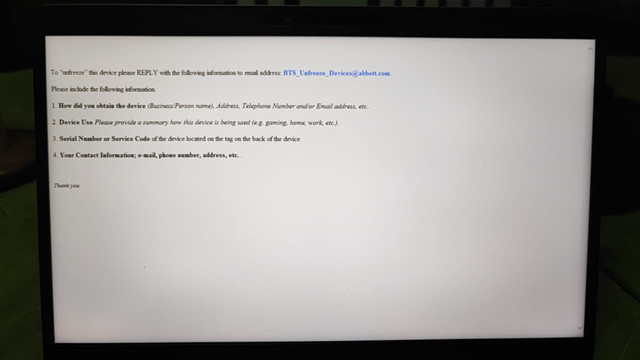

        Hello everyone! Please I need to unlock DELL Latitude 5410 BIOS, here is the dump! Thanks a lot!

          1st boot, press F2, write service tag, disable Absolute, save (Apply Changes), restart. 2nd boot press Alt+F to exit manufacturing mode.

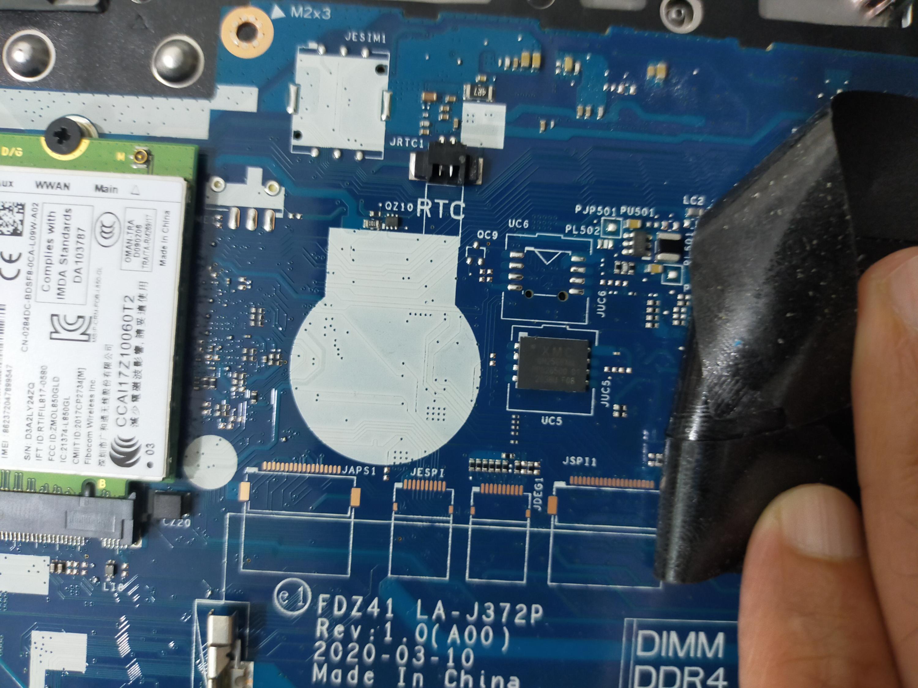

                              thank you for your replay iam in confuse wwitch chip i read for this laltitude 5410 i 5 10 generation service tag 1WTH4D3 bios version 1.4.3 the one dump i readed is corrupted this the photo of mother board
                              Premium supporters get full download access and other benefits.
                              • Vesko356
                                VIP Moderator
                                • Aug 2018
                                • 4387
                                • Bulgaria 🇧🇬
                                • Gadget & motorcycle addicted
                                #455
                                Re: Dell Latitude 5410 Bios Password 8FC8
                                Third picture - the chip with motherboard position name UC5 is your bios SPI flash memory IC.
