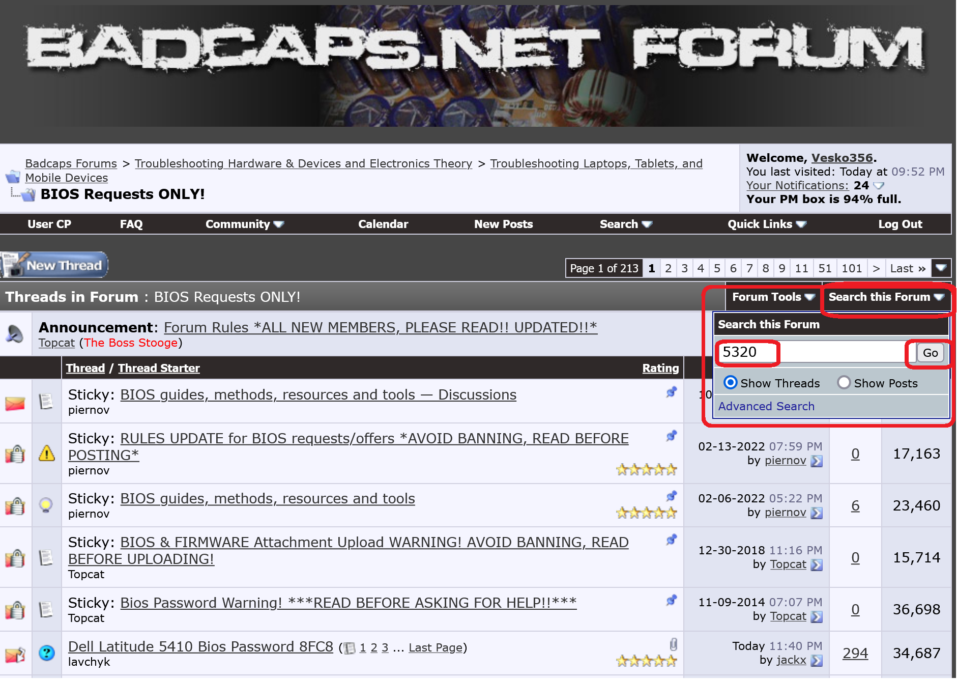

Use "Search this Forum", the search field is at the top right corner of the main page.
