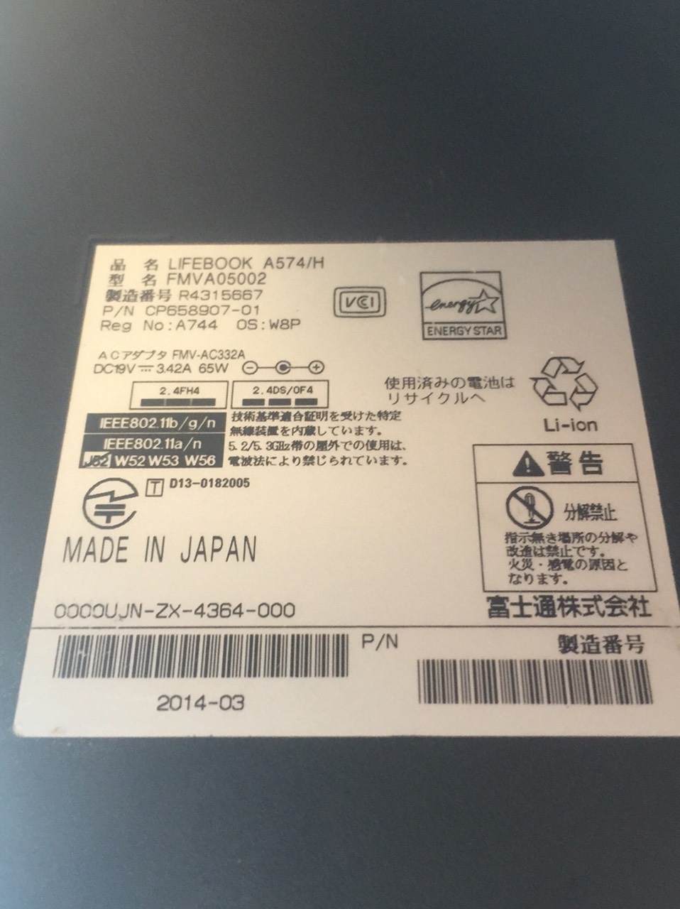

    Hallo, I am Fujitsu certified field service man for whole portfolio of Fujitsu products; server-desktop-laptop-storage-tablet. I am able to unlock locked BIOSes. If you need, feel free to ask. Use ****************** only since I am here sporadically.
    Cheers

    help me clear bios pass. thanks!!

      Hallo Black..,
      This works a different way. Send me PM, I will explain the procedure, its not that complicated, it just needs to be proceeded tightly an precisely step by step. First, solder the chips back onto the board and reassemble the laptop ;o) Then PM me.

        Assemble laptop, go to bios (F2), enter these 3 passwords "3hqgo3", "jqw534" and "0qww294e" in this exact order.
        Enter given code to this generator: https://www.badcaps.net/forum/showthread.php?t=79974
        Turn laptop off, turn it on, go to bios, enter the password generator gave, change password using that same password and save.

          thanks @RethoricalCheese, @GeorgettaCZ for your help!!!
          i got it
          now password is remove
          thank again!!!
