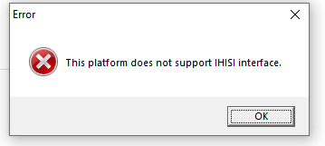

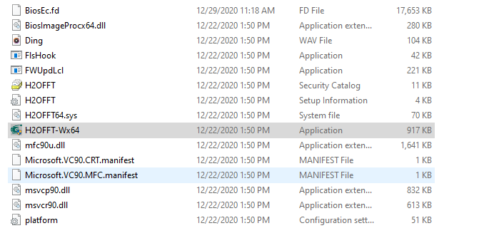

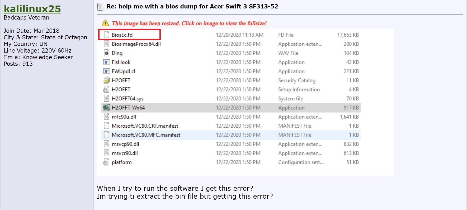

            Re: help me with a bios dump for Acer Swift 3 SF313-52
            When I try to run the software I get this error?
            Im trying ti extract the bin file but getting this error?
              It's here
                Originally posted by hoaca388
                It's here
                Thanks how can you split those file into bios and ec bin?

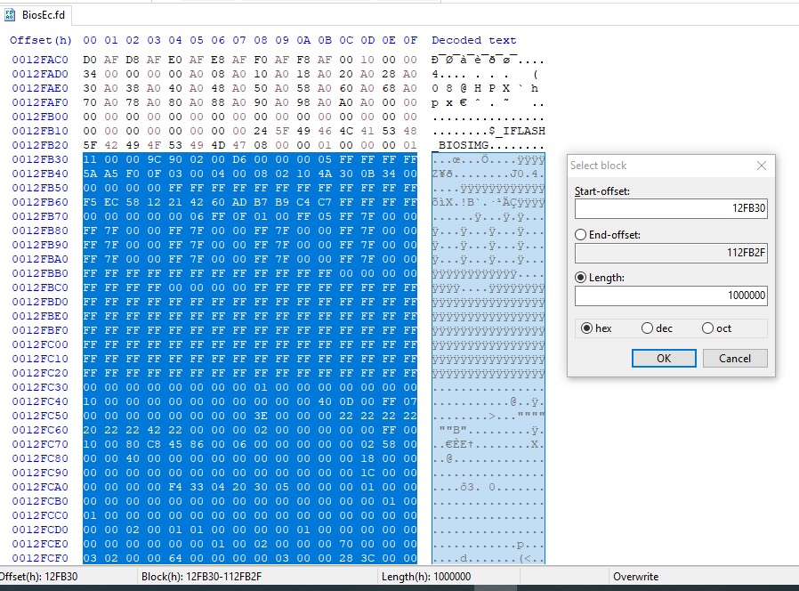

                    Originally posted by SMDFlea
                    With a hex editor
                    How do I cut form the top of the new bin to the last? do I need to know what is the excat offset? and hw do I know? I already found where is the first and the last of the new bios bin in the hexeditor. but I cant cut it if I do it manually

                        • 24365
                        Search for the word BIOSIMG, the bios starts on the line below so put your cursor there and that will set your first offset, select the block and set the length as 1000000 (1 million in hex is 16MB) .Copy and make a new file,paste into the new file and save. Then copy the DMI from your backup using the offsets 6CD000 - 6D803F and paste-insert into the virgin bios using the same offsets

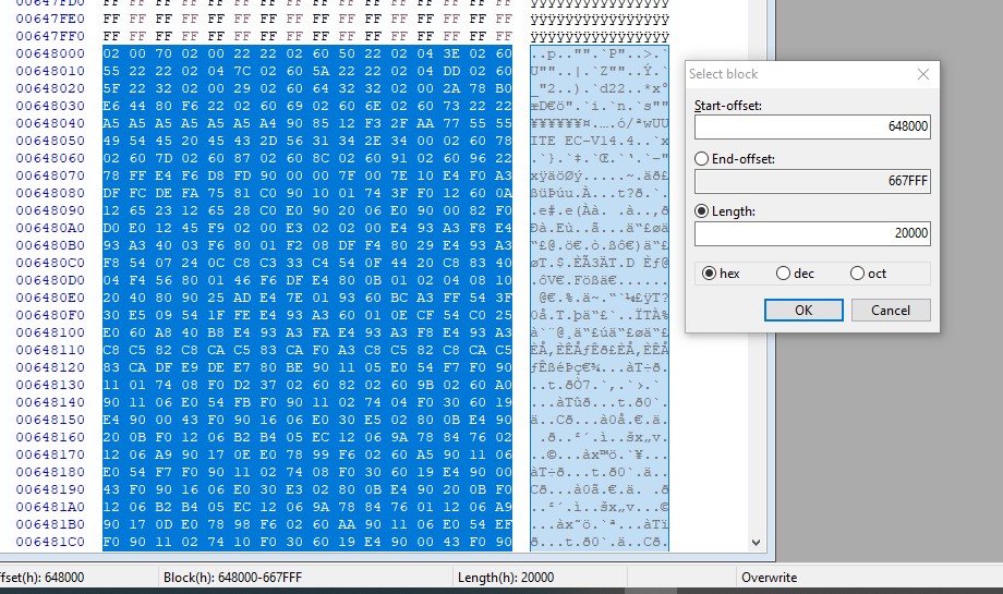

                          also the ec sir

                            • 24365
                            please check sir, im very haappy that im learning now
                            the bios is good
                            also the ec sir
                            no,its not good.The ec is copied from the bios to a new file (20,000 is 128KB)
                              the bios is good
                              how can you determine the starting and the end of ec? when I compare my backup ec they dont have the same starting and end text..
                                • 24365
                                Your EC backup you posted isn`t the EC, its frimware for the DP or USB-C ,or something . The EC chip is the ITExxxx .
                                  ahw, i thought it was the ec in the first place .. But how can I tell that the starting of the ec bin?
