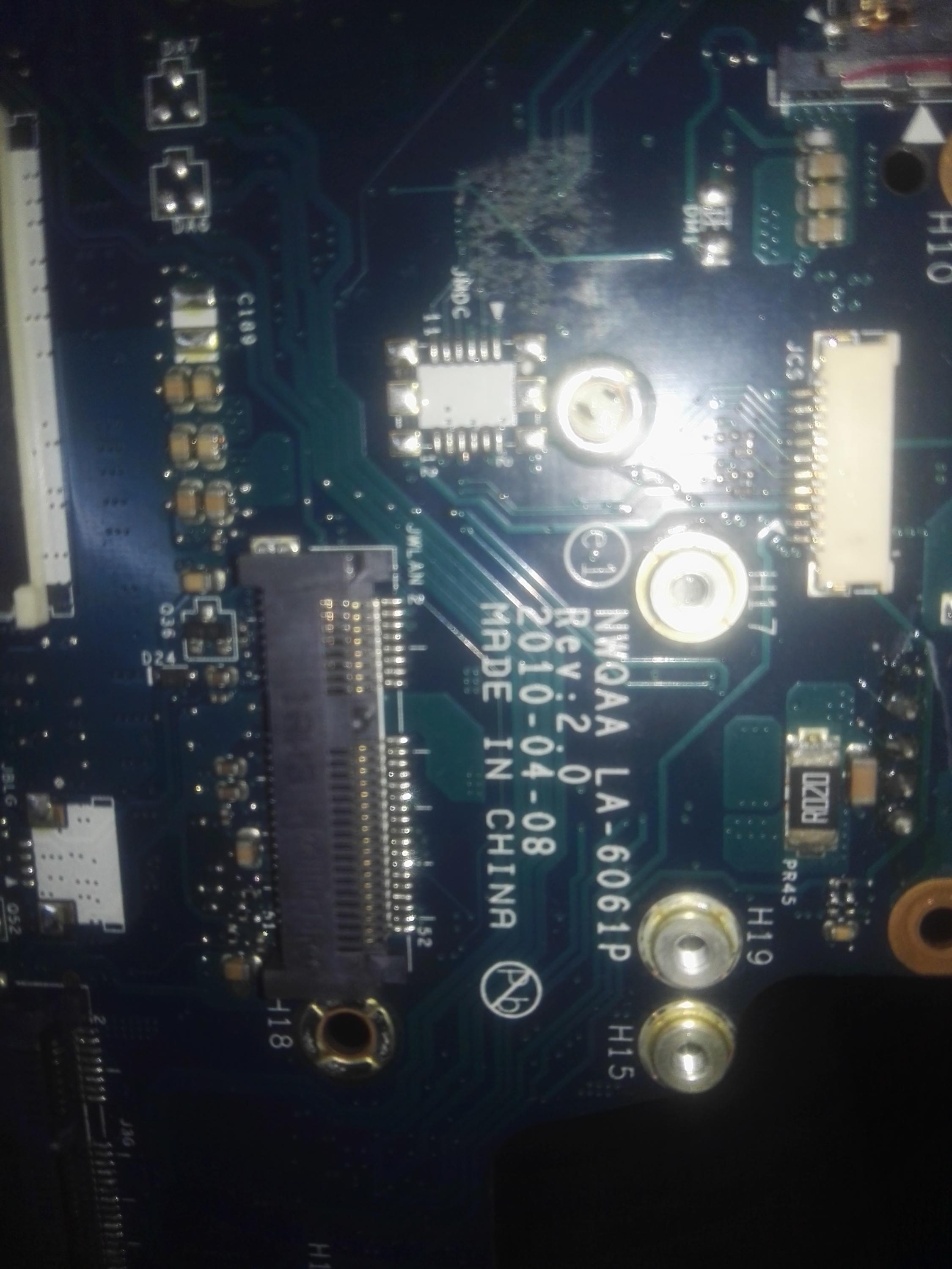

    Kindly help with Bios files for the attached motherboard.Thanks in advance.
    • 21177
    Re: Toshiba dynabook bios files
    What is the full laptop model number,and part number,serial. Post your bios backup .
      • 21177
      Post your bios backup, and full laptop model number.
