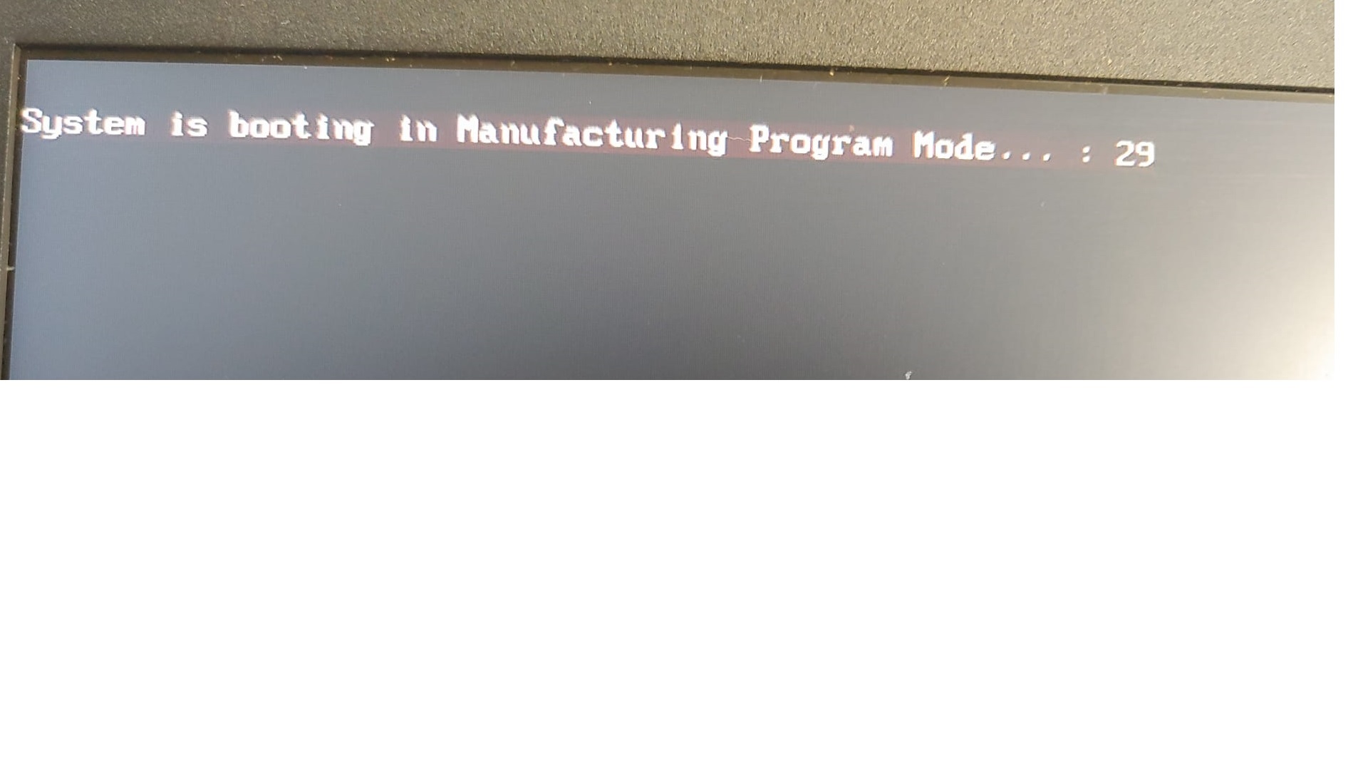

            Hp probook 430 g5 dump
            I HAVE HP probook 430 G5 motherboard DA0X8BMB6F0 rev f
            Machine came in with no video. Tried different BIOS-Dumps. now i have video but following on the screen "soft temporary disabled. To enable ME check AMT option in F10 setup. System is booting in manufacturing program mode". On second later the machine restarts, so i can't use DMI-Tool (F9/F10 doesnt work).
            I atached the original bios! can you Help me? Tnx in advantage

              Re: Hp probook 430 g5 dump
              Try..
              • cezar_tiprigan
                • Aug 2014
                • 8
                • Romania
                It`s worked! you are awesome! Tnx 1000 times!

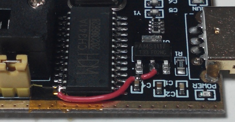

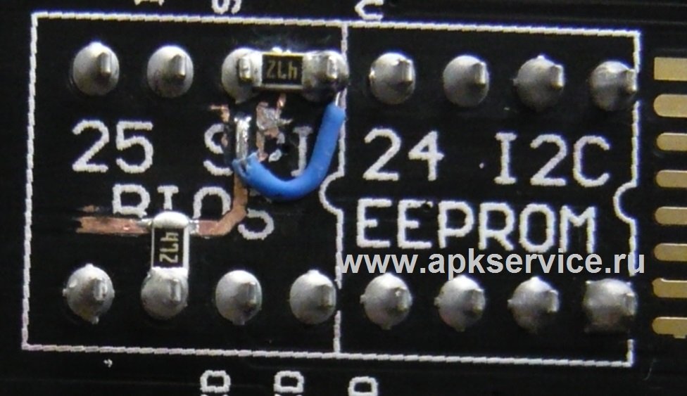

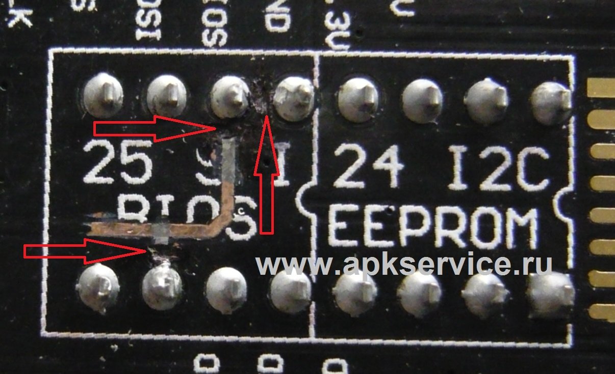

                      Have you read the chip name from the chip itself, or relied on the programmer to detect and tell you? Perhaps it is a W25Q128FW 1.8V?
                      Did you make several backups in the first instance and compare them prior to carrying out any modifications?
                      You'll need version 1.18 of the CH341 programmer(other versions are problematic with this chip), AS Programmer 1.41, or Colibri to program the chip if it is an FW. Also how you connect the chip makes a difference.
                      CH341 1.18
                      AS Programmer 1.41
                      Colibri 1.0.1.62
                      I also made two mods to my 'Black & Gold' cheap CH341 programmer, the first I'd advise if you have black & gold, the second is optional and came from the Colibri website.

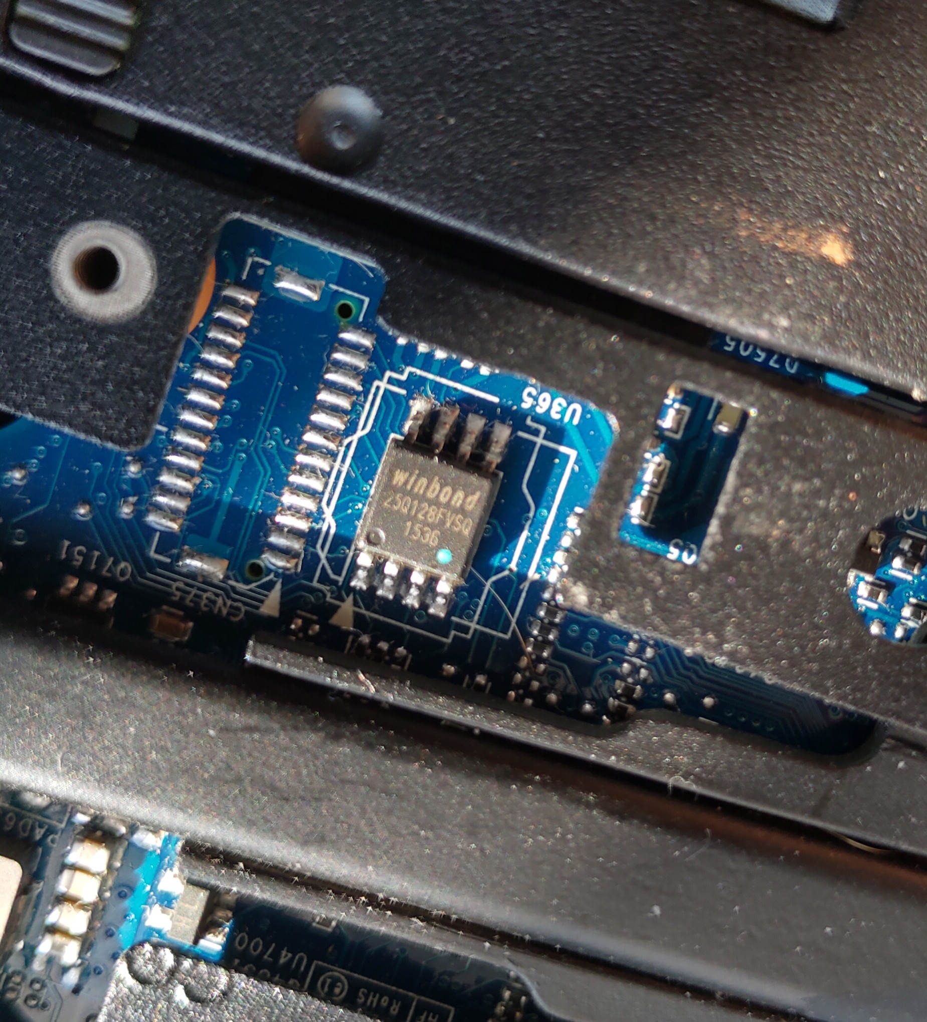

                        1. I have chip number directly from the chip (please look on the picture in the attachment)
                        2. I have 2 backups of the original BIOS, but after ERASE I am not able to restore them because of issue from previous post. The thing is that I am able to erase chip, but I cannot write backup BIOS or unlocked BIOS.
                        For now I am not able to start my HP 820 G2 Laptop because is black screen after erase a chip.
                        3. Problem with the version 1.18 is that there is no W25Q128FV on the list, there is only W25Q128BV
                        I have unlock procedure from this video - https://www.youtube.com/watch?v=bBMD3Pou8W0 but CH341H programmer connected directly to the chip on the board
                        motherboard - SNICKERS-6050A2635701-MB-A02
                        original BIOS in attachment

                          Agreed, use the BV. If that fails, try powering the LT on and off leaving the AC connected, then connect the clip and perform the flash/verify? Using the 'Detect' button is useful to get an indication that the clip is seated correctly if it returns the chip ID.
                          Also, have you checked the voltage at pin 28 of the CH341A chip with a DVM? Mine was using USB 5V, and would have been sending 5V data signals before the 1st mod mentioned in my earlier post.
