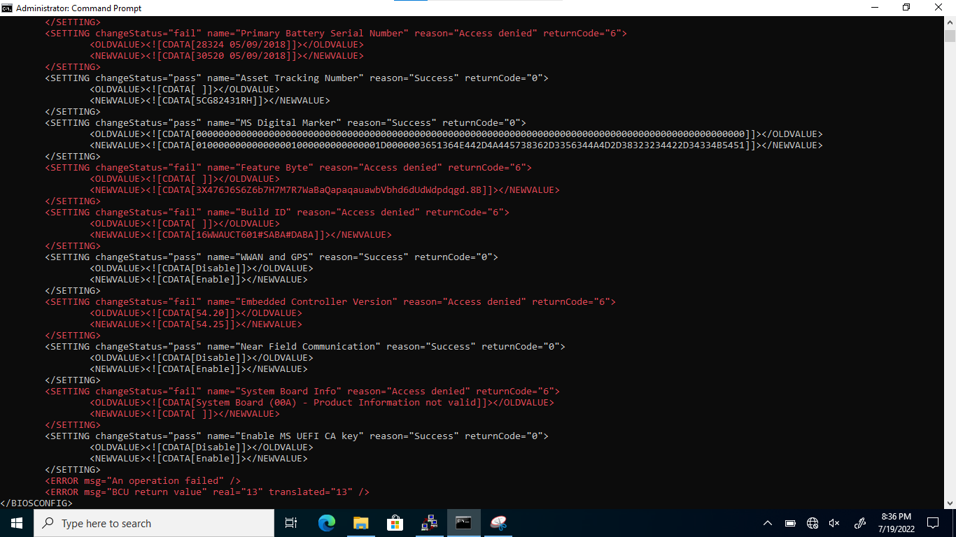

      I have flashed my HP ProBook x360 11 G1 EE with the clean bios and verified it is written correctly and device is now working.
      I still have MPM locked and cannot make any changes to fill in my DMI info using NbDmiFit or BiosConfigUtility, and UUID is all F's but with hyphens. When using the UefiMpmUnlock.efi it says HP MPM protocol is not present and using the FSMC.bin on a FAT32 drive renamed to SMC.bin is not giving any pop-up when holding windows+up arrow+down arrow.
      Am I doing something wrong? I could manually program in my DMI info if I knew exactly where to put each value in HxD.

          I have the clean TXE from SMDFlea flashed to my chip and I am getting "Access denied" returncode="6" on every value I'm trying to change as you can see in the attached screenshot

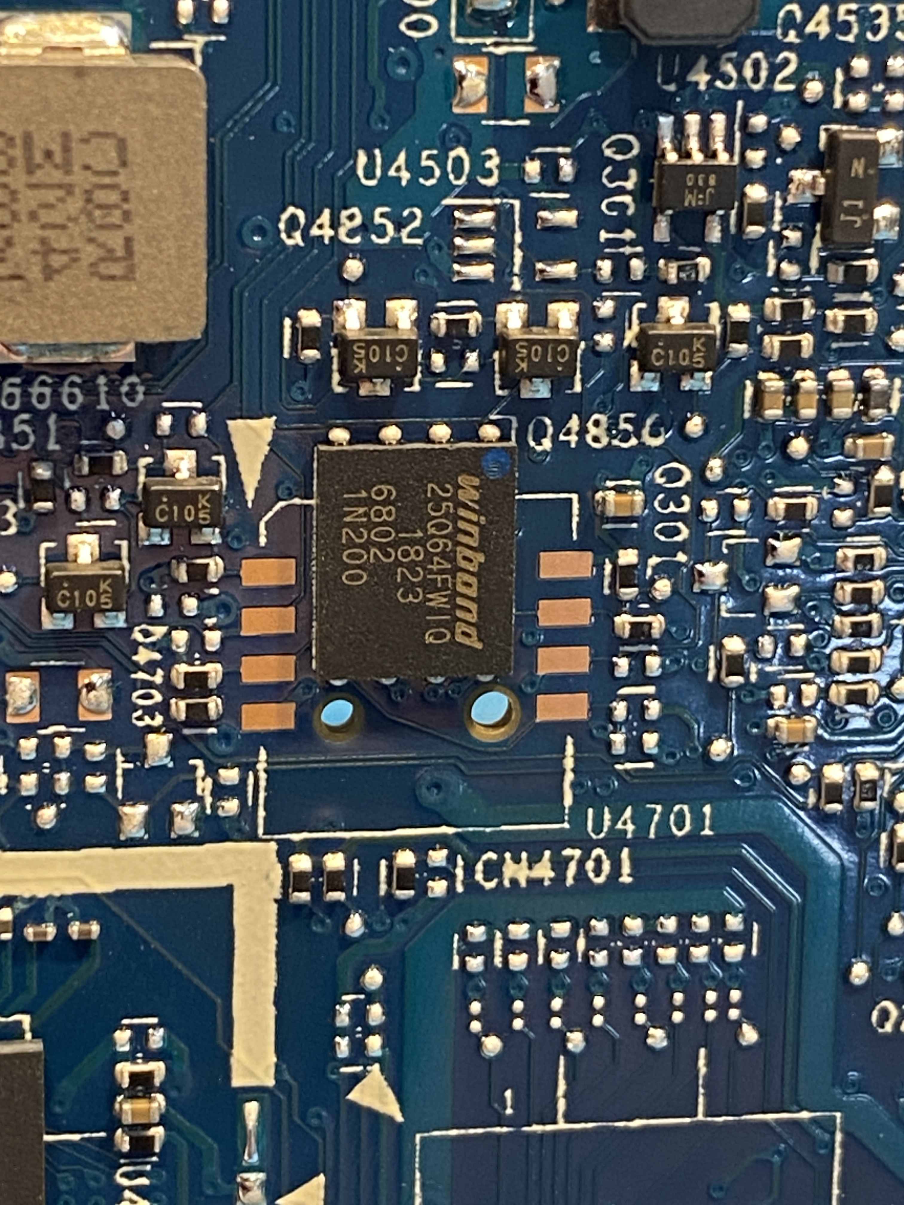

                  i have probook 11 x 360 g1 ee I have a password in BIOS, I tried to use RCunlocker does not recognize the image to unlock and HP unlocker - generates a file unlock but i have black screen when i turn on laptop. Bellow dump Bios.bin
                  please info how to successfully remove the password from the BIOS I have a few more computers like this.​

                  The bios posted does not have the password posted bios of 16MB...first write back the 8 MB bios and see if you still have an image..

                    I understand, bin file downloaded from the Winbond 25Q64FW as in the photo, after restoring the image the message as in the photo. Any suggestion?

                      look for a 16MB chip on the board ..see on both sides

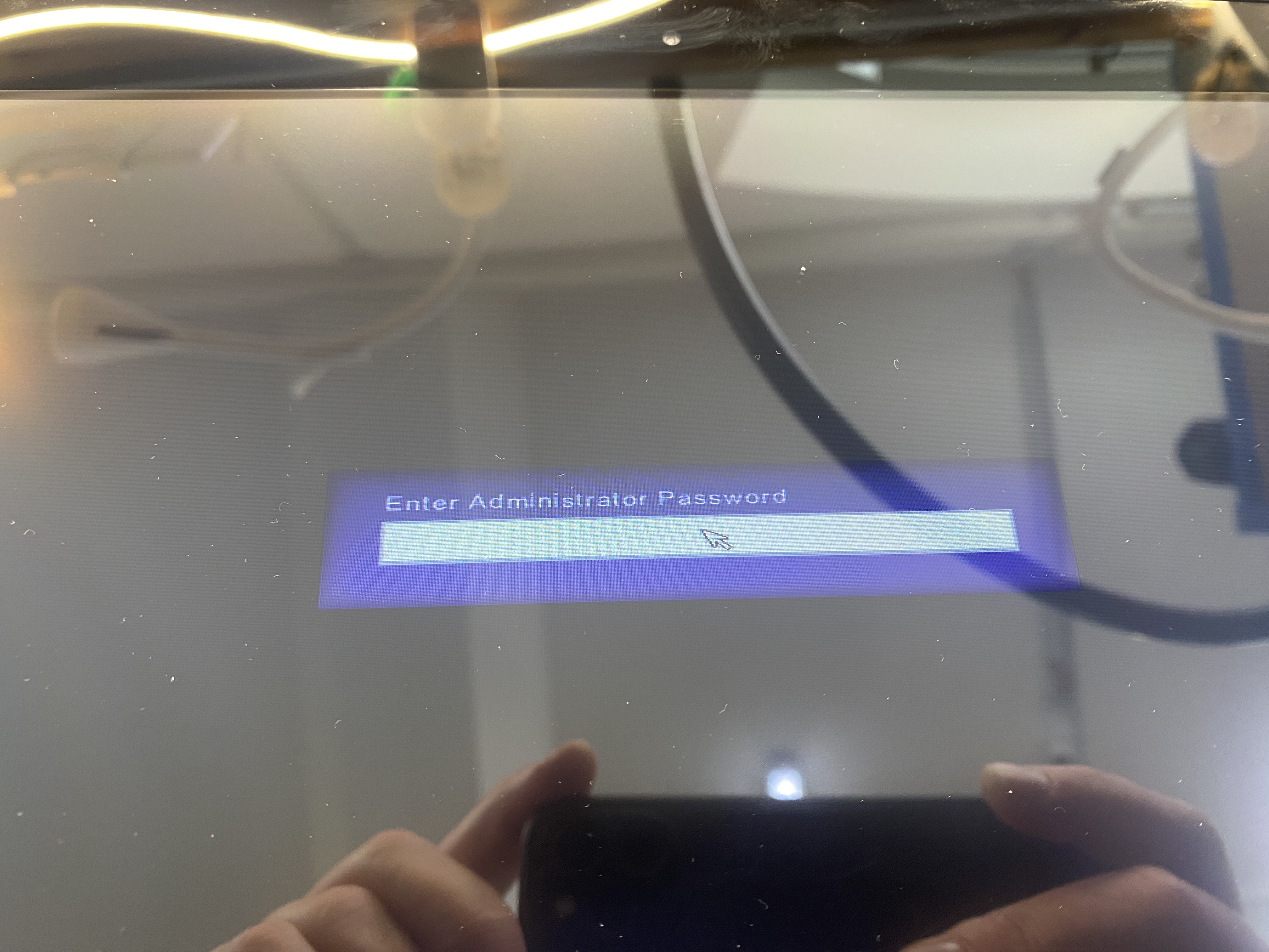

                                Please help, HP x360 SN:5cg7501751, BIOS password, if I write down my dam with a clean DXE, the password is deleted, but then I can’t edit the DMI, nothing works, maybe someone knows how to remove the password without clearing the DMI
