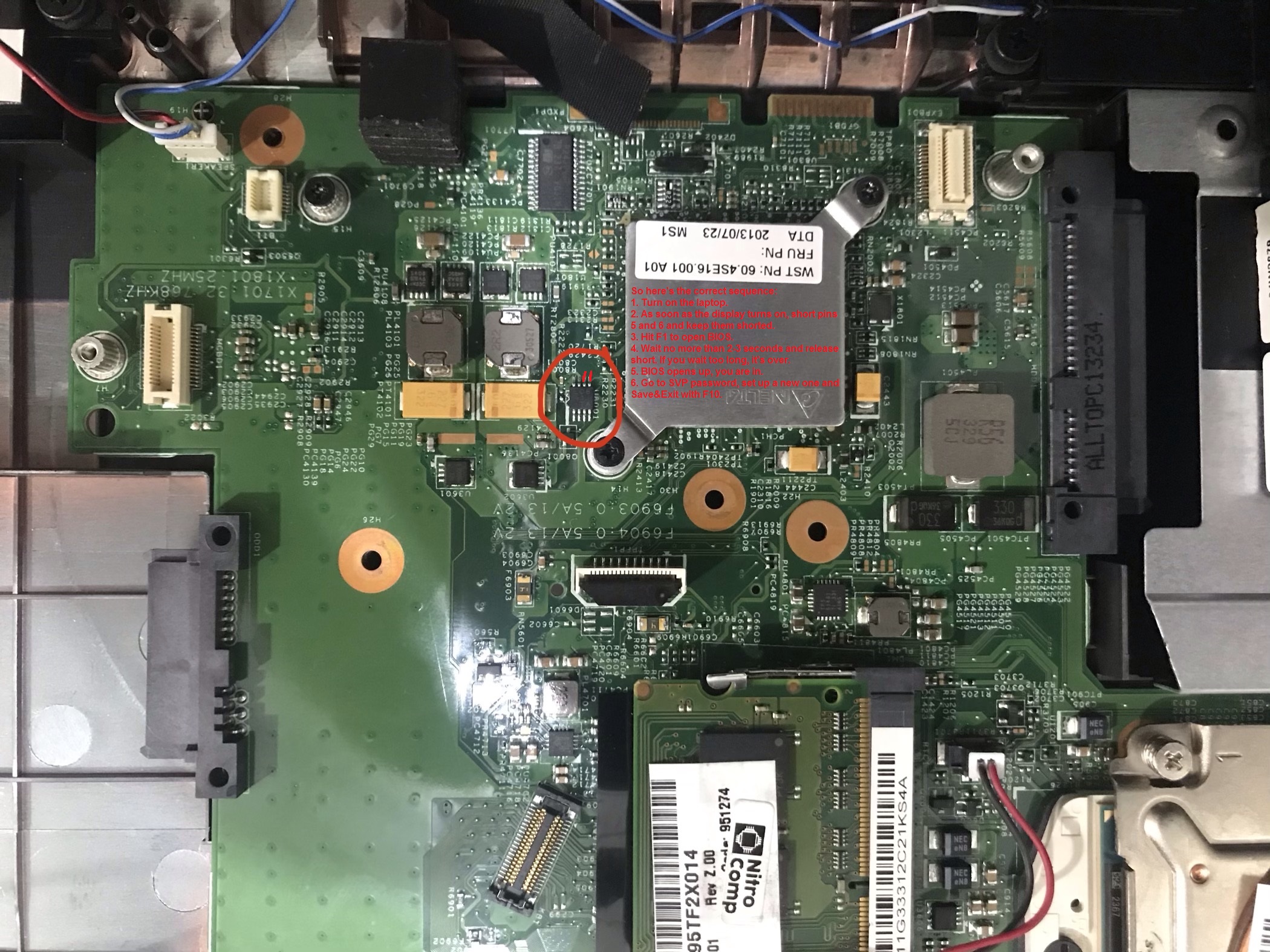

    Hello everyone and thanks again for this great forum.
    i have Lenovo ThinkPad L530 that have a bios Password i tried to flash a new bios but the password still there. any idea how to remove the password.
    This my dump

      Re: Lenovo ThinkPad L530 Bios Password
      still asking for password
        The password is stored in a small chip P24S08,L08 or similar. You can short 2 pins together to remove it -
        https://www.badcaps.net/forum/showth...ghlight=P24S08
        Theres a picture here showing the chip location - https://www.allservice.ro/forum/viewtopic.php?p=3521
          Thanks bro that was very helpfull.
          This is How i did it if someone esle needs it,
          the chip location is on the picture below
          1. Turn on the laptop.
          2. As soon as the display turns on, short pins 5 and 6 and keep them shorted.
          3. Hit F1 to open BIOS.
          4. Wait no more than 2-3 seconds and release short. If you wait too long, it's over.
          5. BIOS opens up, you are in.
          6. Go to SVP password, set up a new one and Save&Exit with F10.
