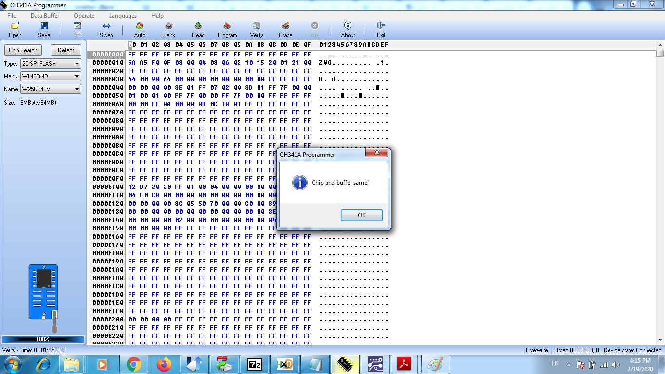

    820-3467-a clean me region need pls
    this is my dump bin, tnx
    edi:t lol i just destroyed my dump, my programmer didn't detect the right chip and actually didn't save nothing. :/
    how can i fix this now, can i use other dump bin from other 820-3476 and just insert my serial number?

    Re: 820-3476-a clean me region need pls
    the posted bios is not ok ... remove the chip from the motherboard before reading and post again.
      how can i fix this now, can i use other dump bin from other 820-3476 with my serial number?
      SN:C02NQVK5G3QH

          Re: 820-3467-a clean me region need pls
          i don't why my programmer cant auto detect chip. on schematics is marked like SST 25VF064C and on chip writes 25q64A which should be winbond. which should i choose sst or winbond?
            choose what is written on the chip
              • 20643
              Use AsProgrammer software instead. Select CH341A under the hardware tab, then choose the chip manually.
              https://www.badcaps.net/forum/showpo...6&postcount=10
              • biber
                • Feb 2015
                • 104
                • macedonia
                tnx guys it is winbond and dumb bin is ok!
