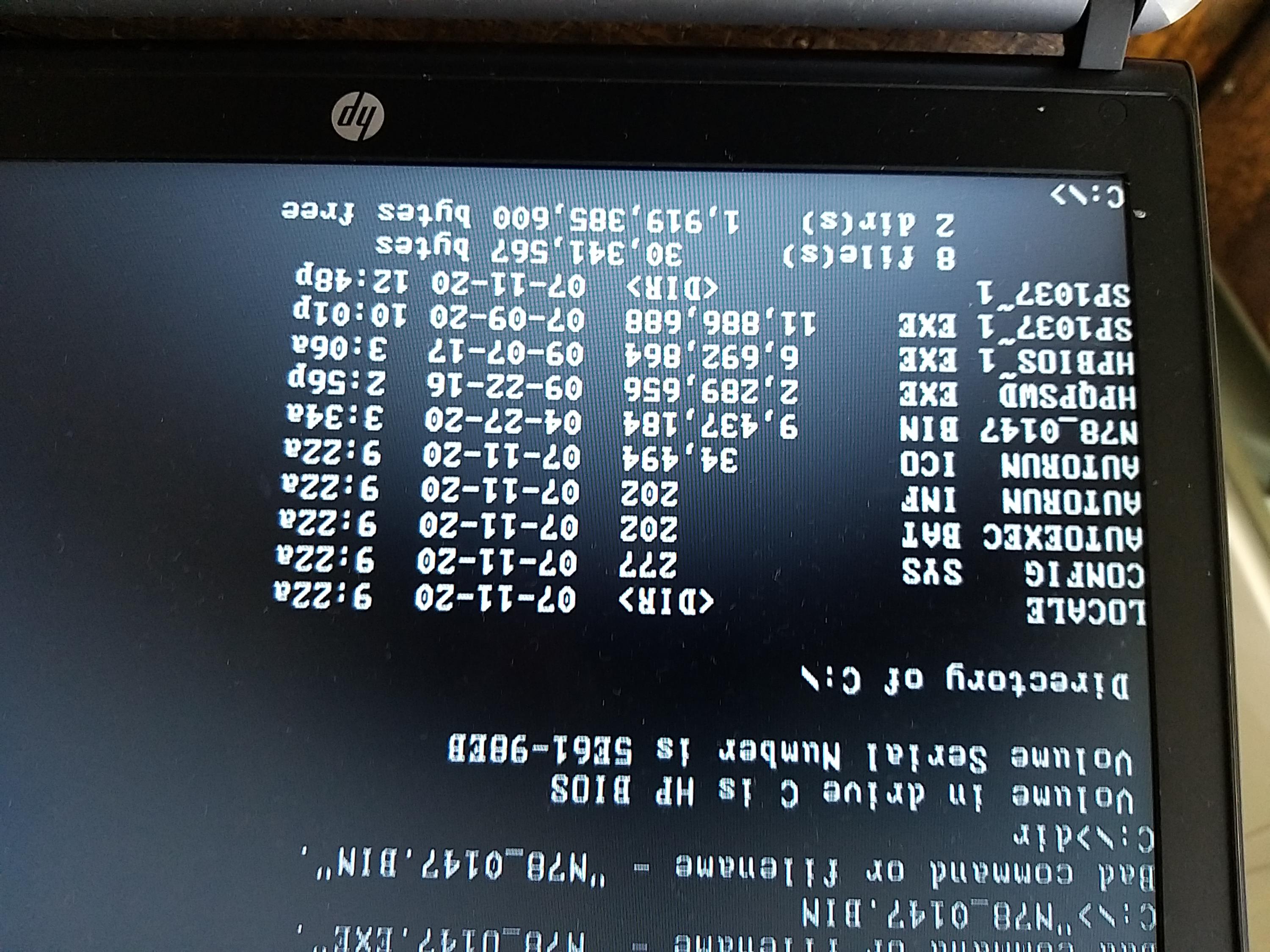

    Hi guys,
    I have been trying to create a bios recovery usb for this machine.
    However i am either getting no option to create the usb or getting a message telling me the bios is corrupted.
    Can anyone help.?

      Re: Hp 430 g3 probook
      Hi there again.
      thnx for replying.
      Now I managed to create recovery disk for this process but when win+B then power whilst holding the keys only the fan and lights come on..
      I made a bootable freedos usb and booted into that with the bios file.
      But what command do i need..Pls check this photo and tell me what I need to do.
      Someone put pw on bios now I need to reset.
        I get bad command or filename when I try to run the .bin file.
        New to this so some help would be great.
        I assume I am in the right directory.?
        I tried with and without quotes.
        Same error.

                • 20618
                Same error.
                Sorry for the vague first post lol..
                You can`t do it that way. Try the HP PC HARDWARE DIAGNOSTICS 4-IN-1 USB KEY instead.
                https://www8.hp.com/uk/en/campaigns/.../pc-diags.html
                http://ftp.hp.com/pub/softpaq/sp1040...0/sp104235.exe
                If that doesn`t work you`ll need an SPI bios programmer to backup your bios, then post it here and one of the members will try and fix it,or give you a working bios.
                  Ok smdflea,
                  I did buy a programmer,just wanted to be sure to try all other methods before disassembly.
                  Ill try this..thnx
                  Do I need to create a boot disk with this method?
                    • 20618
                    You will need to make a USB key,just read the README file and click on the makekey.bat ,it will make the key for you .
                      I tried it..All this does is diagnose the hardware etc ?
                      I didnt see any reference to the bios. Is that right?
