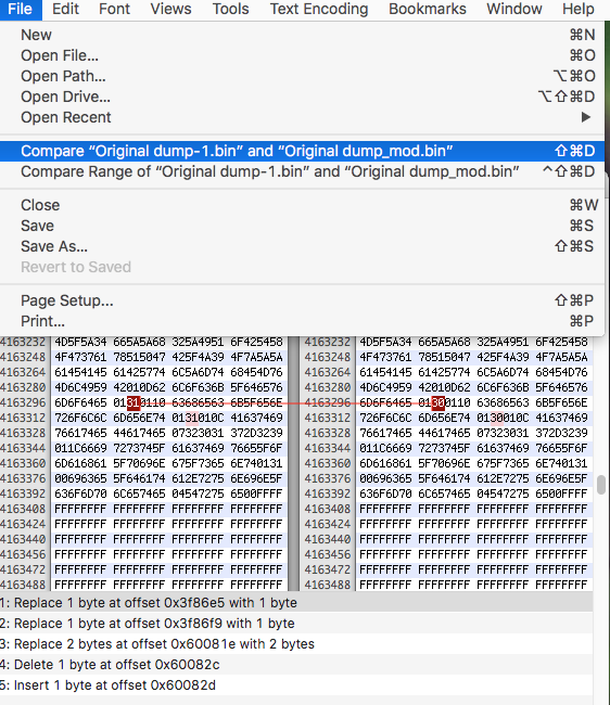

                        Originally posted by tfatt
                        Re: dell chromebook 11 3189 block Enterprise Enrollement user
                        Hi volinakis,
                        It is wotking and can you guide me on what to edit on the dump file (If i get other units dump files) as I still got other units to remove the enterprise enrolment?
                        Thanks.
                        Yes it can be disable through exd
                          Another question to anyone can help. Earlier I tried on RCUnlocker_v_1_0.
                          1. Drag the dump bin file to RCUnlocker.
                          2. It will auto generate a unlock bin file. I flashed that bin file to W25Q64FW chipset but the device is unbootable.
                          May I know RCUnlocker still workable to unlock developer mode?
                          Open file HxD .. in search type enrol... There change the digit 1 to 0 and 1 line above change the digit of develop from 1 to 0... And then save new file.. now flash the new file... In device turn of the os verification
