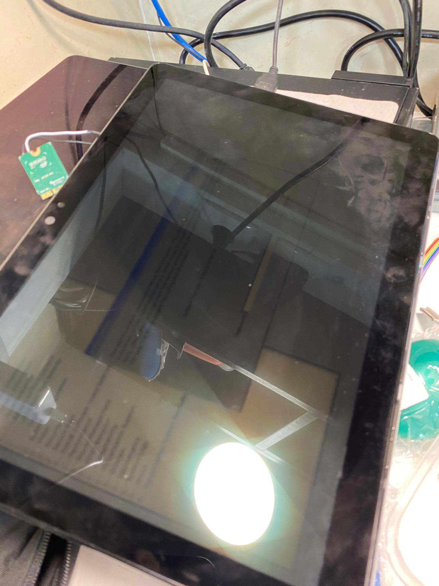

    Sorry for my first post is to ask need some one to clean or share a bios backup
    Mine have Admin lock and computrace

    Forget to mention this unit got new 8FC8 Suffix

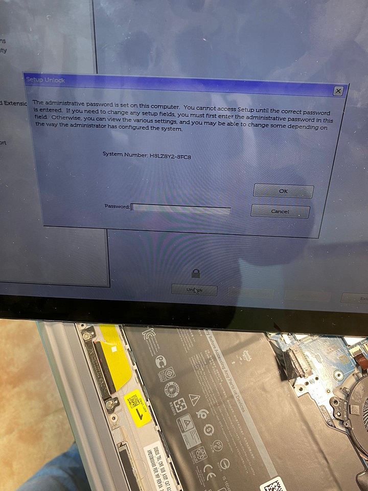

      Try this file i learn something.If give display show lock photo.

        Re: Dell latitude E7200 2-1 Admistrator Password
        tested still locked for some unknown reason backlight fuse its gone

          Strange! i unlock dell 5400,5500,7400.5300 model.But this model trick is different i think.

              Password store in Kbc not bios.If inside bios i sure then last file remove your password.

                for the moment i dont have tools to read kbc, but for now i was able to format pc with your modification =)

                  I think Computrace in disable.Can you verify in bios enable or disable?

                    its enable =( wil try to read MEC5106 and post here

                            dont work got stuck on dell logo and shutdown
